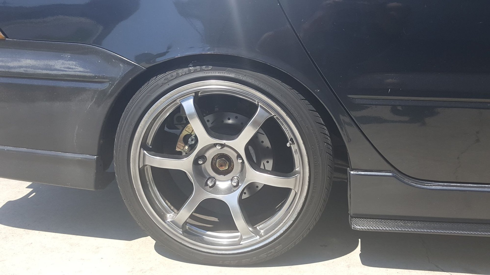

My car
My rear disks

Sounds like a pain finding all those parts. All the outlanders at the junkyards seem to have drums. I saw many awd airtrek trailing arms with disc brakes on ebay but they were from germany.

Originally Posted by MarkOJ1011
My car
My rear disks
Nice JDM ralliart front conversion
Surprisingly it wasn't hard to find the backing plates. Those were the hardest to source.
As for the calipers and disks, R1concepts.com stocks remanufactured calipers and disks for the Outlander.
