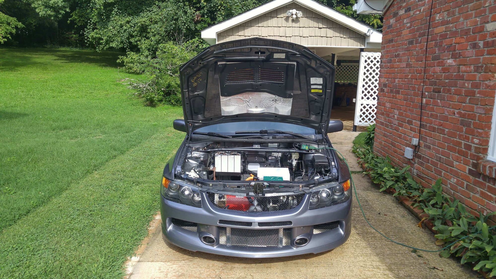

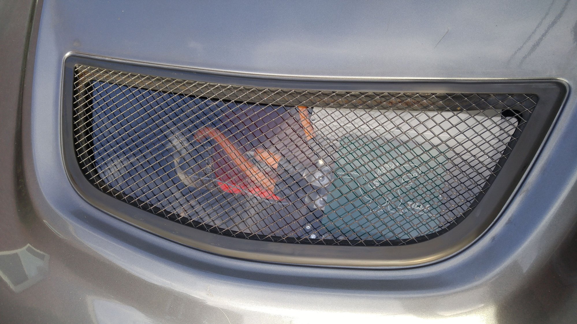

150 Mile Update
I've done a few things over the last 100 miles. Gear box and T-case oil change. Readjusted the rear suspension. Replaced the hood vent fins with a plexi glass rain guard.
Bumped power up to 50% around the 100 mile mark and the torque increase was very noticable. Bumped it up to 55% this past weekend and sensed that even a 5% increase was perceptible. I will be ordering the parts for J1772 charge capability this weekend.
