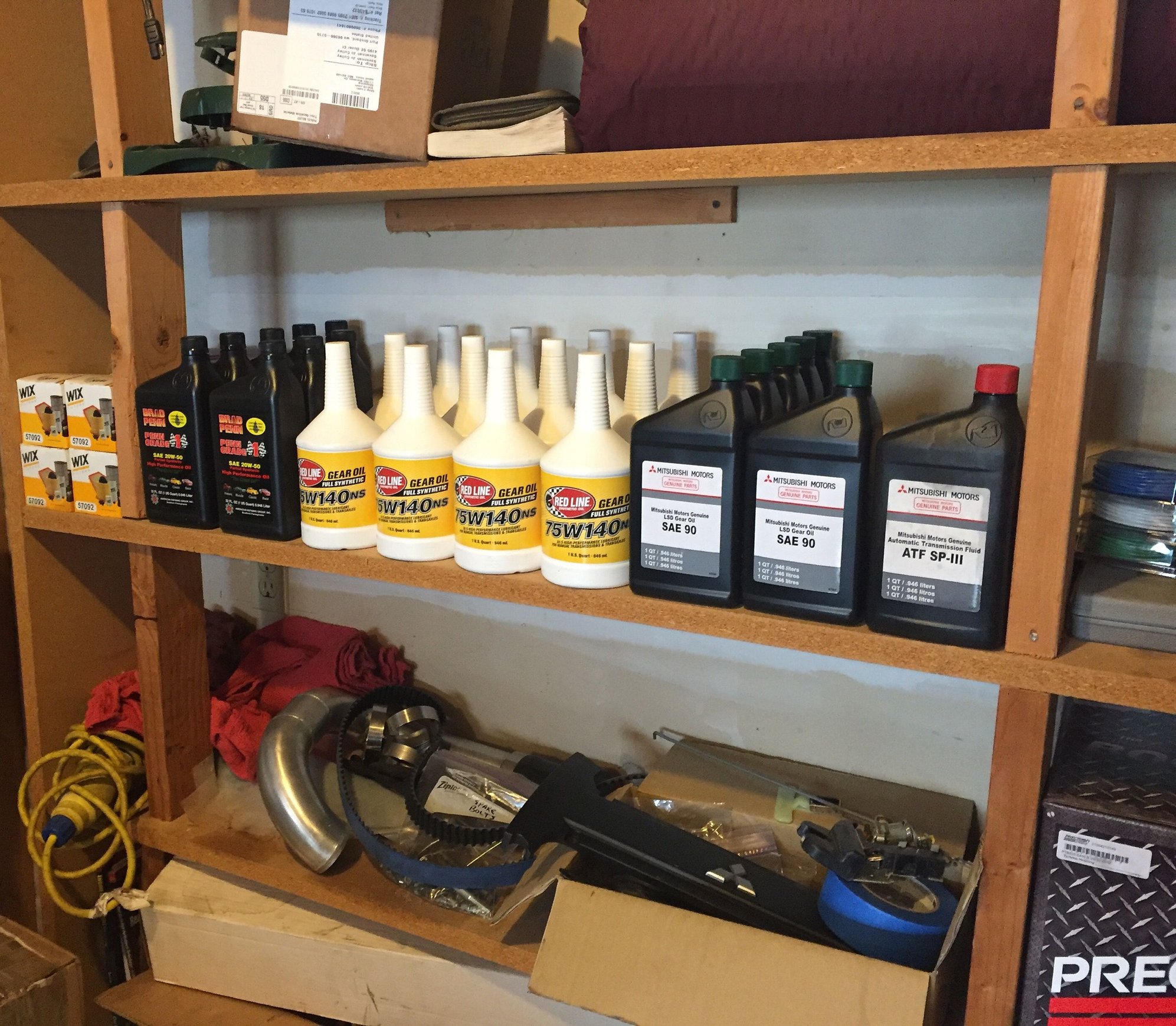

Also picked up a gm flex fuel sensor and plenty of drivetrain fluids for break in recently. If all goes well I should be putting everything together next month!
With all this fluid and parts sitting around I feel like I should be running a small auto shop out of my garage haha.

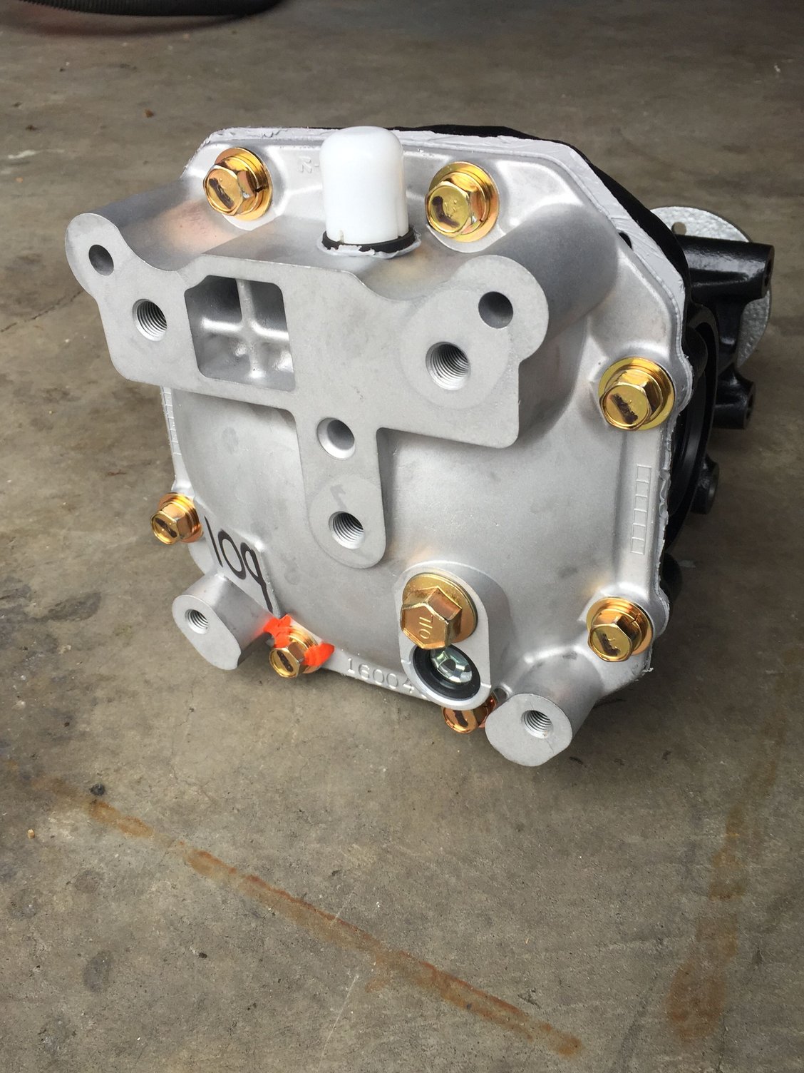

This past week has been a good one. Ordered a Competition twin disc clutch and DEI turbo blanket from good old Nick at Buschur Racing. I also emailed and talked to Jon yesterday about the drivetrain. We got the tcase and rear end all paid for since he has those two almost finished up. They should be on their way back to me on Tuesday.
The rear diff had no problems and he did his full range of upgrades to it so I shouldn't have to worry about it again. The transfer case had no issues but like most others out their it still had a ****ty contact pattern on the ring and pinion. We replaced that with an updated oem set(better contact pattern) and also the acd assembly because it had some wear. The acd assembly sounds pricey but he got me a really good deal on one he had sitting around out of a super low mileage car that had been in an accident.

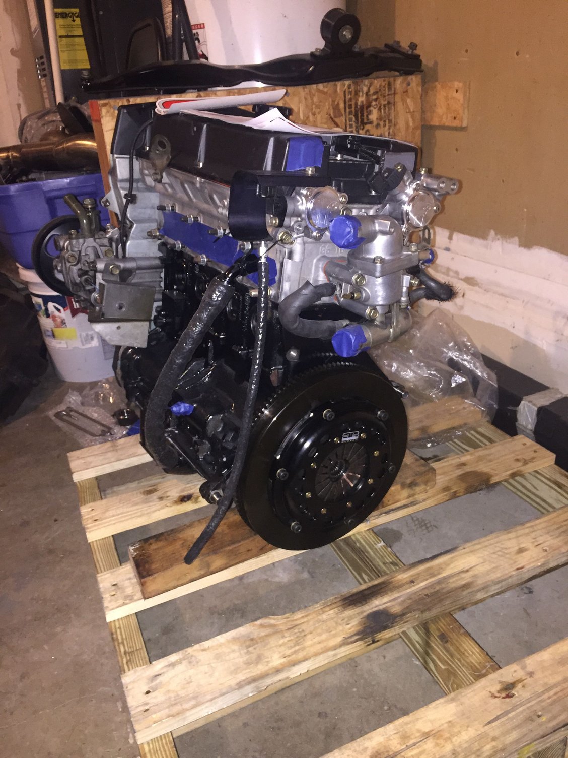

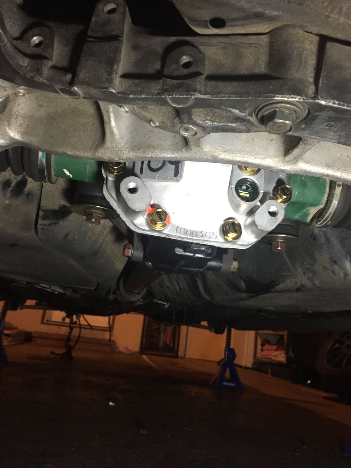

Late Night

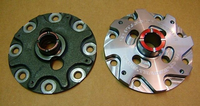

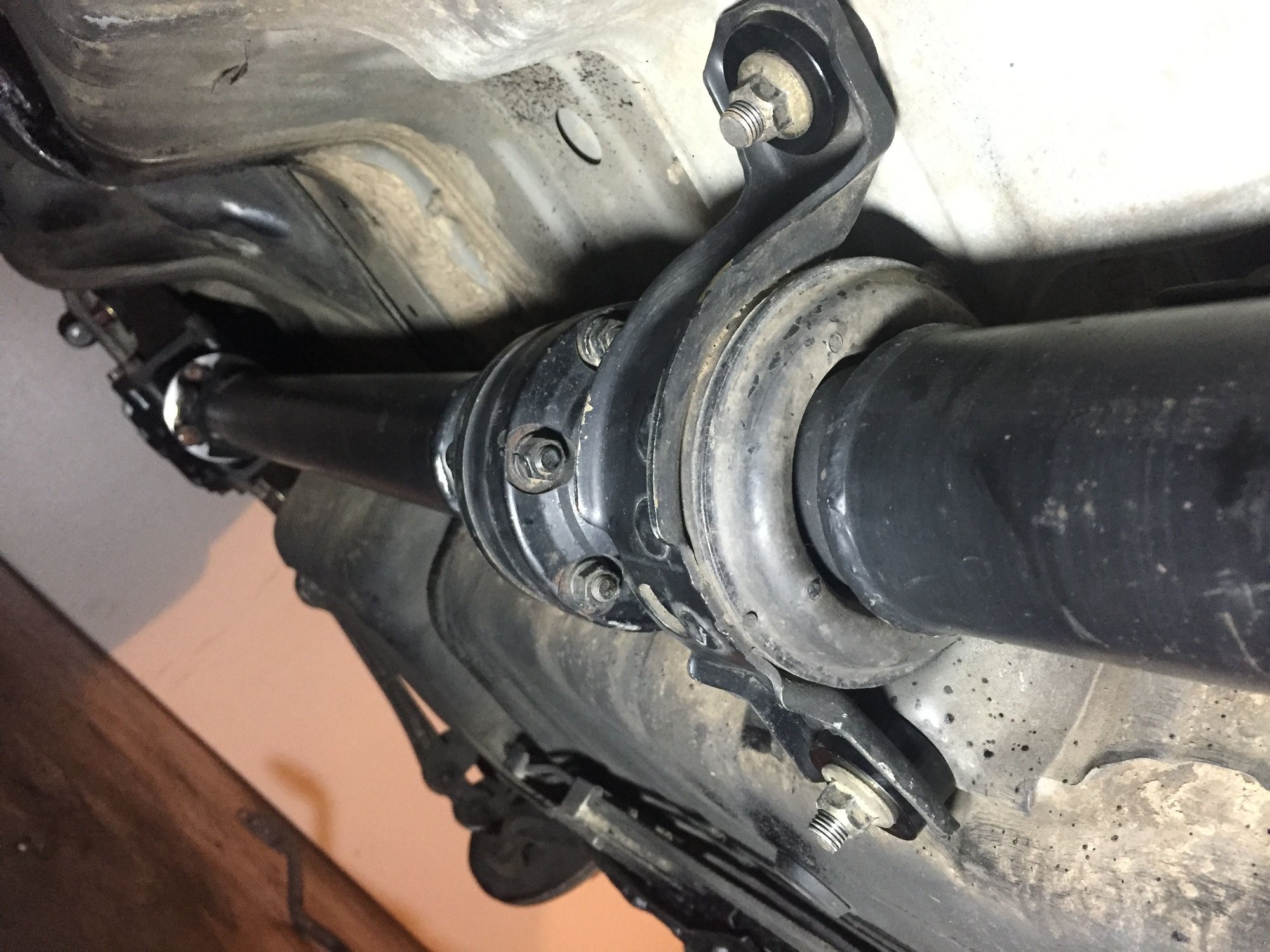

Rear Diff came in today. I had a buddy over to help install it and the driveshaft. Can already tell a big difference with the stiffer rear diff and mustache bar bushings. It is hard as hell to move that thing around. Started with the mustache bar bolts and then moved up to the carrier bushings. It seems counter intuitive with the mustache bar bolts being so snug in there, but the carrier bolts are actually harder to get lined up right and are a finer thread.
Using the sight glass and a screw on bottle pump we filled the diff in about a minute. I'll have to top it off after I can move the car around a bit of course.
Got the competition twin put on today as well. Having the engine out of the car makes it a breeze.
HD side cover vs oem. Bearing post is much thicker to support heavy thrust loads when launching. Outer oil scoops help throw oil on the pinion bearing and additional holes in the middle help add more oil/cooling to the friction discs.

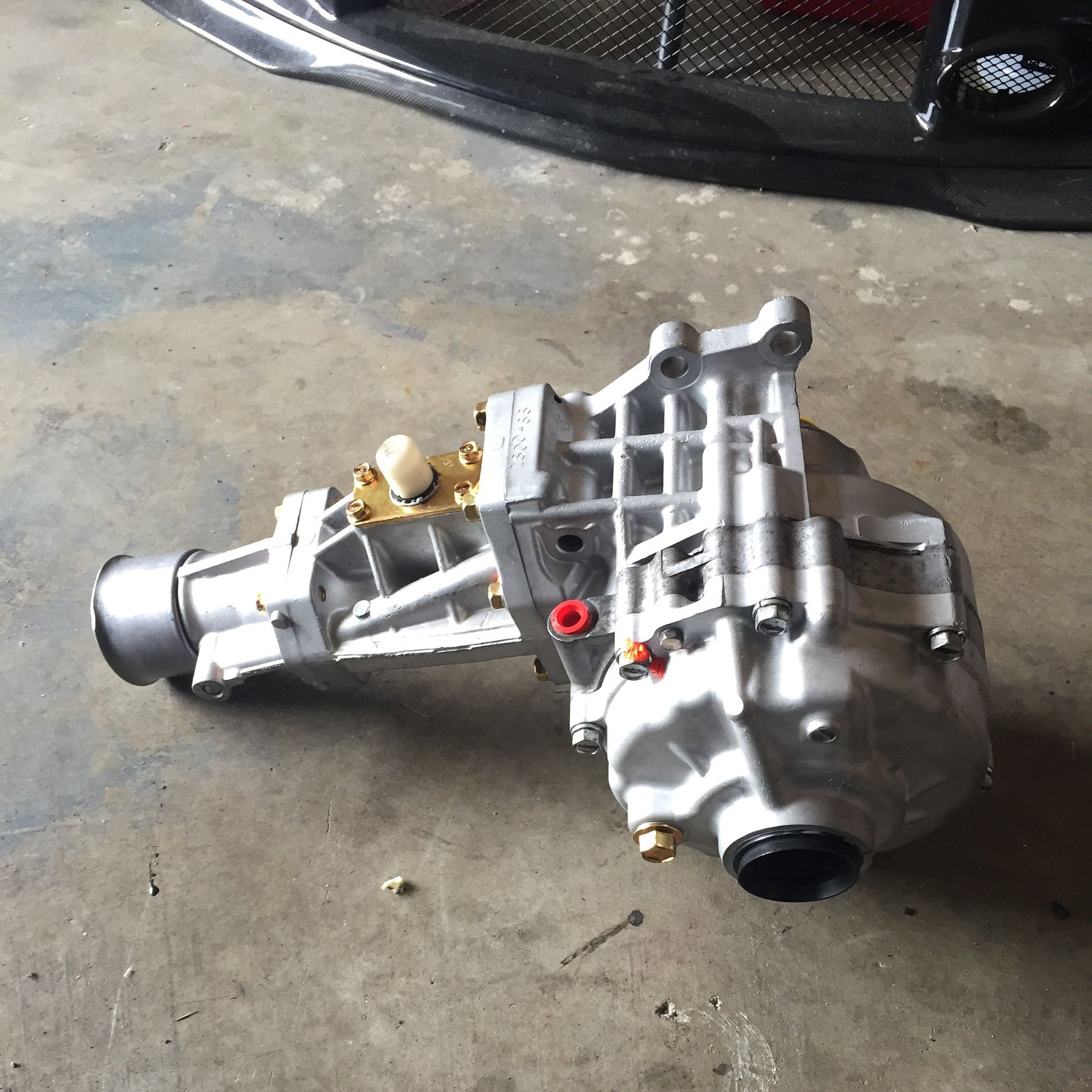

Tcase is here!

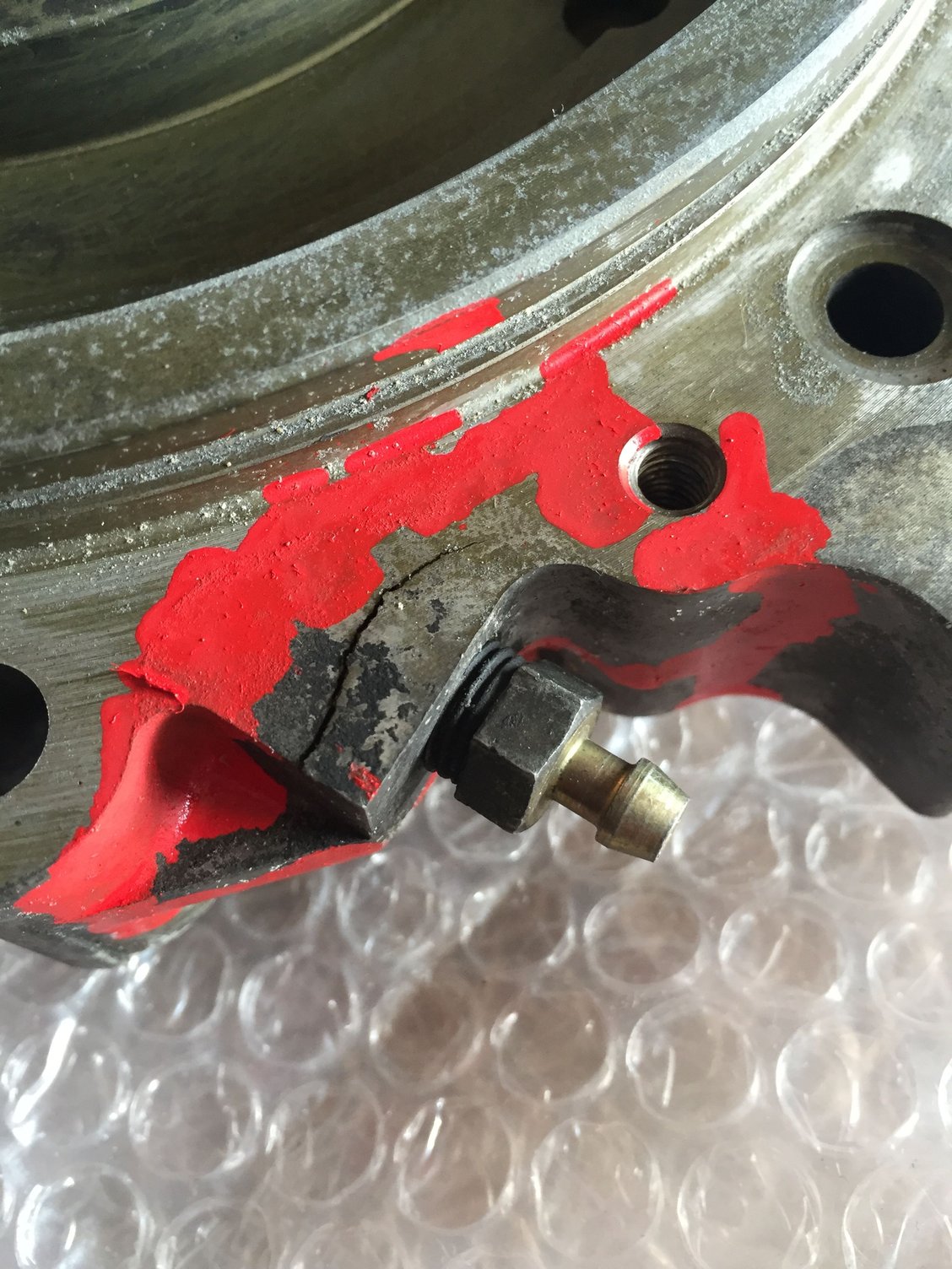

Transfer case got here yesterday with some effort on my end. The box looked a little damp on one corner so I had to go get it. It was dumb, but they have to follow their rules. Must have just been some oil from when I initially shipped it finally making its way to the exterior. Anywho, the thing looks as good as you would imagine. They just glass bead blast the case, do the usual m10 bolt upgrade, and replace basically every bolt in the damn thing! Details are with the pics below.

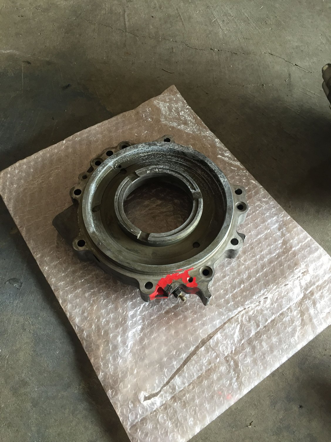

TRANSFER CASE<br/>-New (updated) oem ring and pinion to start with a fresh contact surface <br/>-CNC machined case to square up the ring and pinion (fixes initial contact pattern issue these cars had from factory)<br/>-Low mileage ACD Assembly<br/>This includes clutch pack, end case, and middle ACD casing (mine was messed up as you will see in the two pictures below)<br/>-Shot peened ring and pinion<br/>-Isotropic super finishing of ring and pinion
Old ACD Housing.
By some miracle it didn't leak, from what I could see. Luckily Jon has so many parts sitting around that he sells them pretty cheap. I got a smoking deal on the whole ACD assembly!

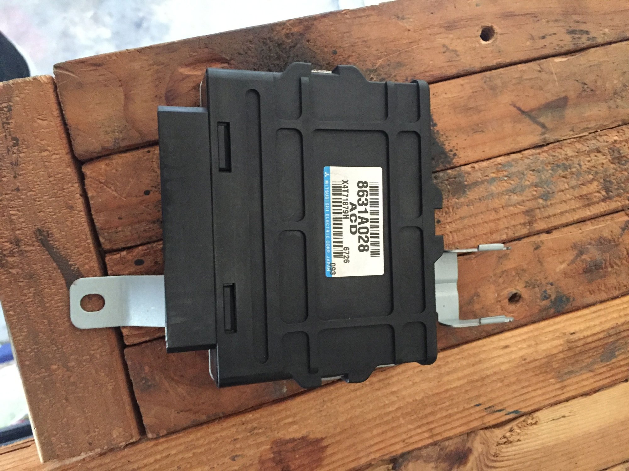

ACD Tune
Sending off the ACD ecu to English Racing today. Getting everything organized and all the little odds and ends ready. Here is what an acd tune will do...
"It changes the ramp rate for pressure to the clutches and cures the persistent understeer common in the ACD cars. In auto X this makes it want to be neutral to slight oversteer on a prepped car to throttle controlled oversteer with some power behind it. A drag car will lock the ACD faster and have less chance for a front axle to rear axle speed mismatch when it engages which normally is what breaks the case drag racing."
-JohnBradley
