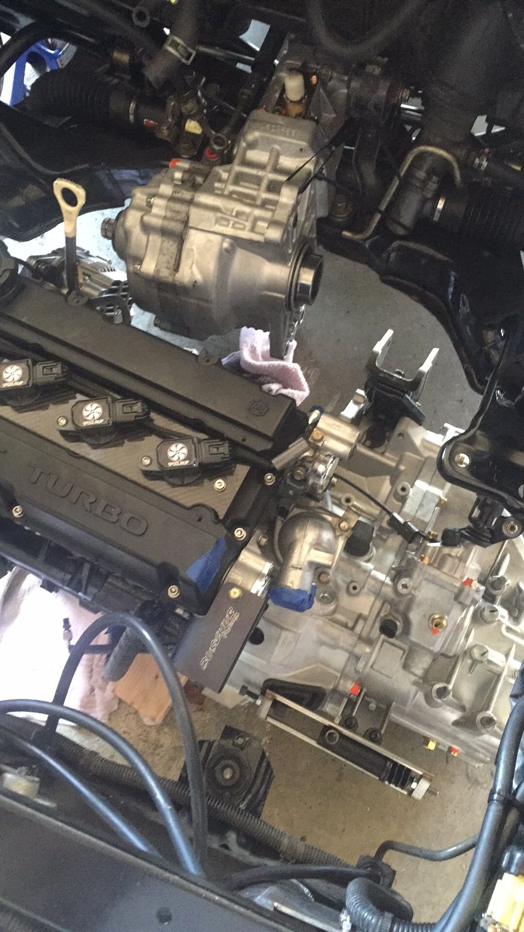

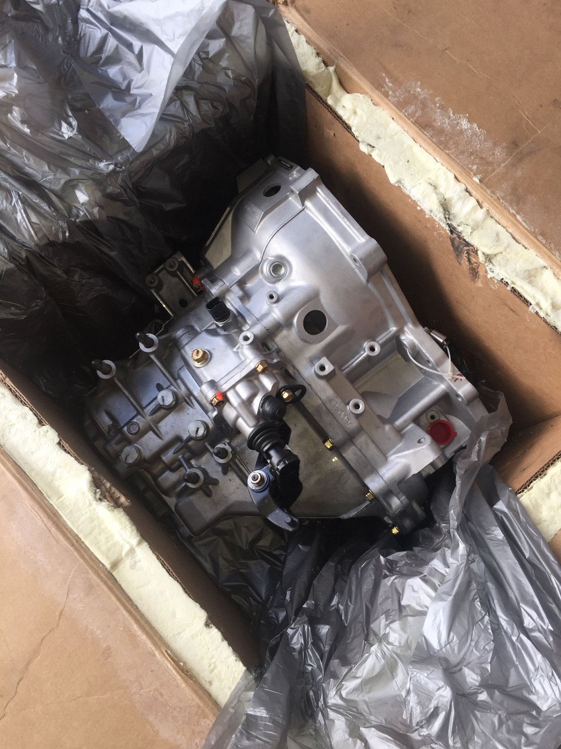

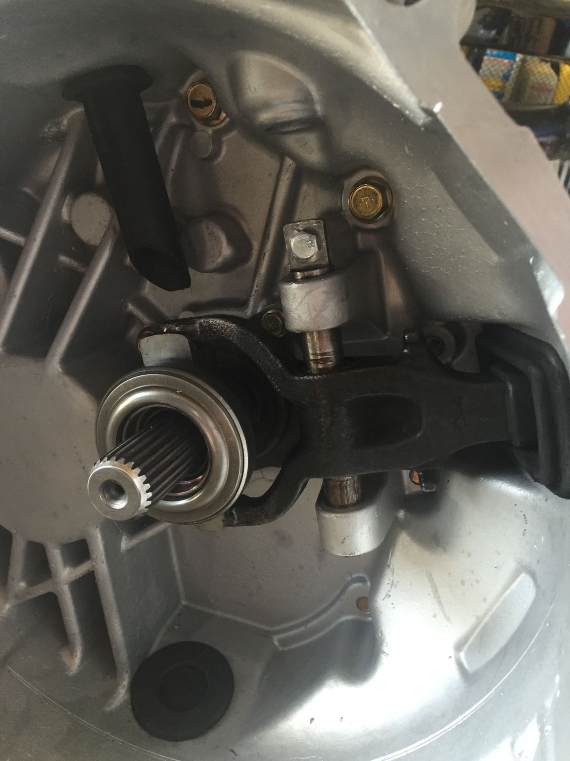

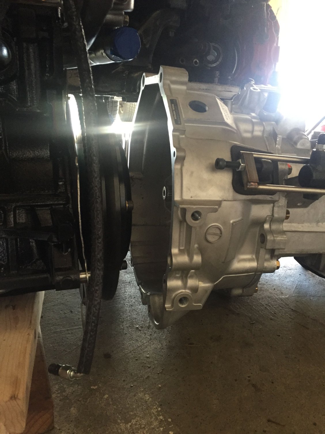

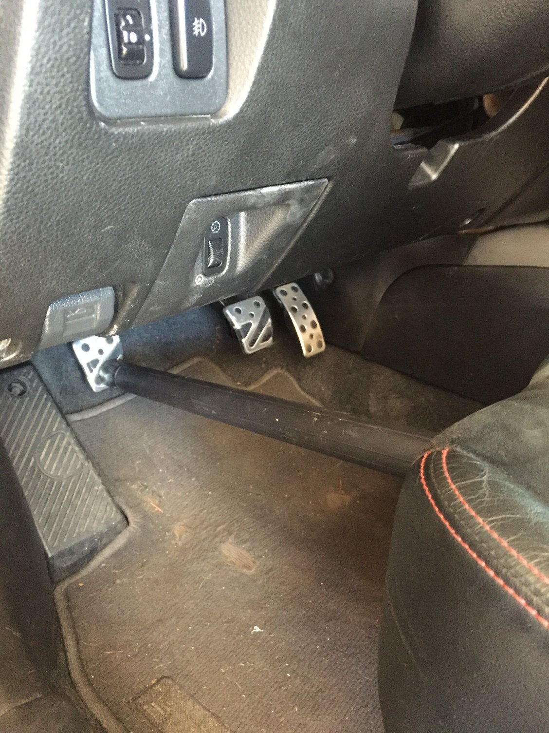

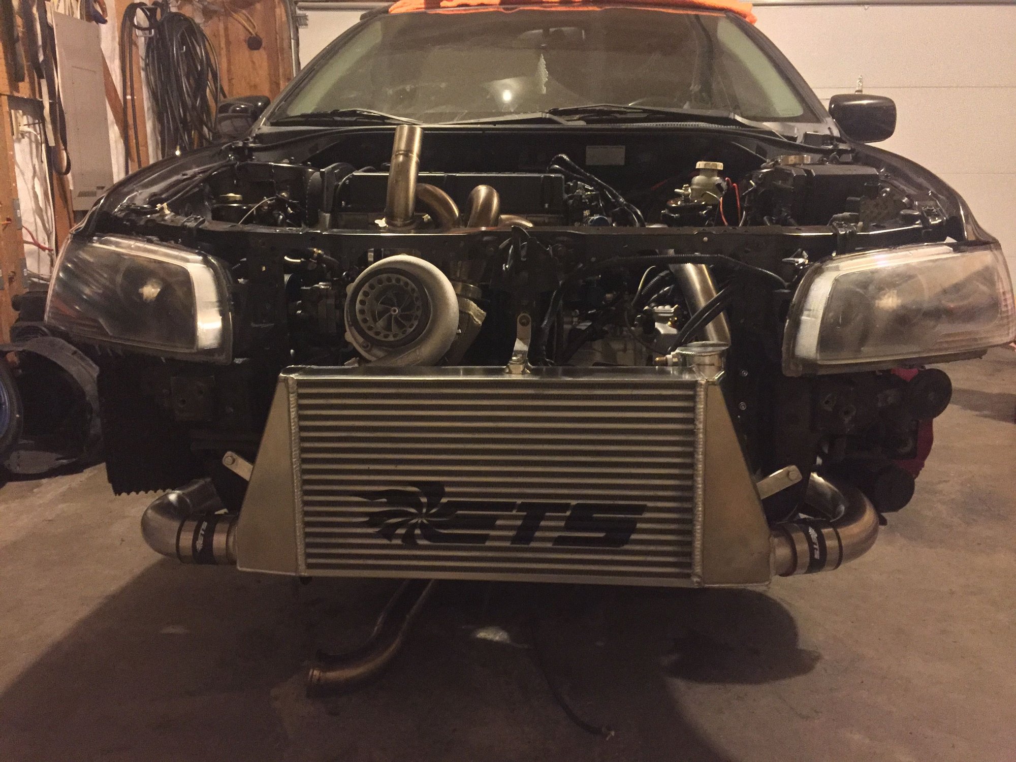

Got the trans this past Saturday and got everything in except intake manifold, wiring, and exhaust that day. Here are some pictures.

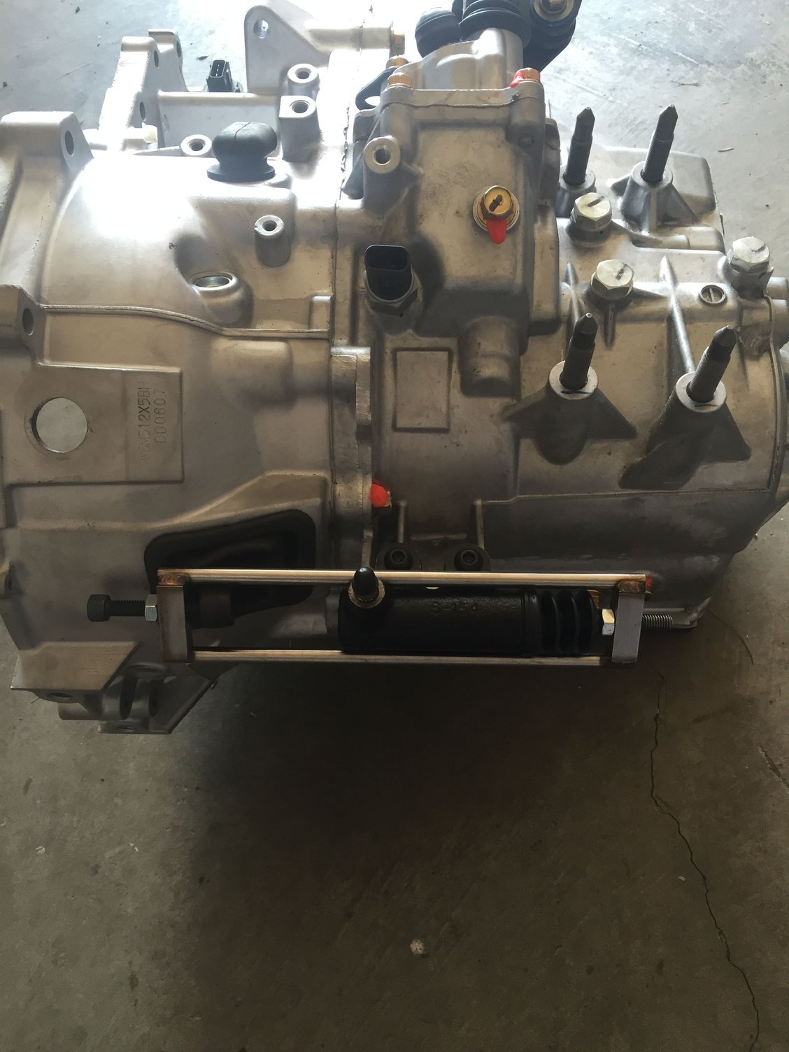

TRE Stage 3<br/>4.11 Final Drive<br/>Evo 8 3/4 Gears<br/>Shot peened and ISF Gearset
So much easier to install this kind of clutch
Easiest trans install ever. Didn't even have to lift it up to meet the engine.

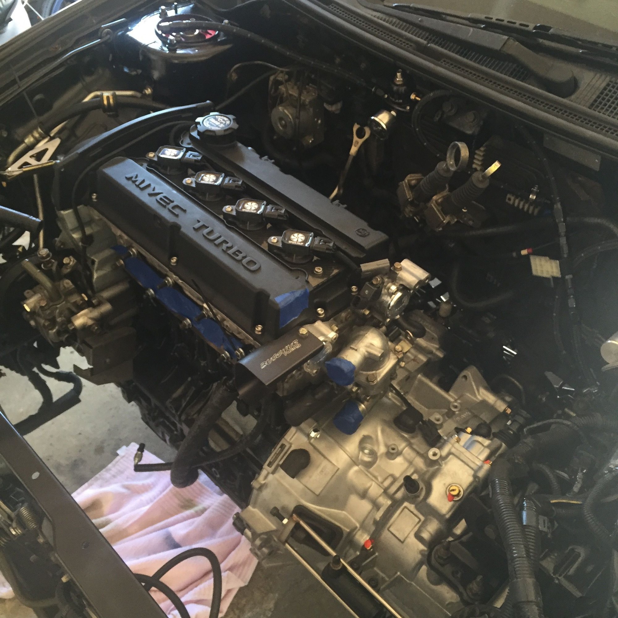

Ended Saturday night like this..
Bled the clutch by myself using my seat and a vacuum extension haha

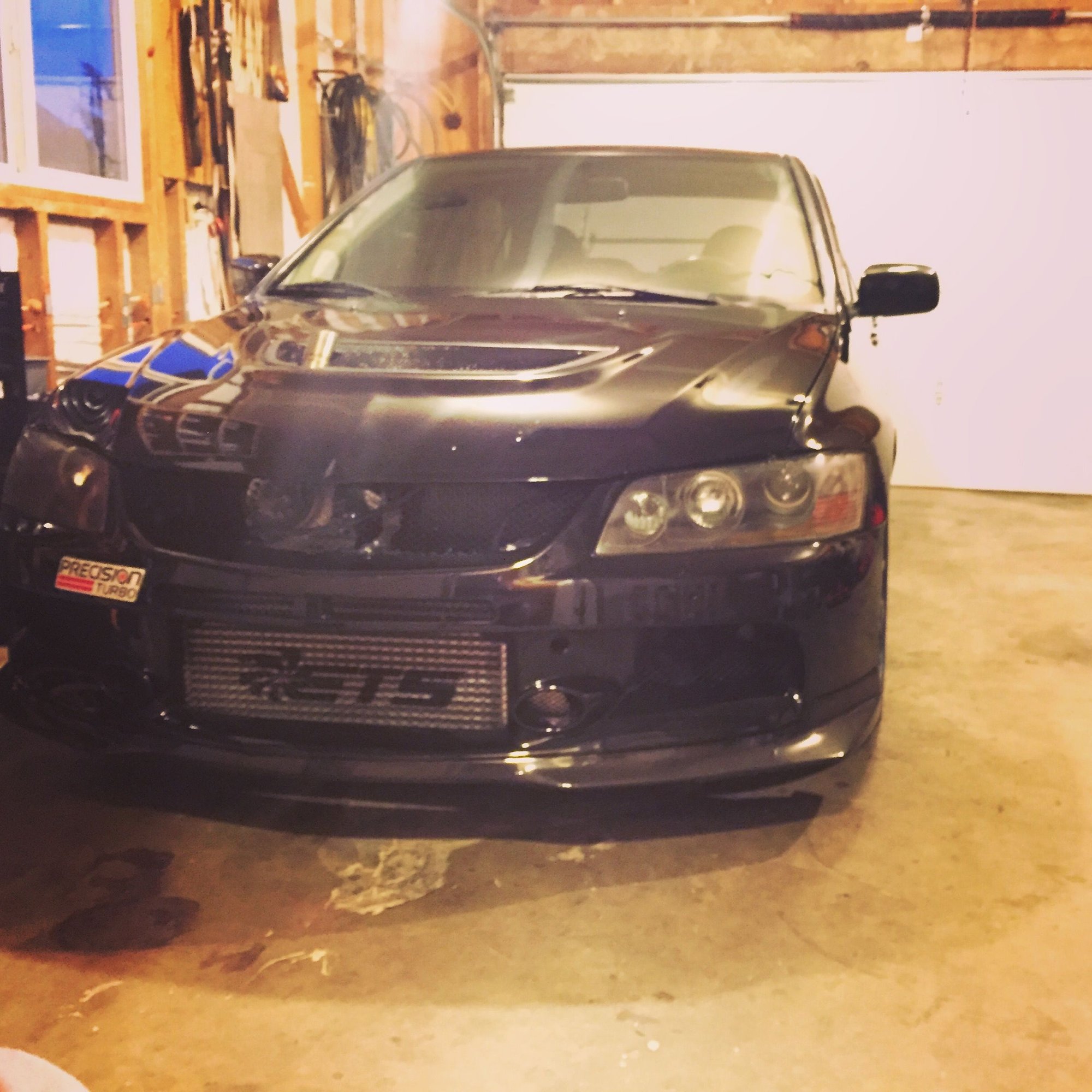

How it sits today

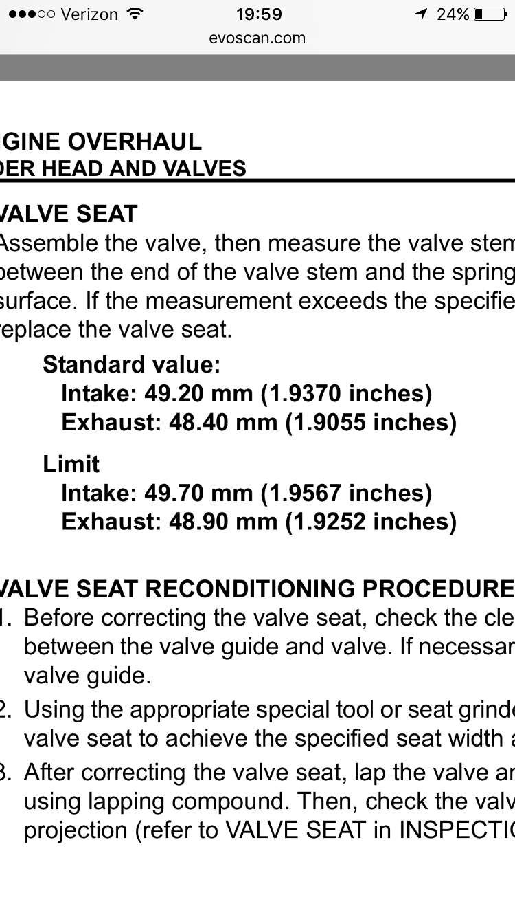

Small update, I have to call the shop tomorrow and see if they have checked valve stem height. That has to be the issues at this point. They pressure tested it today and it was good... Without the cams installed that is. I'm gunna make sure tomorrow that they know to check the installed height out. I'll post what it says it should be in Evo scan below. Not sure if it is the same for 9's and 8's. If anyone knows please let me know!

Screenshot off Evo scan for installed valve height specs:
