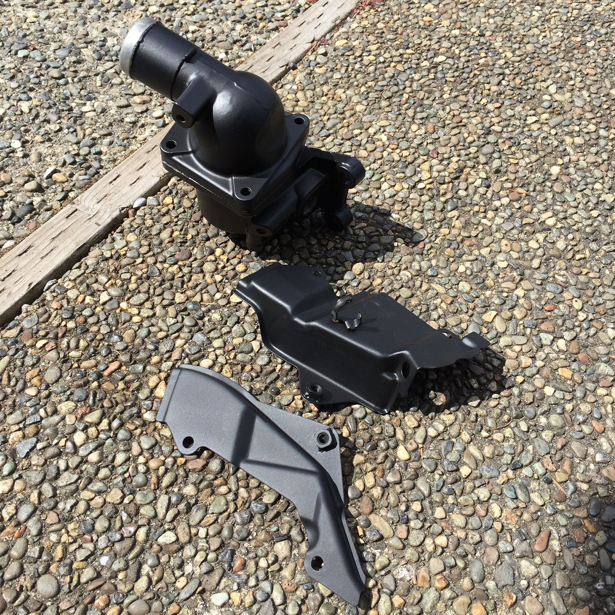

Forgot to show some bored beauty work I did on some small metal pieces using an Eastwood powder coating gun and a toaster oven. Once I get my bigger oven wired up I'll probably do mine and a buddy's brake calipers.
Tried powder coating out. Came out looking good. Thermostat housing and metal timing belt covers done here.

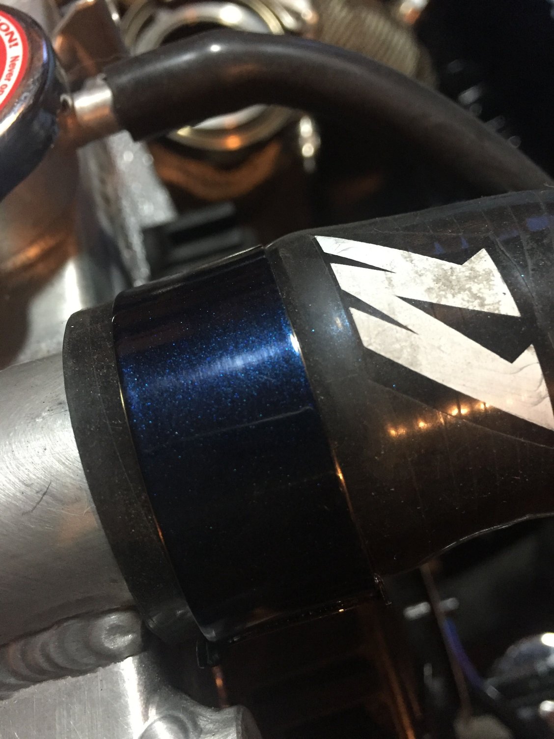

Radiator bracket and hose clamps done in misty midnight

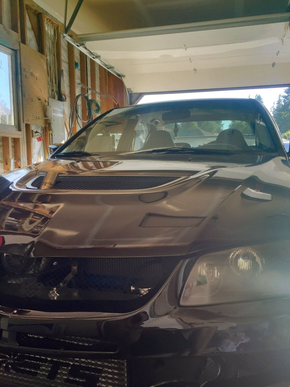

Update
Only issue left is the used 2150cc injectors that are dumping too much fuel. Aaron has them scaled lower than he would have for a 2.0 to get the car to run, so something is up. He got 10 miles on the car but wants to get at least 100 before it goes on the dyno. Hopefully next week is the week!

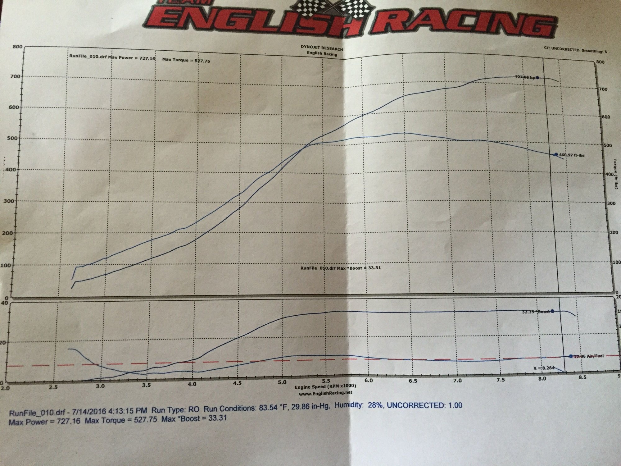

THEY TUNED IT TODAY! Here are some details... Dyno graph to come tomorrow.
727whp/527wtq
34psi
E85
Low timing, conservative break in tune
E40-45 was still 634whp, probably what I'll usually run it around
Aaron wanted me to get 3000 miles on the car and bring it back in for the real deal. I'm still happy with what I've got haha. We still have 6psi and timing to play with so this still isn't over yet. I'll just be happy to get the car back running after 14 months of waiting, spending, and working countless hours to get it where it is today.

Dyno Sheet
33 psi<br/>80 degree weather<br/>Low timing<br/>Not to bad haha. I can wait to really put the boost up and hopefully get some more low end with the timing. The 4.11 final drive makes this thing insane to drive haha
