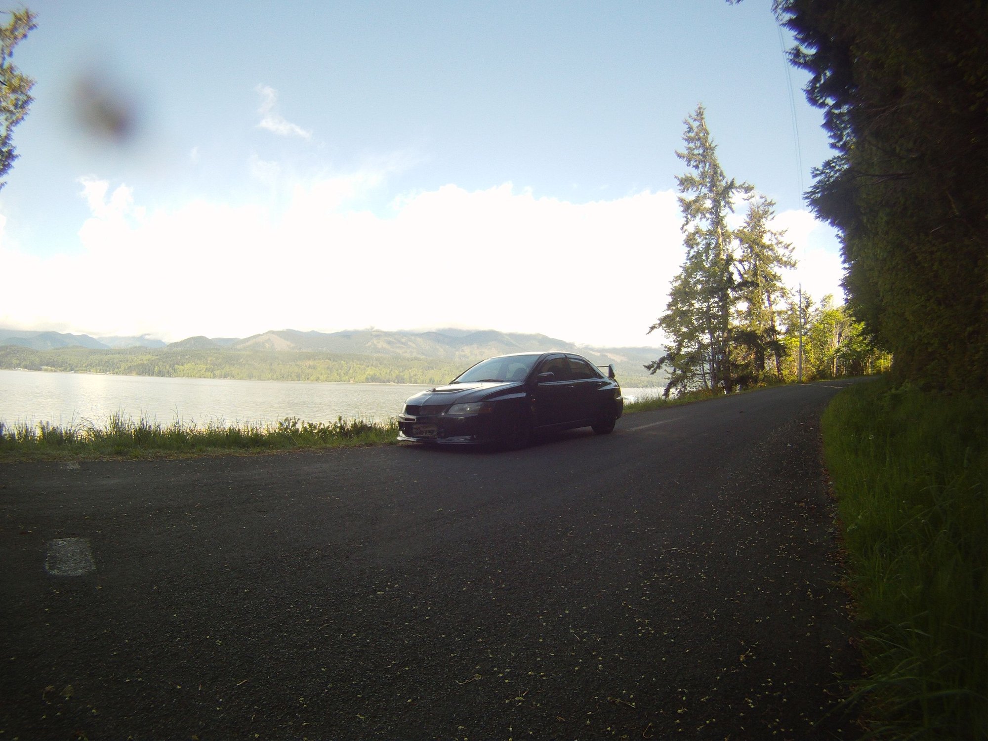

Here are some day 1 pics! I'll do a detailed mods list in a day or two
Day 1, Spring 2014
Day 1
