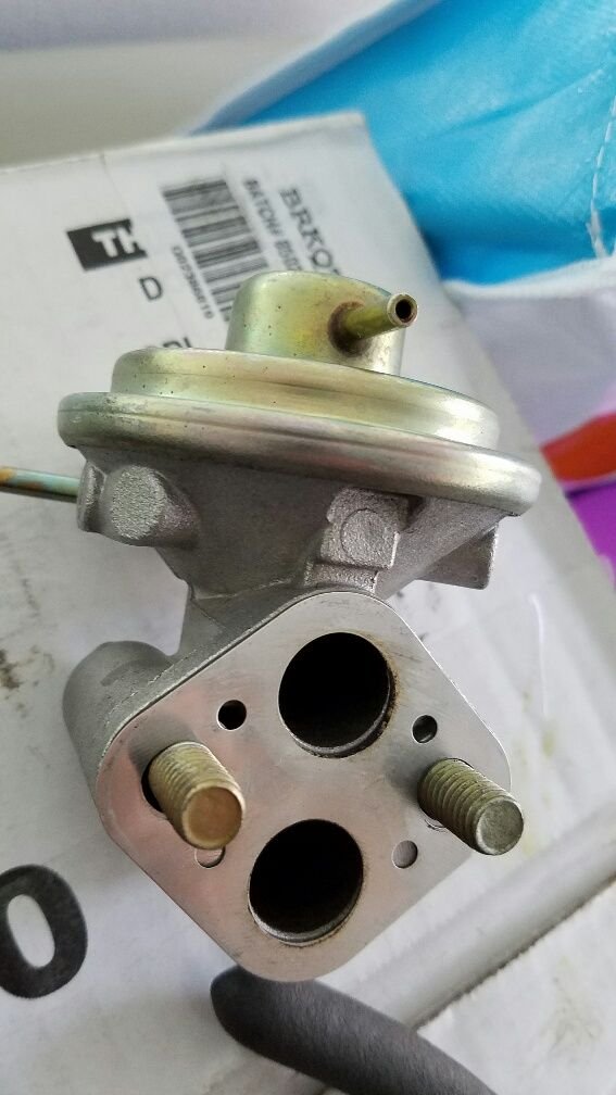

In the beginning of a build here in CA you kinda have to decide how risky you want to be with smog laws in such and where to draw the line. Ditching the EGR system didn't make the cut and I was determined to keep it. As such I used an old tooth brush and brake cleaner to refresh the EGR valve.

I would block off the EGR. I believe the thermactor port in the head is the correct size for 3/8 or 1/2 pipe thread. Tap it, and plug it up. You can leave the EGR valve in place and functioning, but there will be no exhaust gases coming through.
Smart. Do this.
That sounds like a darn good idea! I'll give it a go once my intake manifold comes back from boostin.

The port your blocking is in the head, not the manifold. Its on the cylinder 4 side, on the intake side of the head.
About halfway through the post it shows the port you want to plug. Looks like its 1/8 NPT though.

I see. So this just blocks the exhaust gases from entering the EGR to begin with.
-pal215

Yeah. Keeps them out of the intake manifold all together. And its 100% stealth to the smog ****'s
