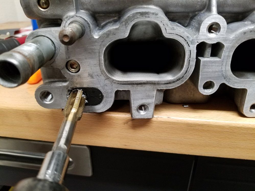

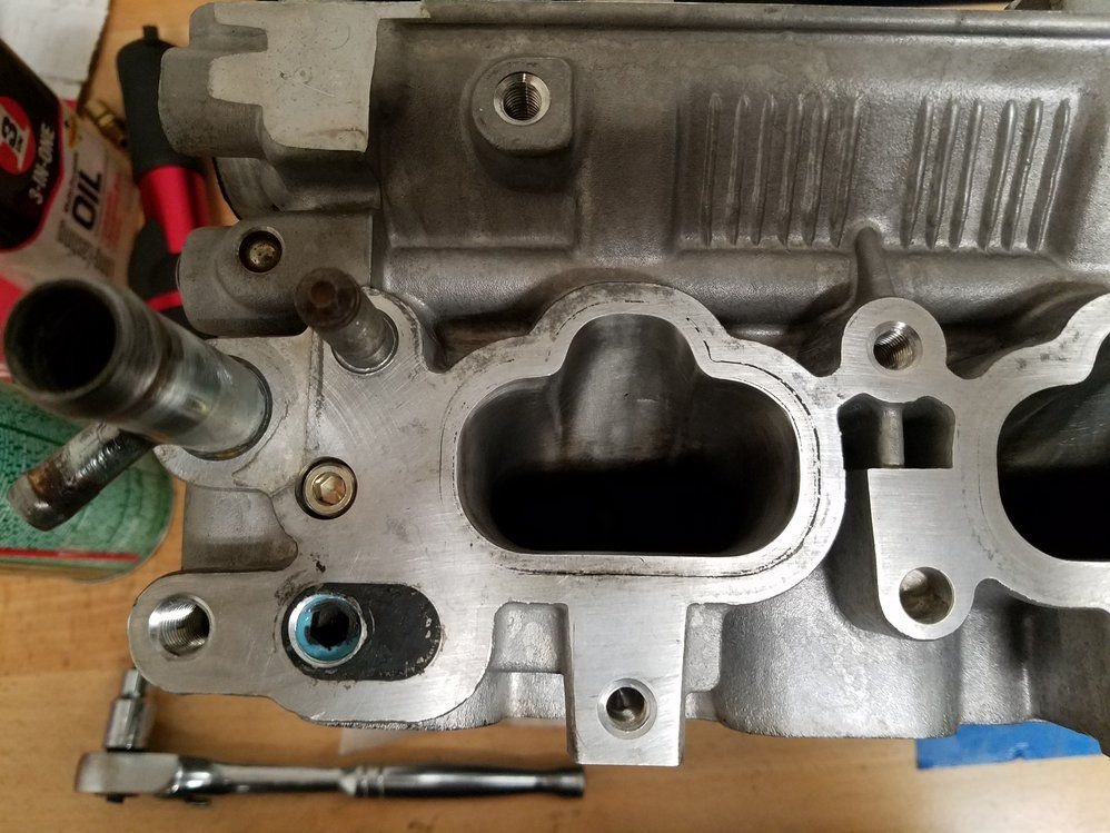

Got the P0401 code today while on the stock tune, "EGR SYSTEM FAILURE." All vacuum lines are on there and the solenoids are plugged in. I think it's because of the EGR port plug that I put in. I'll be removing it and testing to see if it solves the issue. If so, I will stick to the EGR block off plate from now on between smogs.

Hey Pal 215 - You are also going to need a stock MAP sensor to stop the P0401 code from getting thrown. The test looks for a specific pressure increase when the EGR solenoid opens the valve.

Most definitely. This code came up even with the stock MAP sensor, which tells us that there is no way we can get away with a blocked EGR port on the stock tune, which is required to pass smog . So far no more CEL after removing that threaded plug.
