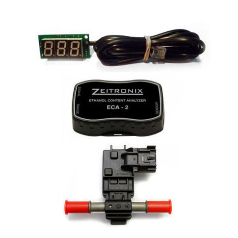

The FiTronic kit? It is my understanding that the flexfuel sensor is exactly the same, but the interpreter box and gauge may be shaped and look different. Their behavior is the same though more or less. They'll read an ethanol percentage from the sensor in the form of a frequency and convert it to 0 - 5v signal that's fed into the oem ecu.

Not quite, the OEM ECU needs a 0 - 5v analog signal so the Zeitronix kit comes with a box that converts the output of the Flexfuel sensor (in Hz) to a voltage that the oem ecu can read. It gets wired to the same ECU pin used for a map toggle switch. Here is the exact kit I got minus the harnesses it came with.

The FiTronic is literally the same. It converts the Hz signal from the sensor to a voltage signal and sends that voltage signal to the map switch pin on the ECU. The Zeitronix and Innovate ECA gauges have the same voltage output to wire into the UCE. And he uses the same ROM (and he even has permission to do so from FiTronic).
