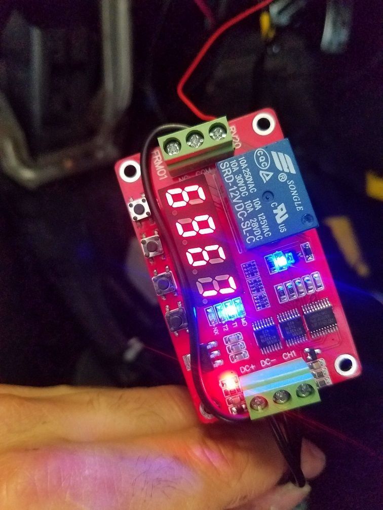

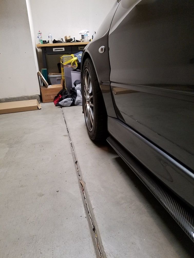

I already posted this part elsewhere, but I picked up some STM 20mm hubcentric spacers and ARP extended wheel studs. I really like the way the OEM BBS wheels look on the Evo IX, but they just have the wrong offset. After lots of measuring I realized I was able to use the factory lugs too, although there are chrome plated open ended mag style seat lugs from Dorman that will work as well. I also decided to pull the trigger on a two channel dash cam. I picked up a Blackvue DR900S 4k cam with an aircraft aluminum mount that bolts to the rear view mirror. I am very happy with it thus far because it syncs to my house's wifi when I get home so that I can view the video capture on my phone or PC. No more pulling micro sd cards. I also found a way around buying their "parking mode" battery pack. I'm using a timer controlled delay relay that keeps power to the camera for two hours after I turn the ignition off. That should be more than long enough for grocery store stops and obnoxious lunch break locations. It's sort of like a turbo timer for electronics that you can configure the time on and power anything that takes a 12v DC source. That delay relay costs only 15 bucks as opposed to the 300 dollar battery from Blackvue. The idea behind the Blackvue battery is so that it doesn't drain your car battery, but the camera won't be able to do that in two hours and driving in between.
Sweet new metal..
Much better....and NO RUBBING!
Timer controlled delay relay board

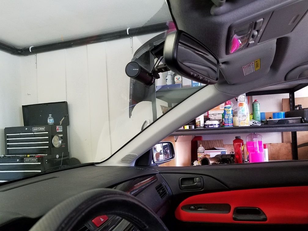

front cam
rear cam
The other good news is my that my lease finally expired on the Mazda 6....So my wife and I bought her a Black 2018 Mazda MX5 RF Club. This is the BBS/Brembo package with a Boss sound system, Bilstein shocks, LSD, LED headlights, and 6 speed manual trans. She loves it, and it's nice upgrade from the 4 door family sedan we had prior. Also I don't care what anybody says, this new Miata can HANDLE and looks great doing it!

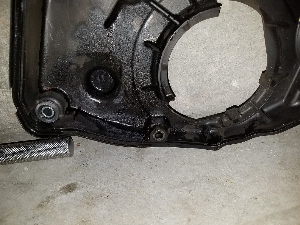

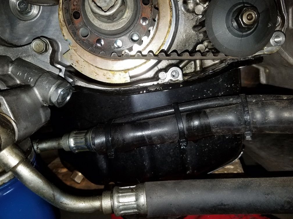

The Evo is leaking oil slowly from the oil pump front cover area and I am fairly certain it is the oil pump gear seal. Seems like an early seal failure as my oil pressure and crank case pressure is under control these days. Leaks typically flow from the highest location down and it's squeaky clean behind my cam gears and crank gear. I don't think its the oil pan leaking because I cleaned the hell out of the area and used plenty of RTV upon install. I took some pictures to show you guys first before I start changing parts I don't need to. Where do you think it's coming from and is there a way to change the oil pump gear seal without pulling the oil pump front case assembly?
Thanks in advance for your help Gents.

It certainly does look like it's the pump gear seal but did you replace the front case with a new one? IIRC the front case comes with that seal already installed and I'd be pretty surprised it began leaking that fast.
I'd be more inclined to think it's the oil pan since that's way more likely to leak but anything is possible.

Yup, this front case was a new one. I wonder it's possible that the oil pump shaft is off center. The "fix all possibilities " solution would be to just replace the oil pump front cover, which I don't necessarily mind doing if I have to, but I just changed the oil
I'm going to try replacing the Oil pump seal first and keep an eye on it for a while.

Was it an OE pump or and ACL pump? If anything maybe throw a bit of UV dye in the oil and that might give you a better idea where it's coming from.

OEM pump as far as I can tell. I've never worked with UV dye before, is it safe to place and leave in the oil? I'm actually not surprised that this happened to me as far more unlikely things have haha.

Man, I have the same problem with the front seal Brand new oem front cover and seal already installed, I get a few drips under the car every time I drive it. I replaced the pan with a brand new one thinking that's what it was too. Didn't help a bit.. I've just accepted that it's going to have some horsepower sweat and put a drip pan under it for now lol
