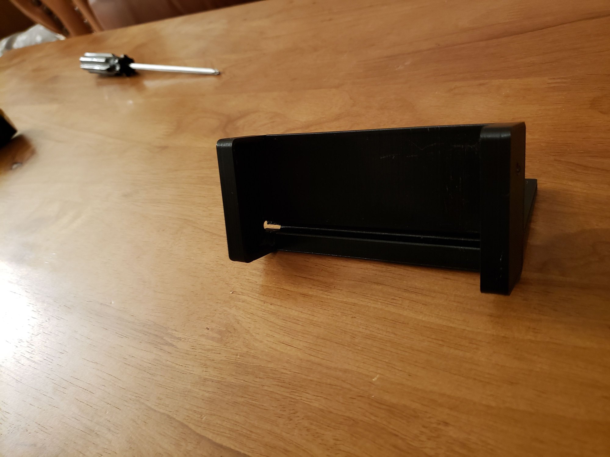

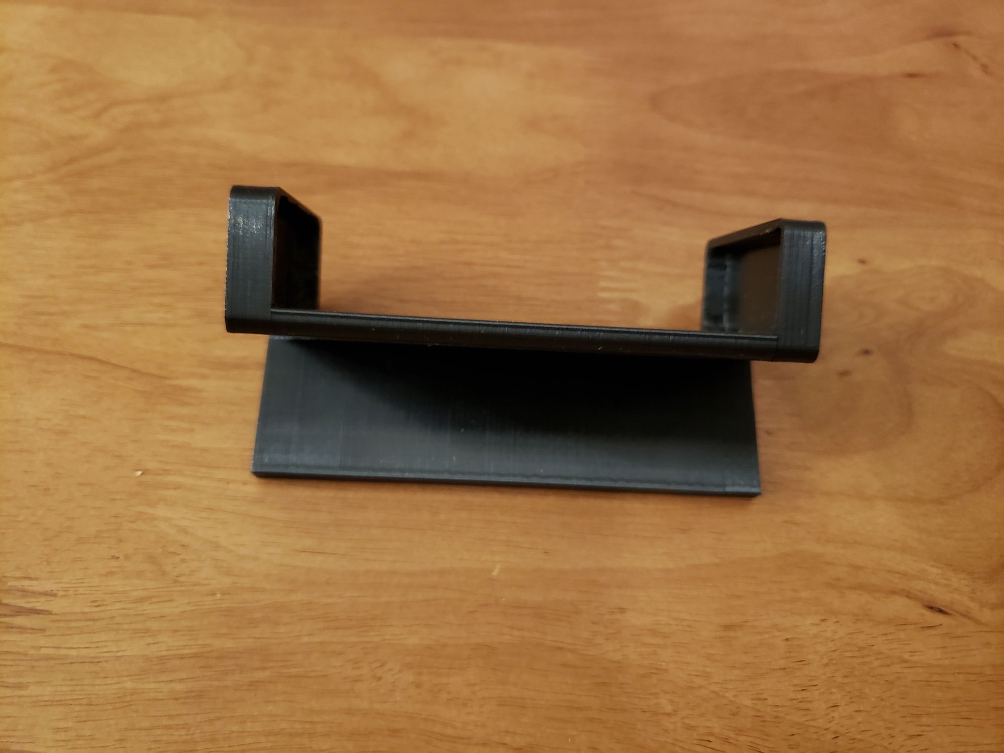

I recently replaced my triple gauge pillar pod with a single zeitronix LCD readout screen. I was happy to free up some windshield space and clean up the dash, but I was not a fan of placing the Zeitronix LCD unit on my steering wheel column. It blocks some of the oem gauges and looks thrown in like so:
I asked my close friend for some help 3D printing a custom, clean looking, bracket that replaces the lcd gauges plastic end caps, to hold the zeitronix unit to the dash all while using the factory gauge screws. The bracket is then secured to the dash using 3m tape. It turned out fantastic!
If anybody needs one, he is willing to print and ship them for a great price. PM if interested.

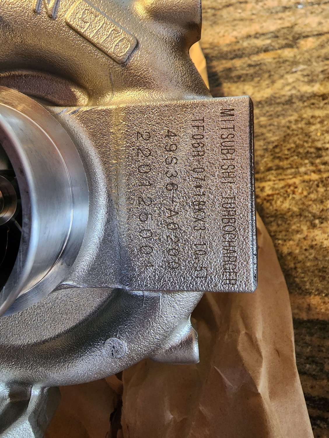

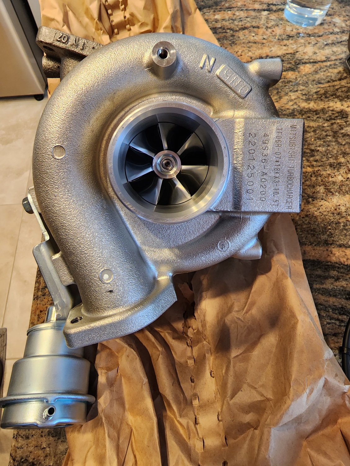

The turbo has arrived and the new SE lip is on it's way! With the stock turbo and stock 2.0 block I made 430hp and 414 torque on E85. With this turbo I am shooting for 500hp and 500 trq with the 2.3l on E85. That's slightly a bigger engine with slightly a bigger turbo so I hope it works out.
