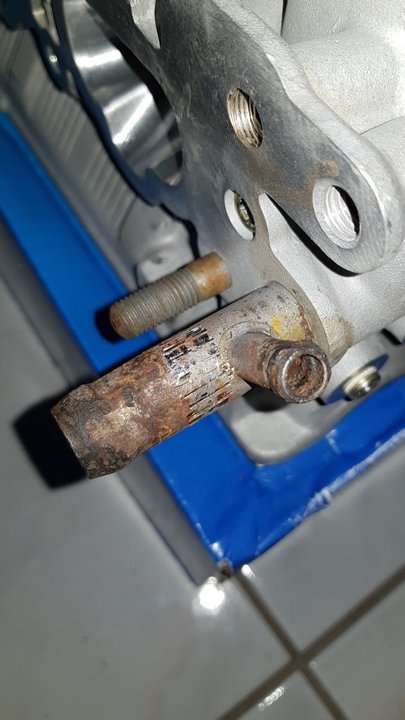

Heater line delete mod.
Last week I managed to get the cylinder head heater line tube deleted. Safe to say that it's too warm down here to need heat in the car. The lowest temp recorded here was 52 degrees F, back in 1968.🤣
​​​​​The before.
Had to pull out the good ole pipe wrench
The after.

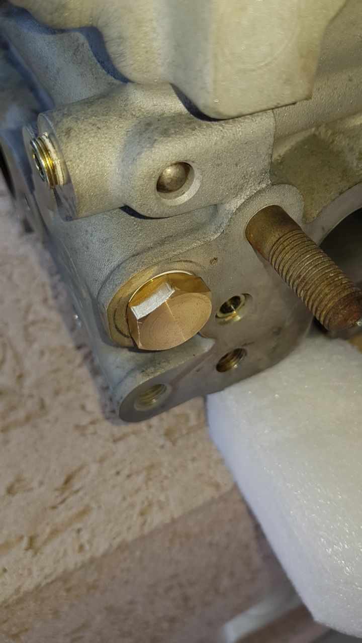

Well... I got a little work done on the cylinder head over the weekend.
1. Installed the Kiggly HLA Regulator.
2. Bled all the Topline Lifters.
3. Installed Topline Lifters
Bleeding the Topline Lifters.
HLA & Lifters installed.
Nice work. I should have done the same. Are you going to weld the water pipe outlet closed or how do you plan to close that?
If what I currently have there holds, I'll be good with that. Plus... With me being a perfectionist, If I were to have it welded; I'd have to get it resurfaced. Wouldn't be satisfied with a blob of filler rod, even if it was recessed in there.

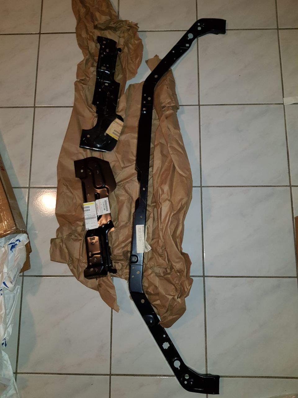

MOAR Parts from STM!
Upper Rad Support and headlight supports.
A LOT of OEM Replacement Bolts, with some other parts for the Rad Support.
Everyone together.

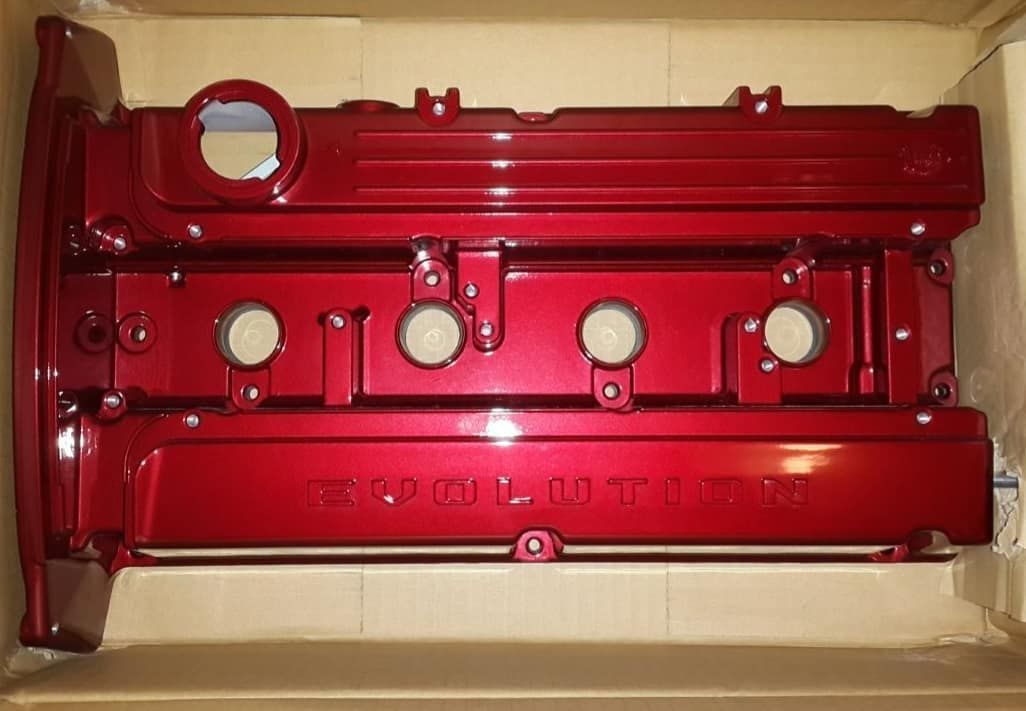

Picked this up yesterday 😎.

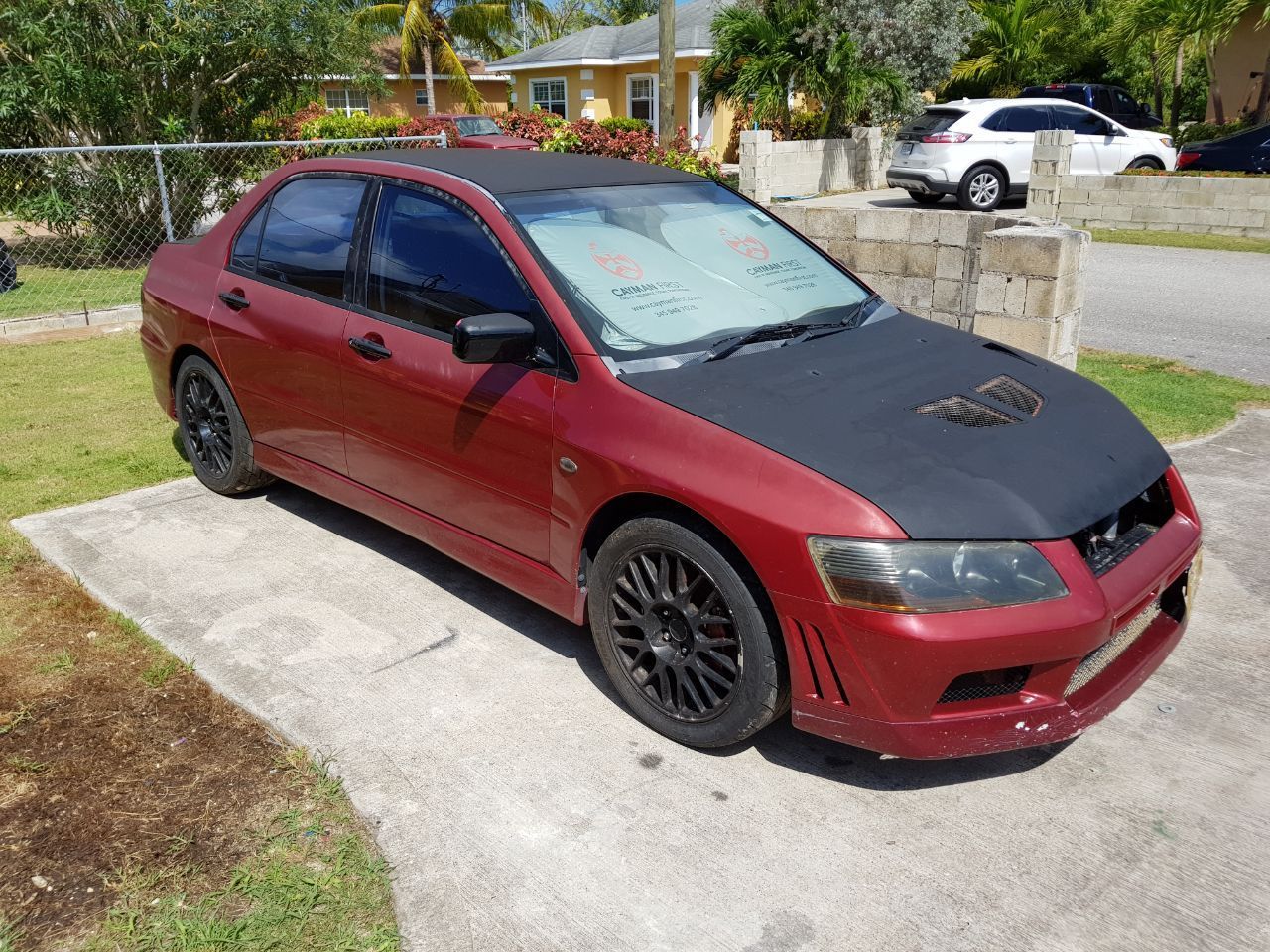

Update Mar 3rd, 2019
Well guys...the car has been moved once again. This is the car in it's current state. nothing much has changed given the paint was already burnt out lol.

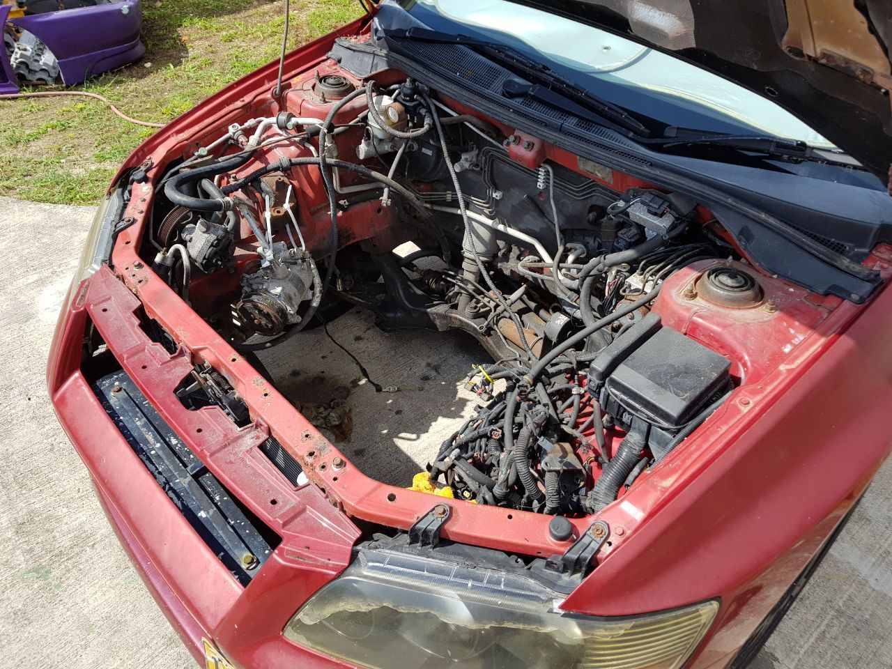

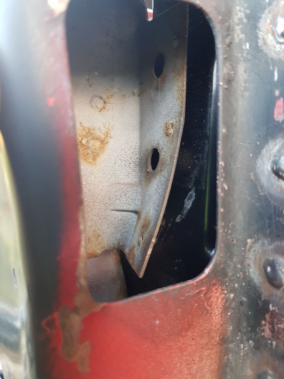

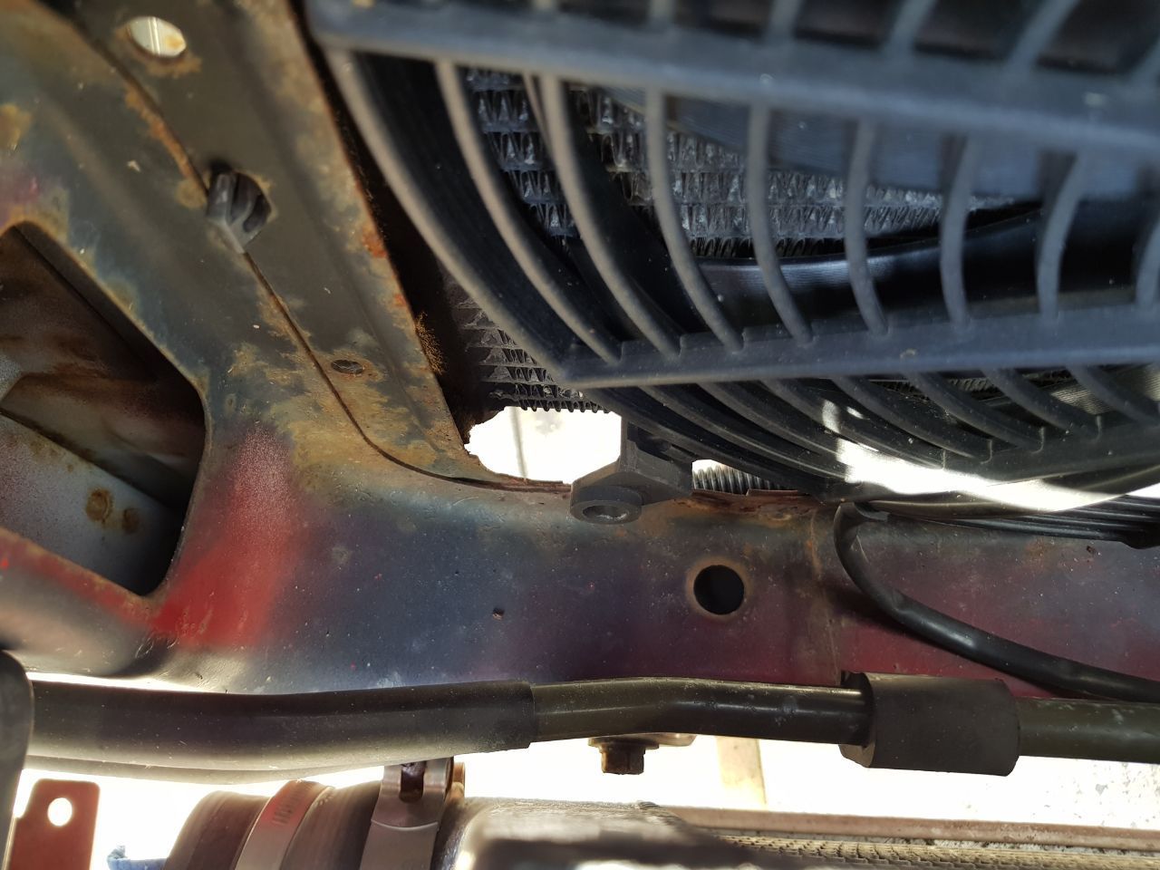

The Engine Bay Chronicles
And here we start with The Engine Bay Chronicles. the next couple of pictures will show the tear down and what the carnage looks like. This is going to take some work, but thankfully I’m in the right hands. Got some good friends helping me along the way through this process. One step closer!
Apologies for some of the crappy pics, but I think their pretty self-explanatory.
The next step is to strip the bay down, and remove all the rust.
Remove and replace the upper rad support and headlight supports.
Treat everything hat needs treating with OSPHO.
Epoxy prime everything.
Seal anything up with 3M Panel Bond, which is what I was recommended to use on the areas that need the extra attention.
Sand down what's needed.
Wipe down with the Mineral Spirits.
Spay the bay.
Wish me luck!
Realized I miss interpreted your question. You were asking about the water pipe inlet connection. You can get a clean oem bolt and get someone to weld it shut. I think the water pump inlet pipe is zinc coated, so a grade 8.8 yellow bolt might be the right solution.
You can also cut the the nipple off, so you end up getting somewhat of a cleaner finish.
Proper coolant (optional: mixed with distilled water) in the system will prevent rust.
Hope that helps.

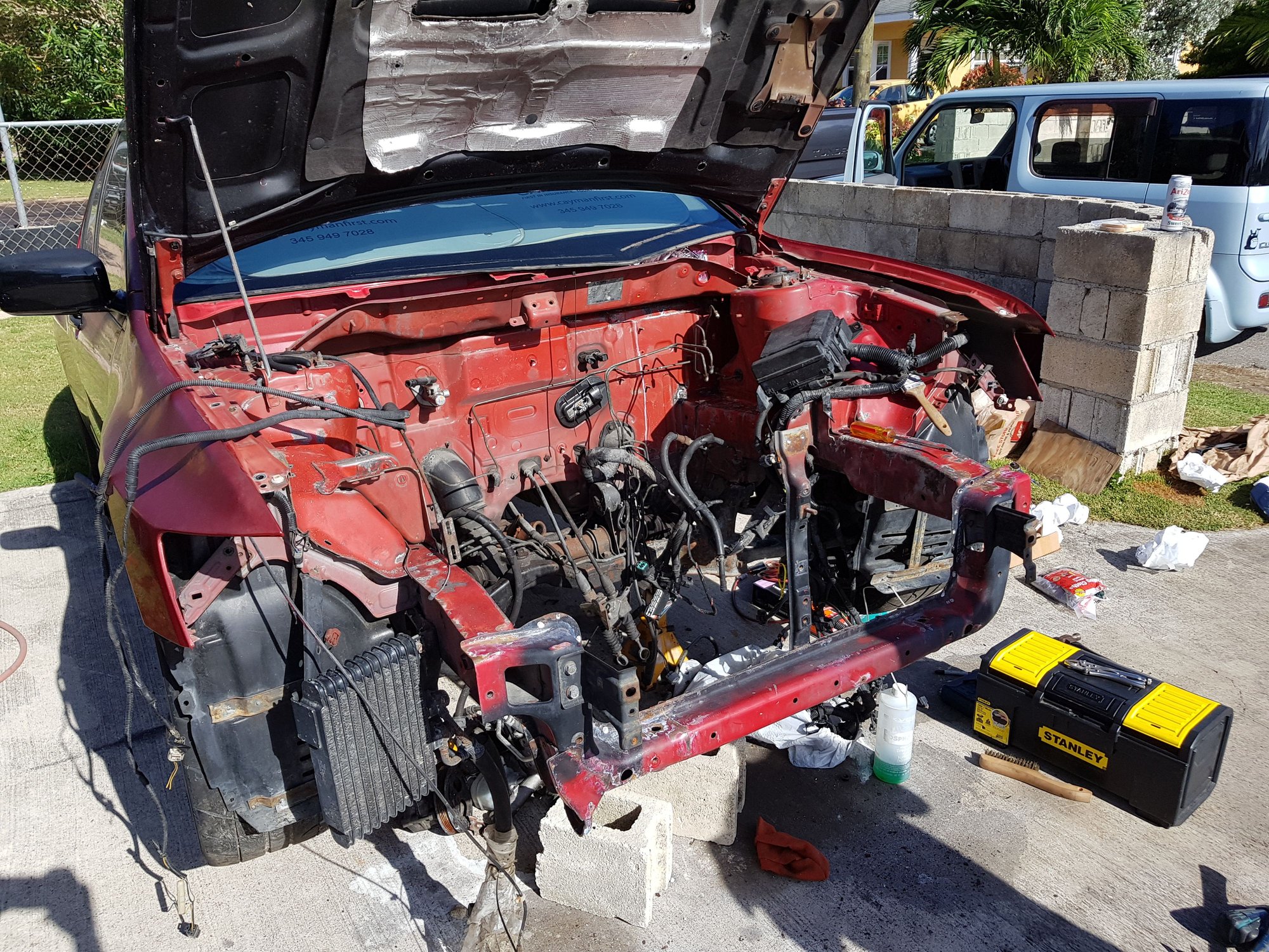

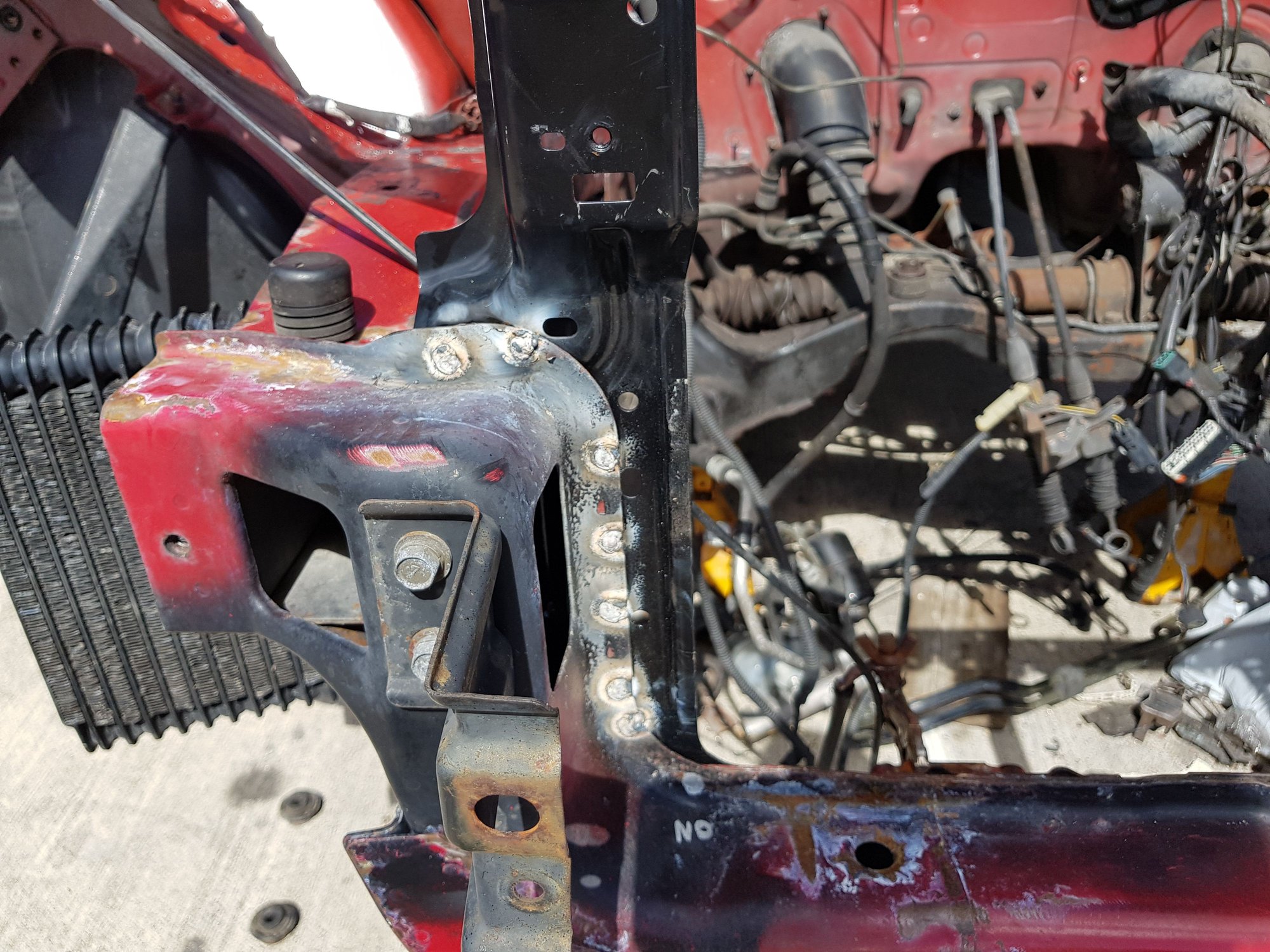

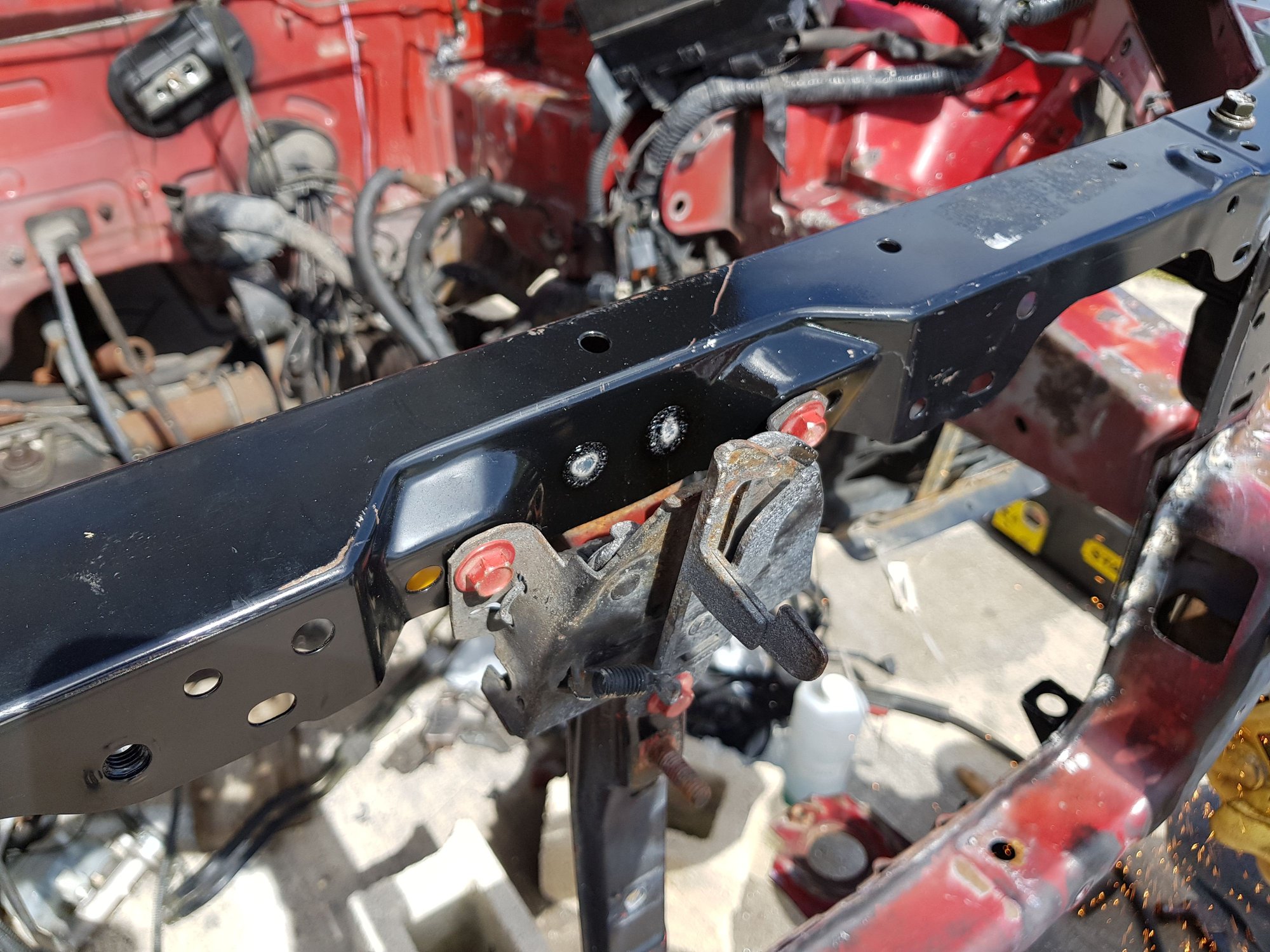

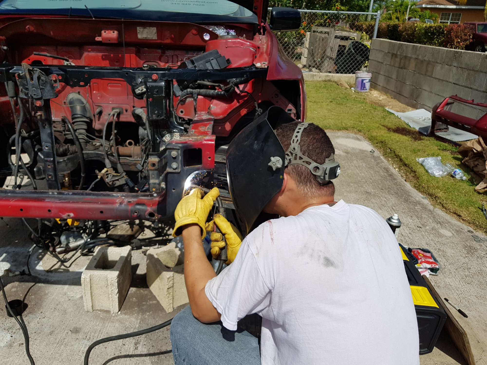

The Engine Bay Chronicles "Part 2"
I'll just dive right into it!
Here are the pics of the work I got done over the long weekend.
After a few straight throughs I mastered the use of the Spot weld removal bit.
Driver's Side.
Passenger's Side.
Got the old frame off.
On goes the New Stuff!
My buddy helping me out with the welding.
Making room for some Intercooler Piping.
The old rusty frame.
Photobombed by the 10mm .

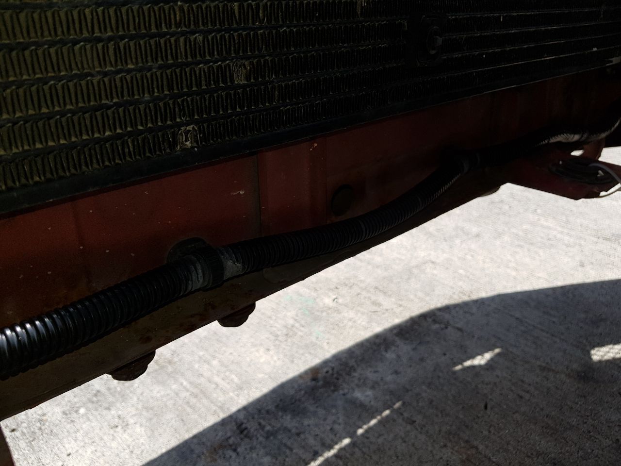

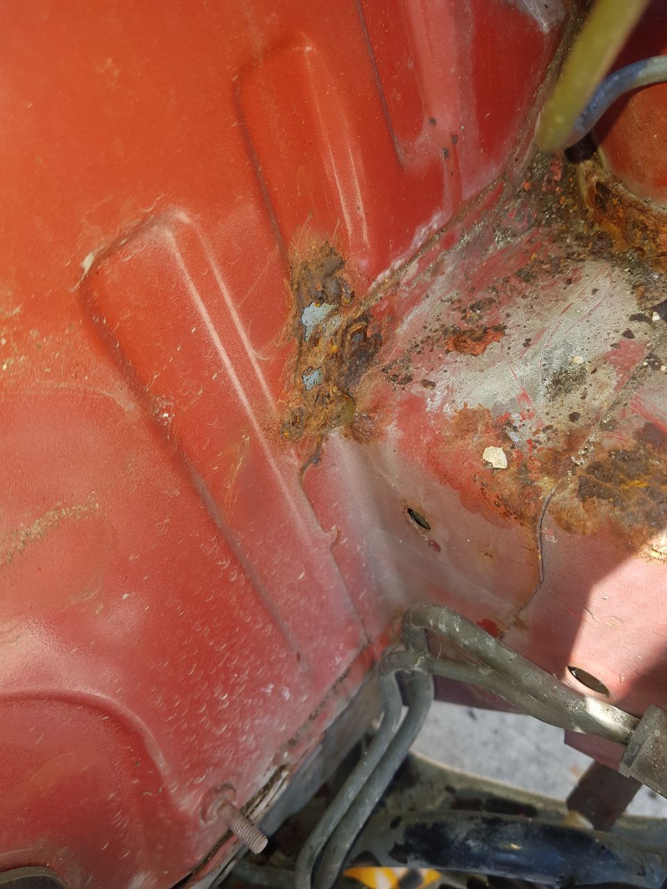

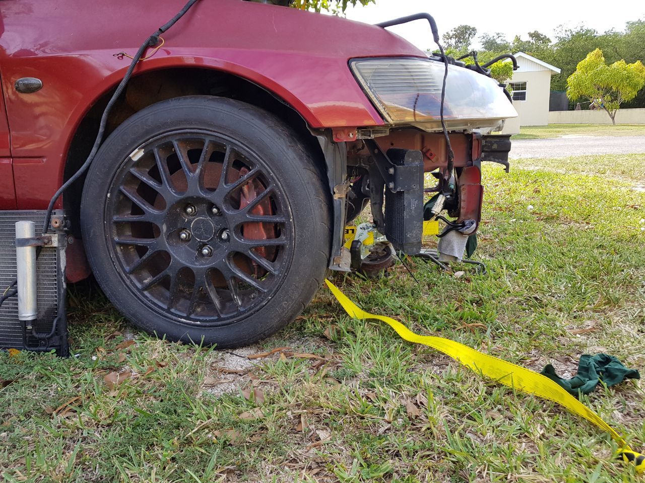

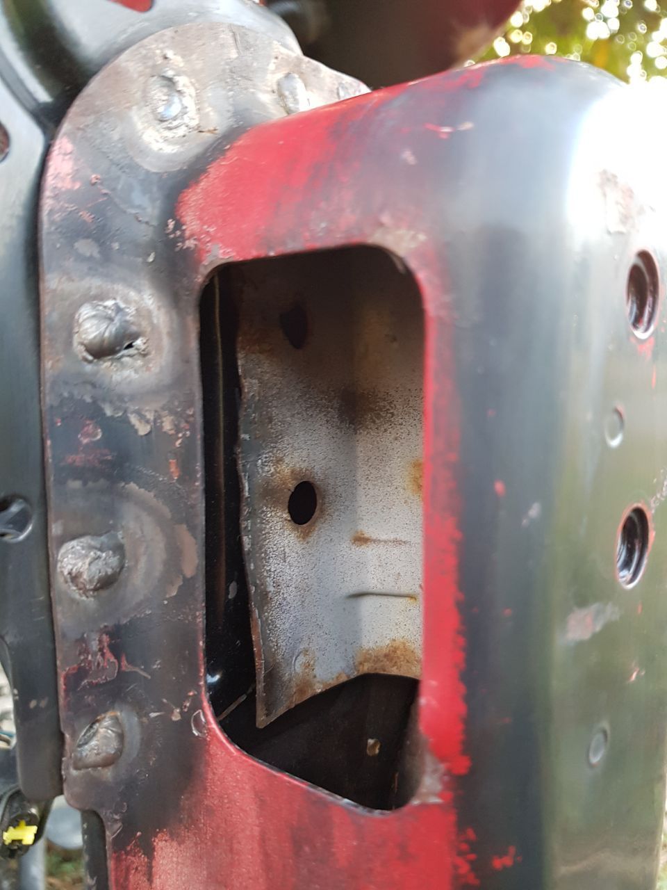

The Engine Bay Chronicles... Continued
Got some work done on the car yesterday, with a little backstory to go along with it. When the vehicle was being put up on the tow truck, the lower rad support took one for the team. Thankfully it wasn't any worse that what it was. It ended up popping a few of the new spot welds, and bent the lower rad support pretty good. The first set of pics are of the damage.
The work I got done includes me:
- Straightening rad support back out with a ratchet tow hitch rated at 1,666 lbs. and a lot of brute force.
- Getting the lights realigned.
- Cleaning the work area of all the road grime that was left in there. (I'm a stickler for cleanliness).
- Re-wire wheeling the the areas that were previously wire wheeled. Found more light rust.
- Cleaning the bay again.
- Applying Ospho to all the exposed metal.
The damage!
Almost there.
Showing how badly this thing was bent on the driver's side.
This was the passenger's side.
All aligned!
Cleaned up and wire wheeled area.
Opsho-ed up to the brakeline and up to half of the lower rad support.
Next up is to ospho the other side, up to the same point; and then remove the brake lines; shifter cables; and wire loom; so there's nothing in the way for the paint & body guy.
