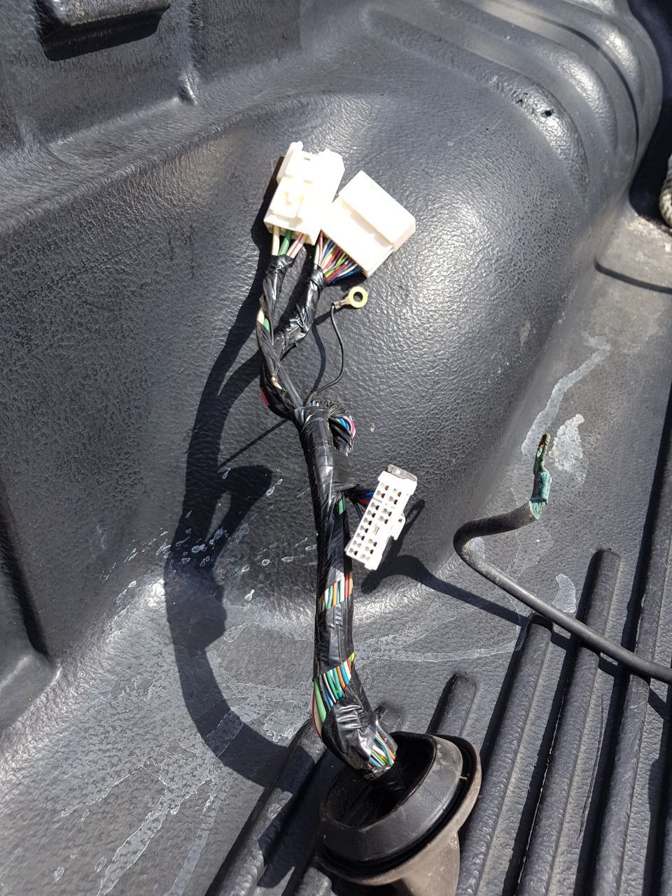

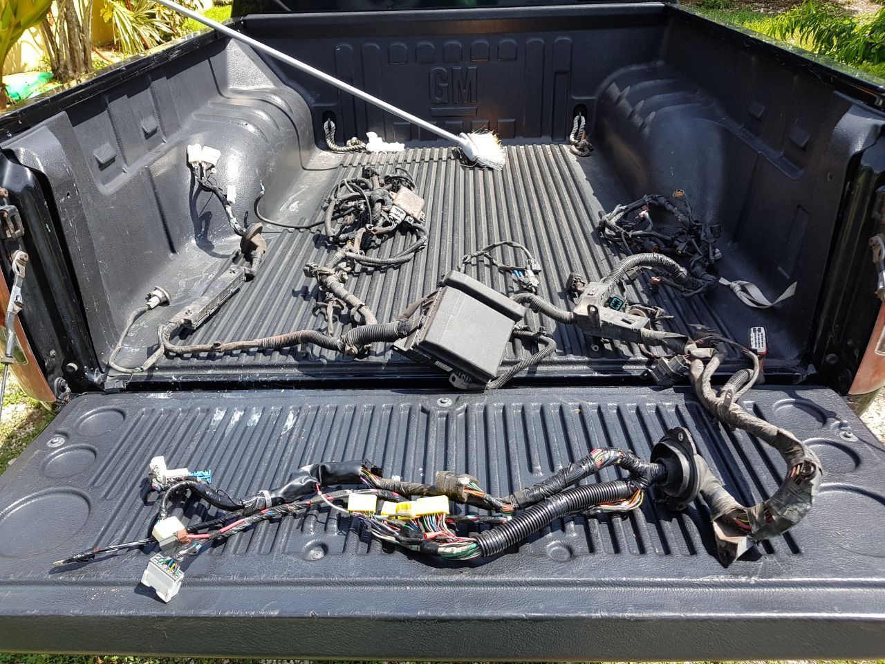

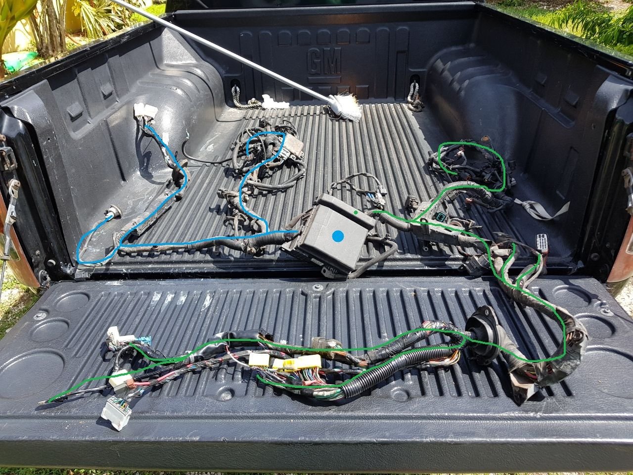

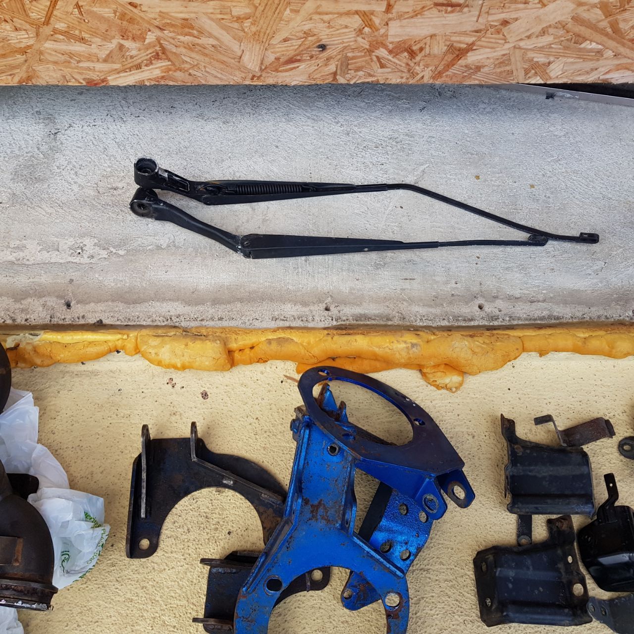

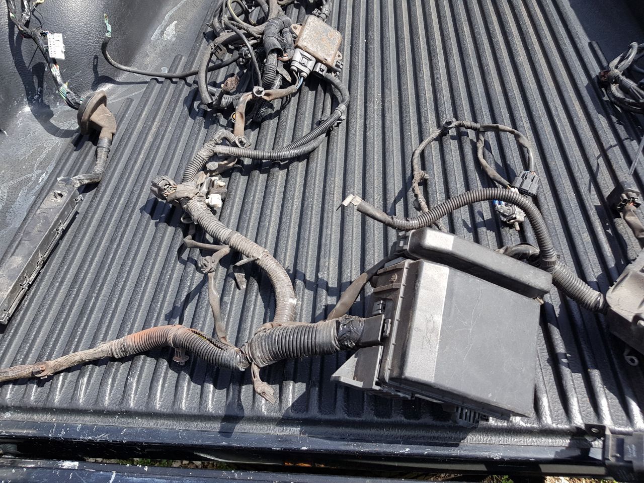

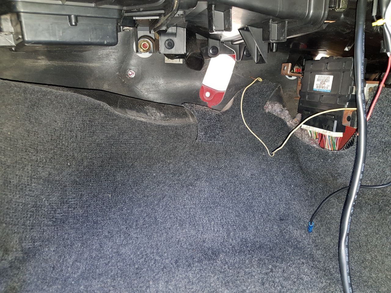

Some pics of the wire harness removal.
Unknown to me, there is actually two parts to the harness. The interior side will typically stay in the car, (it takes a little finesse with a razor) but for those that haven't done this before, you can disconnect the big fuse box from the small fuse box. The engine harness is connected to the small section of the fuse box, and the interior harness is connected to the big section of the fuse box.
Blue: Interior Harness Green: Engine Harness
THE MORE YOU KNOW

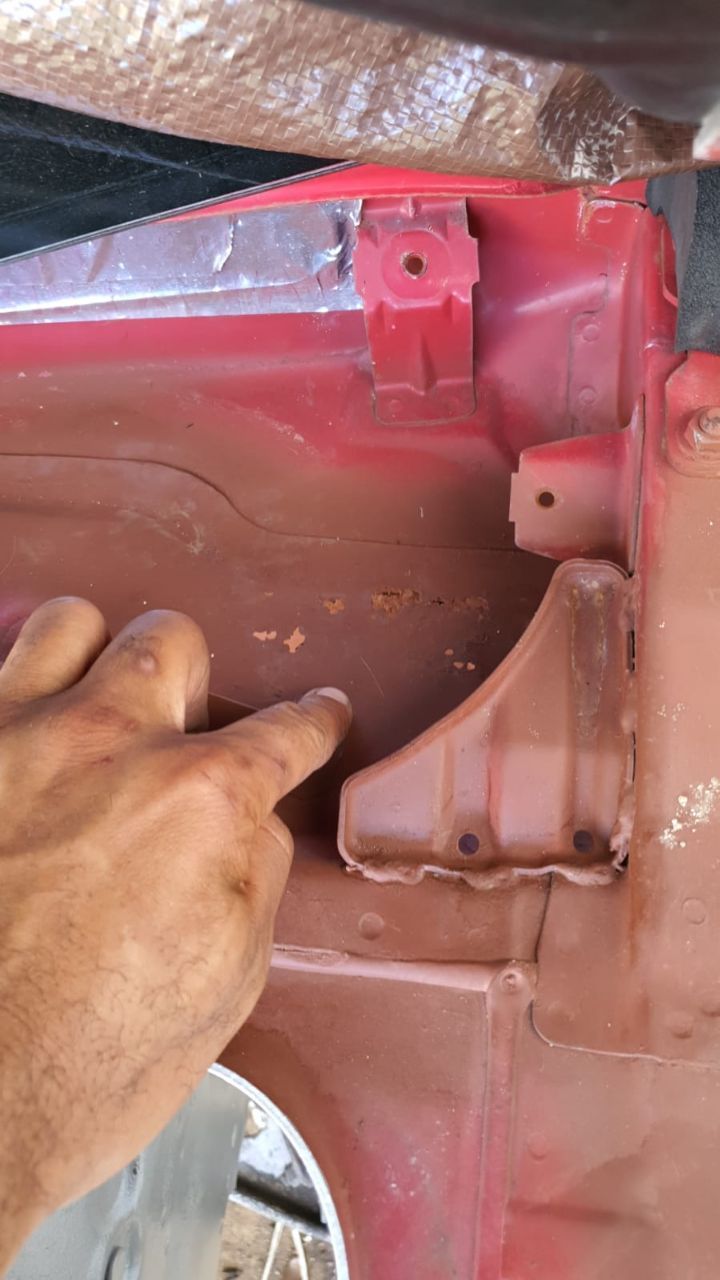

"Never put all your eggs in one basket" Last year I was hoping my car would be in the body shop by December. Needless to say, that didn't happen. In a nutshell, I had to eventually reach out to another Body Shop. After speaking with the new shop the ball started to roll again. Around mid January I bought some material to build a work pad for the car. I also bought a tent for some additional coverage from the elements.

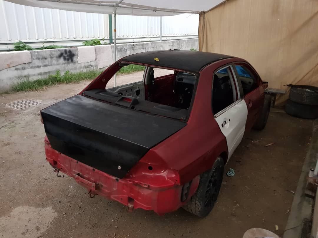

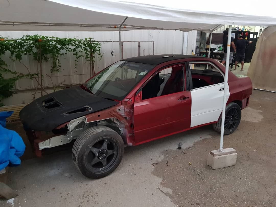

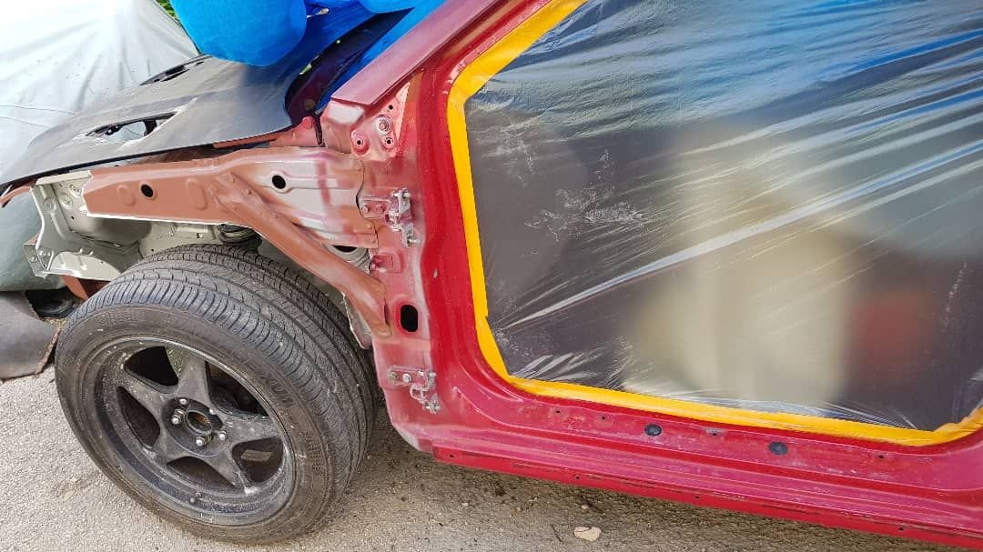

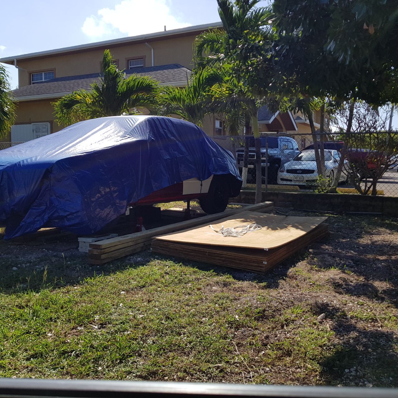

After about two weekends the pad was completed and the tent was secured along with the cover put on; the following week I got to work. took a few days off that i had to use from 2020 vacay, so why not lol.

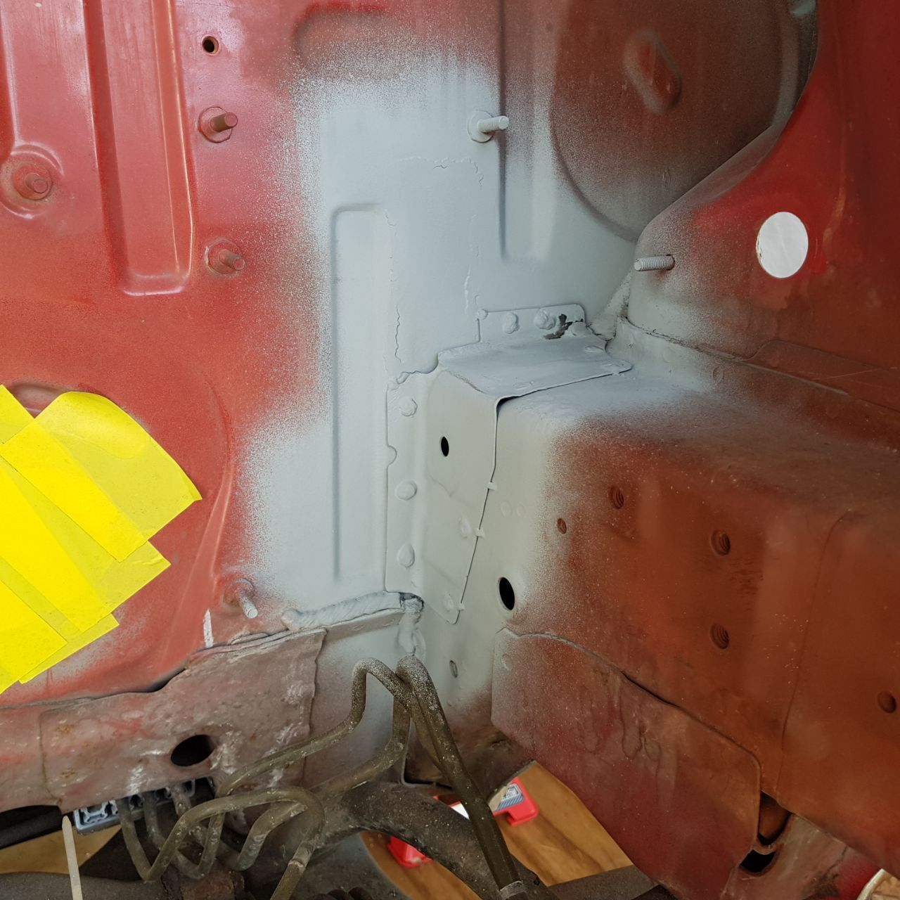

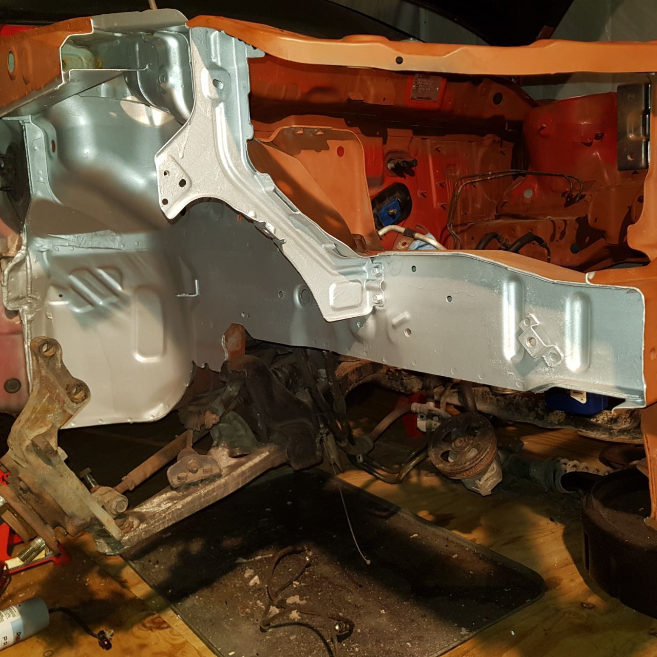

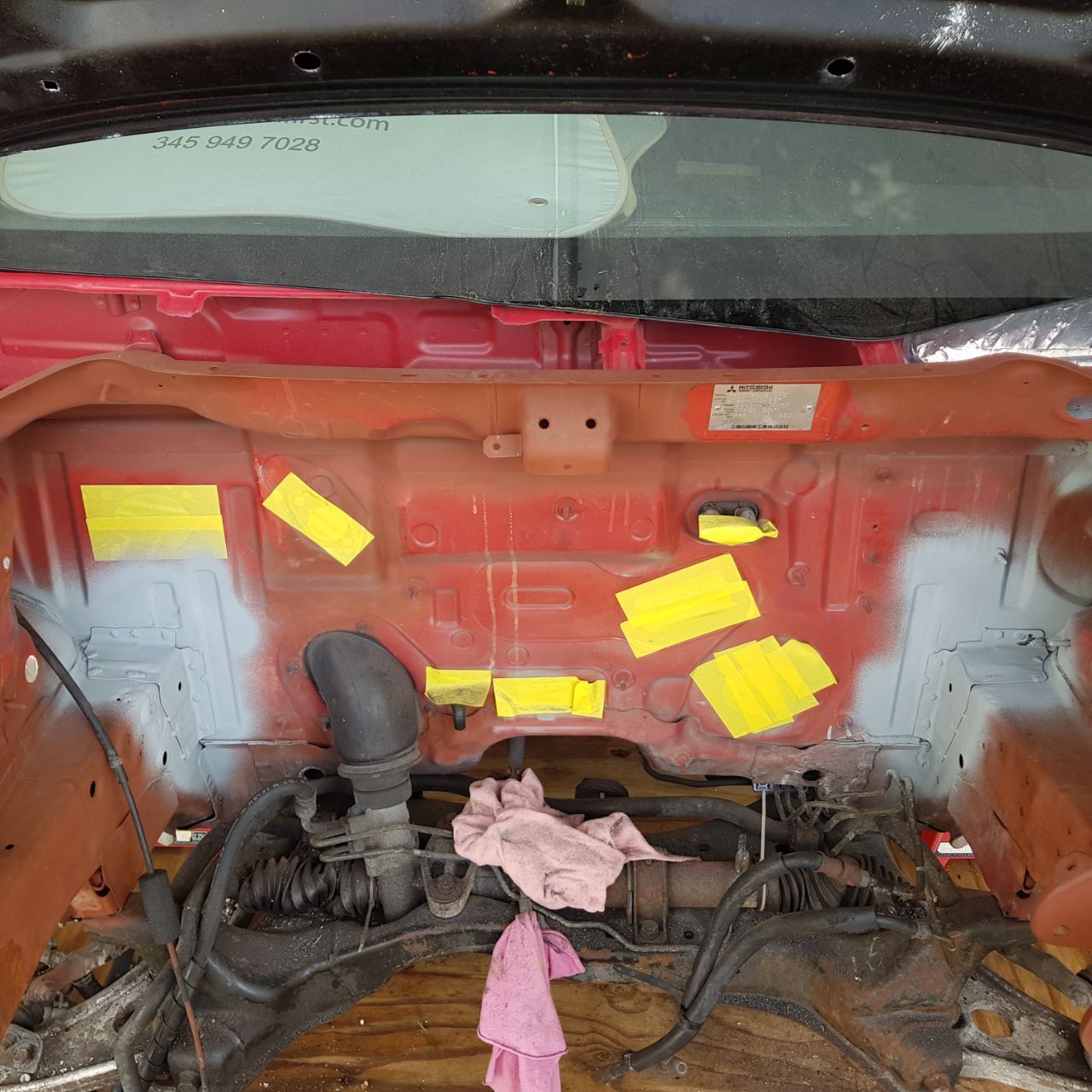

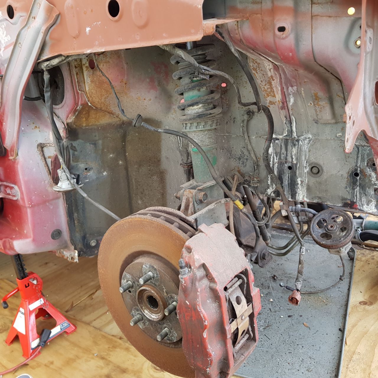

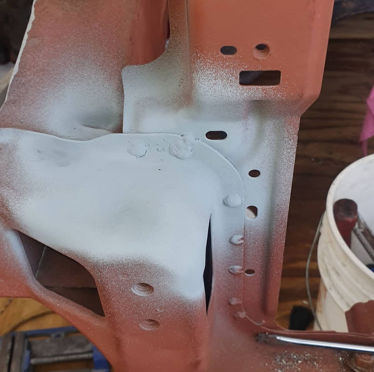

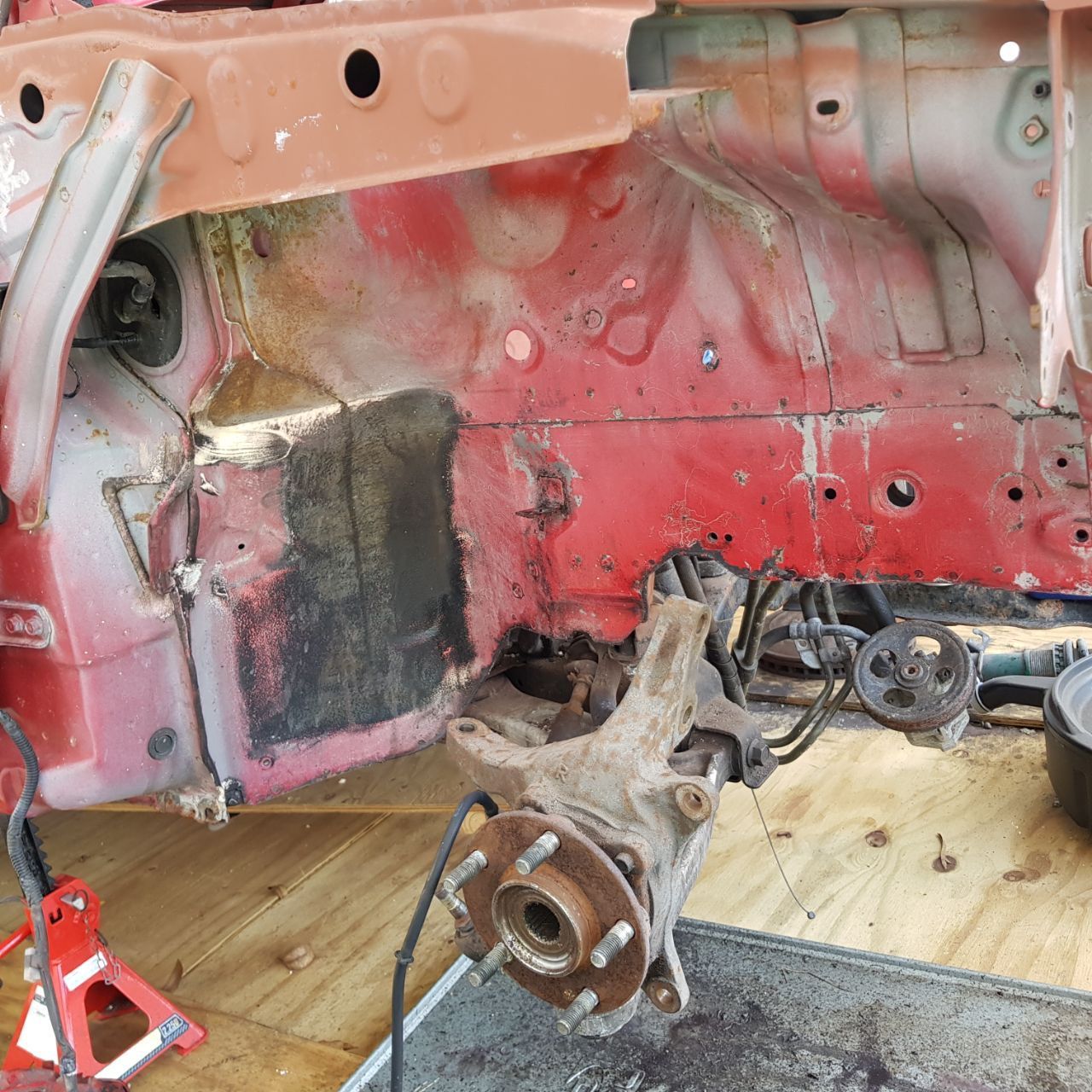

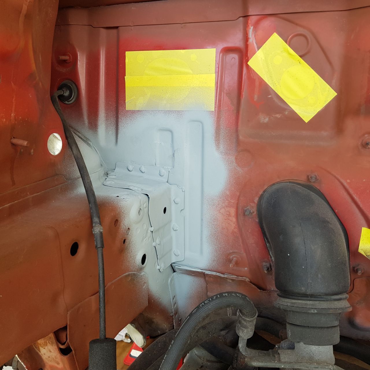

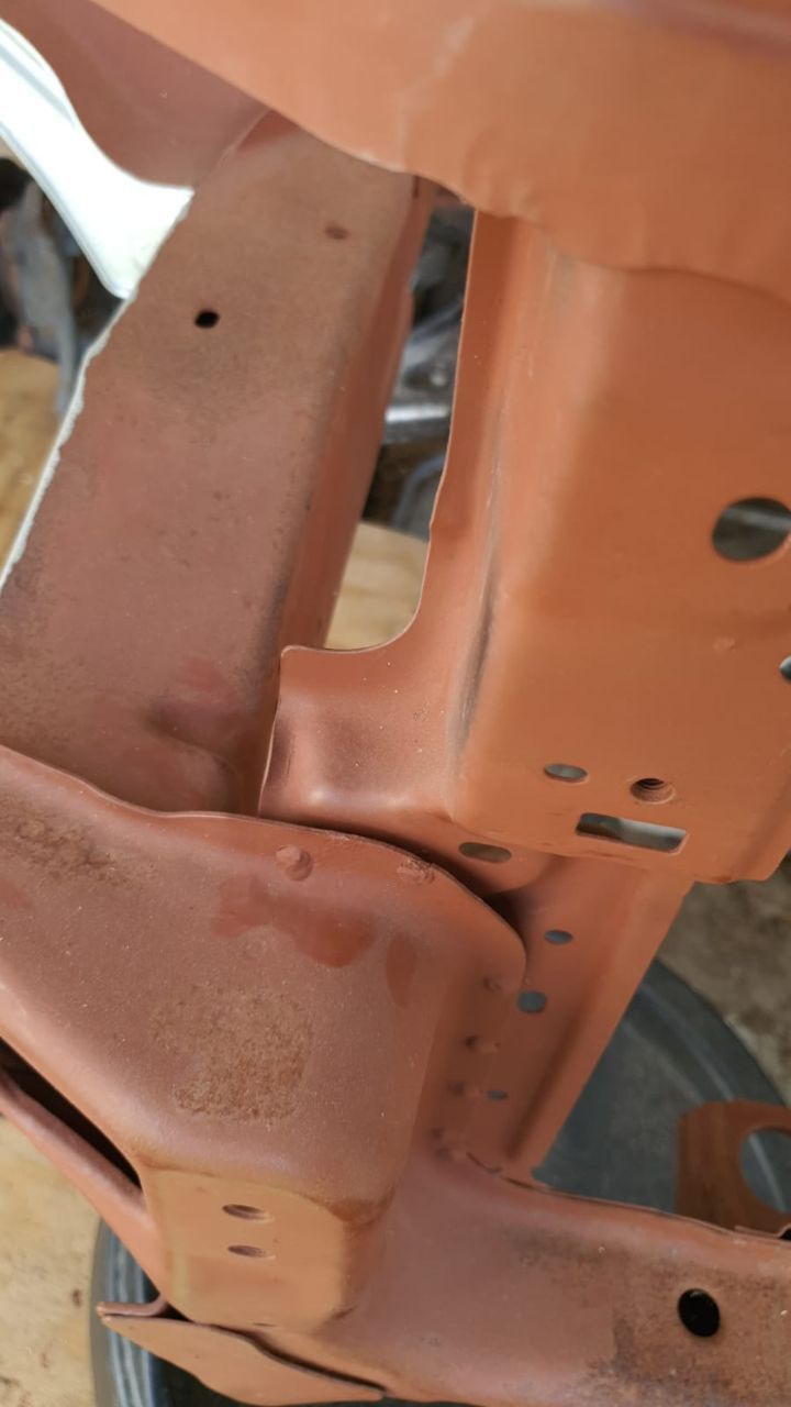

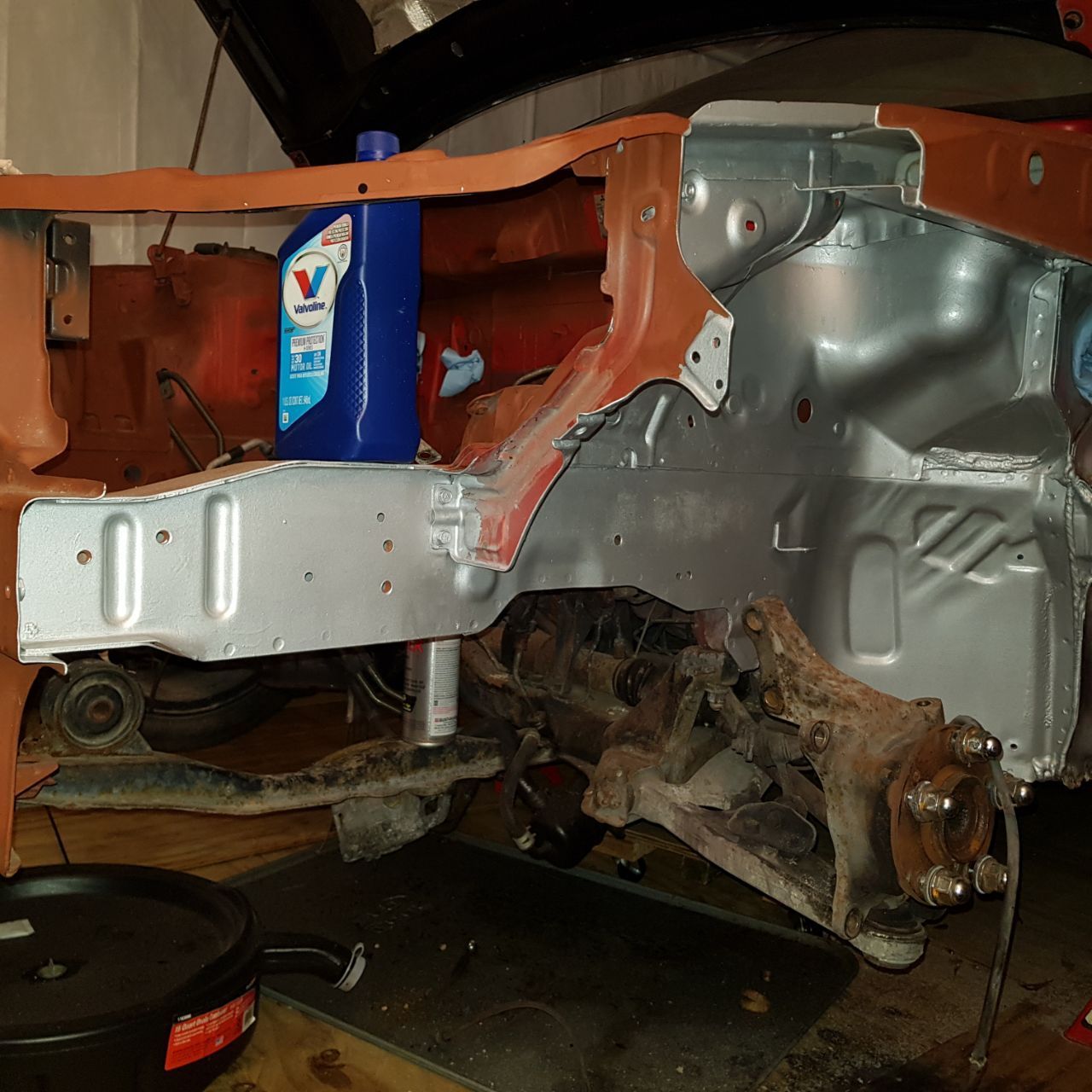

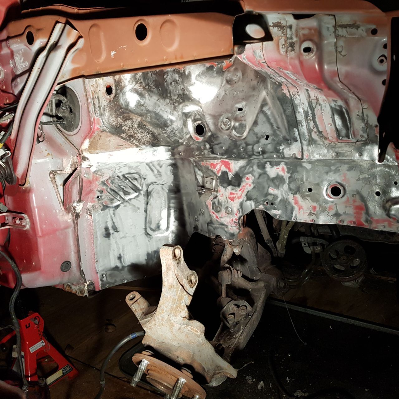

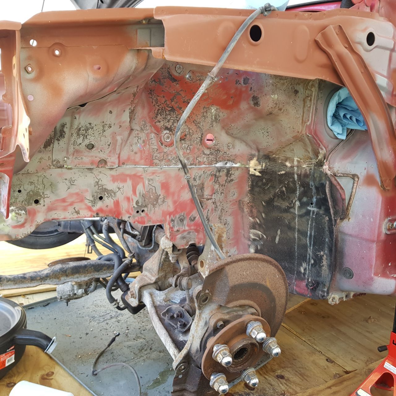

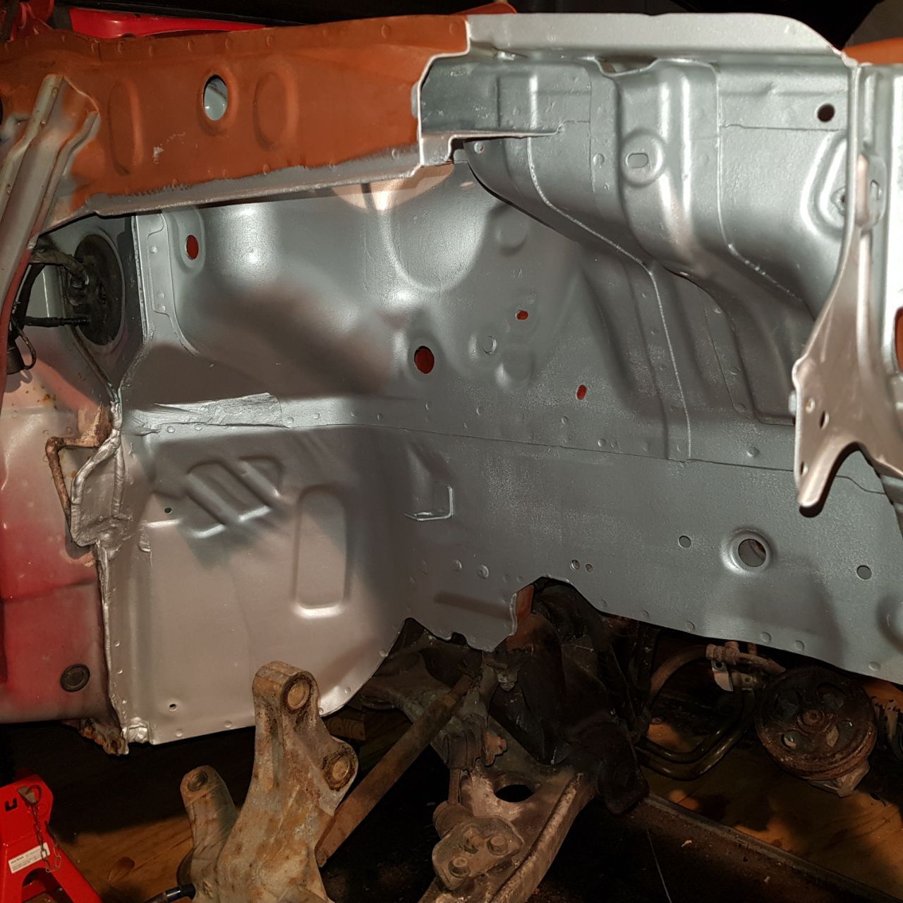

As I'm prepping the car for the body shop, I dis-assembled the front wheel wells and got to work, I went to town with some wire wheels and grinder to knock down the rust as much as possible. It's surprising to see how much rust is actually under the OEM paint.
Primed the wheel welds with Rustlok Steel Primer 6980 https://pettitpaint.com/products/pri...-steel-primer/. I have to do a few more coats, but once that's done its going to get covered with Bondo Rubberized Undercoating https://www.3m.com/3M/en_US/company-...2638287&rt=rud. Once that's cured, all the old parts will go back on so the car can head off to the shop to finally be worked on and painted.

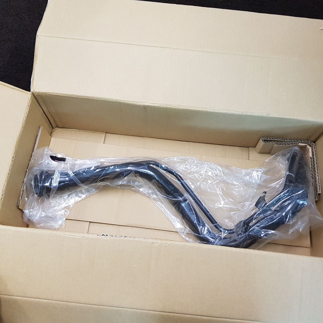

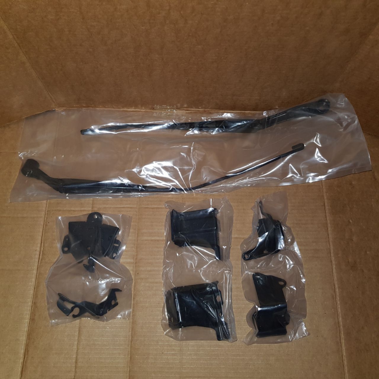

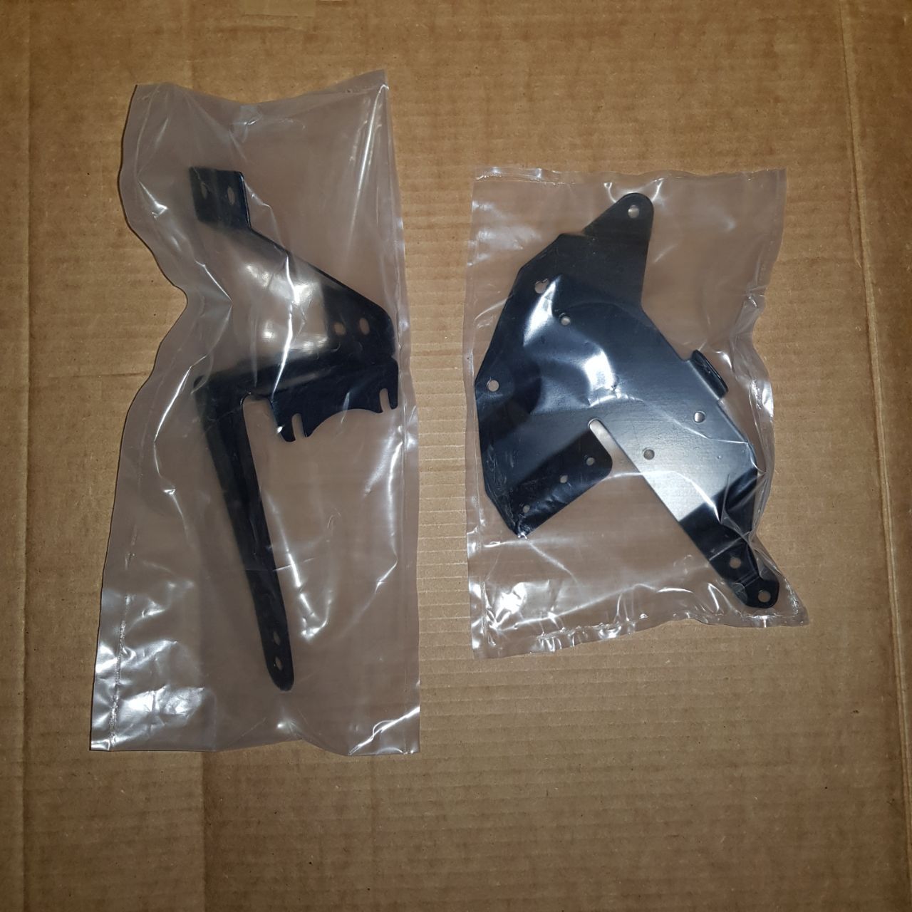

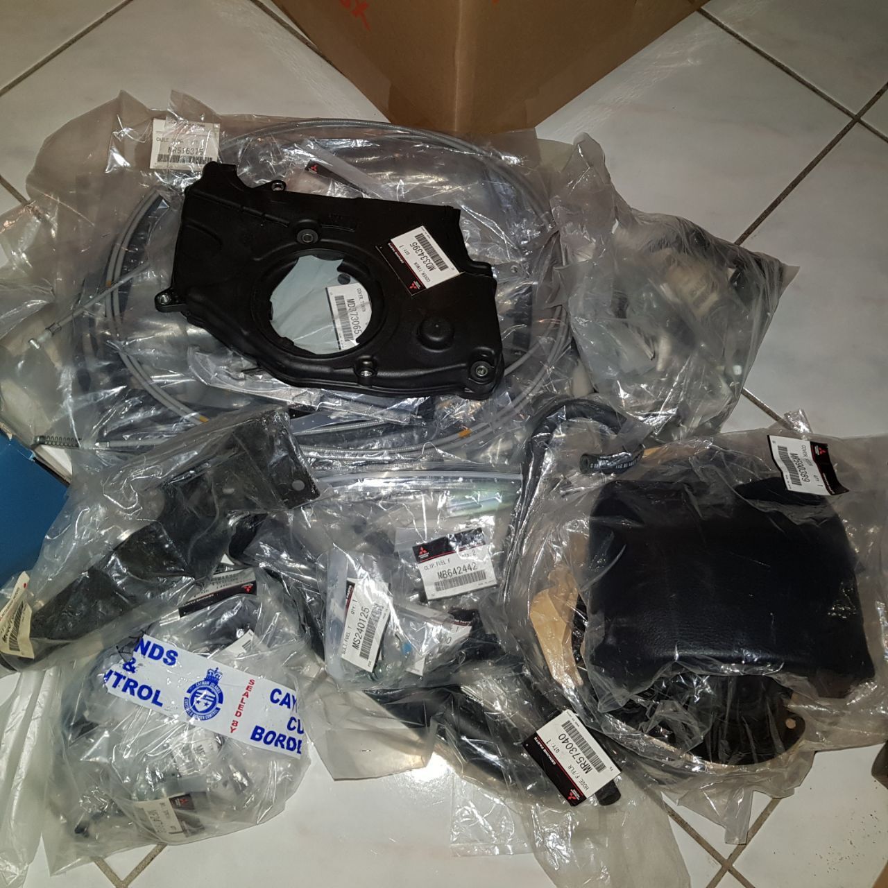

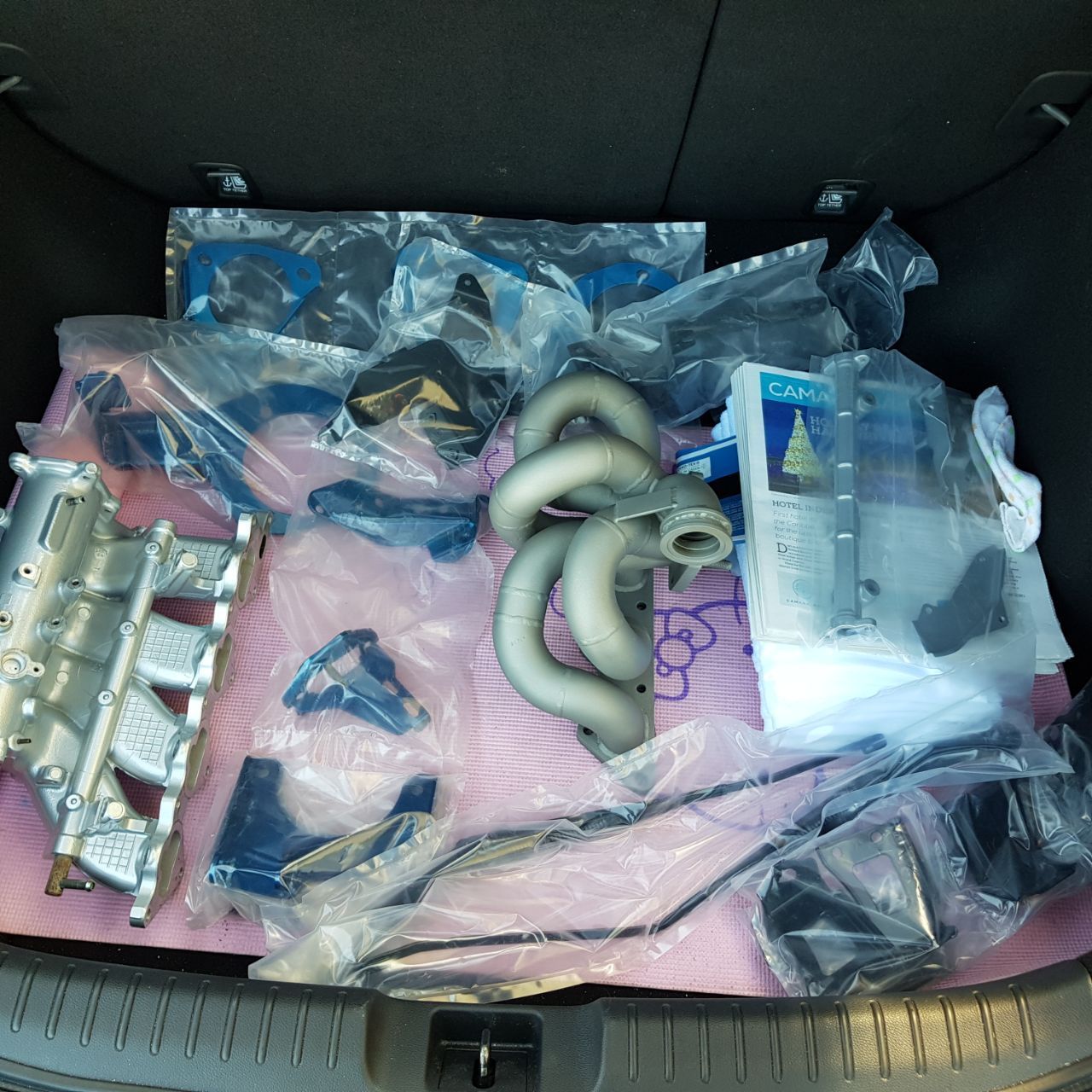

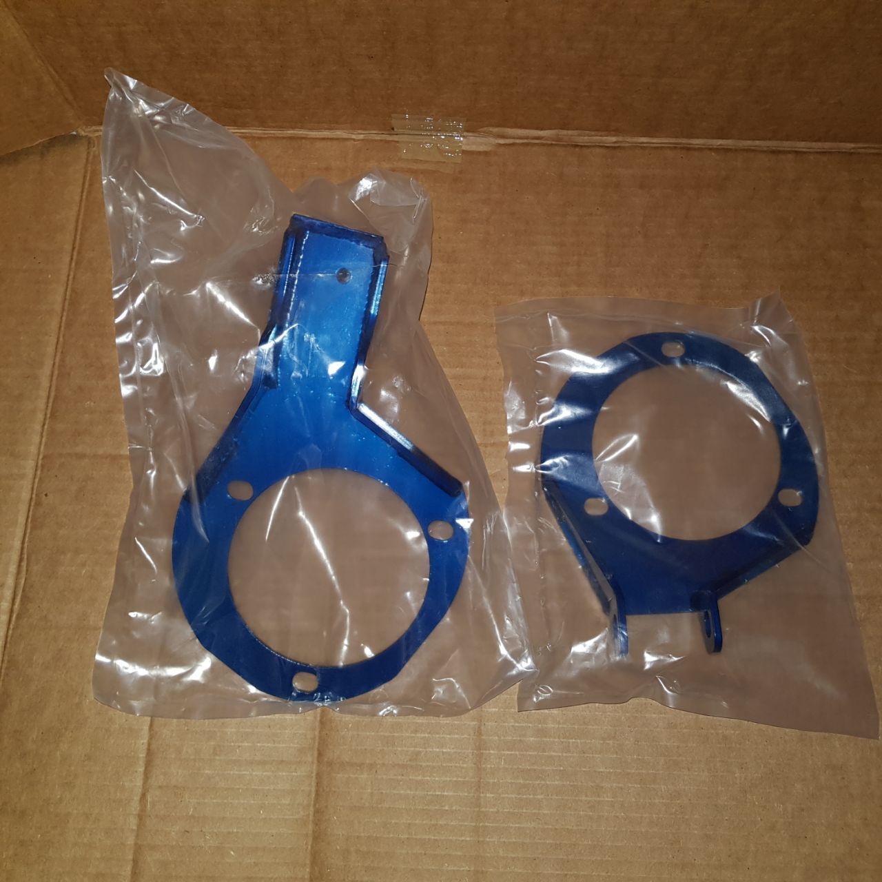

What's an update without new parts

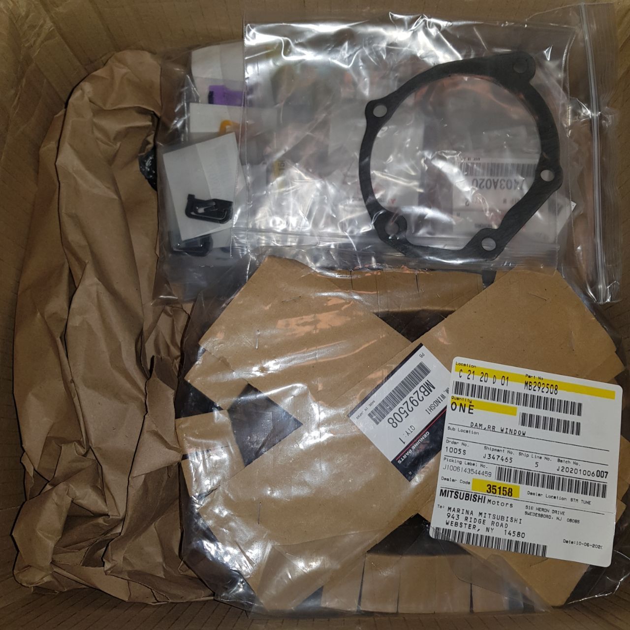

Finally got my order that I made in May 2020 along with my September order from STM. Both companies were backed up due to Covid, but they sure did their best to get the parts I order off to me.

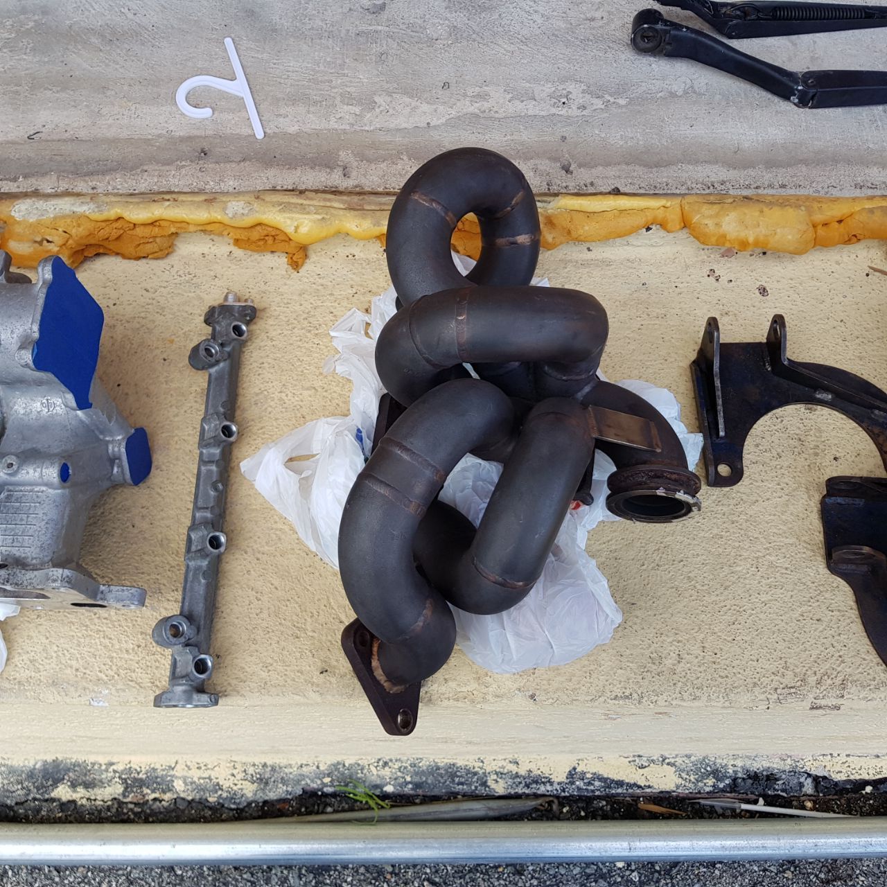

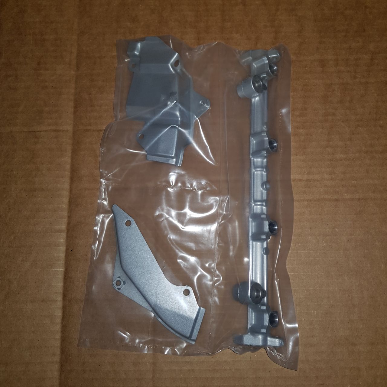

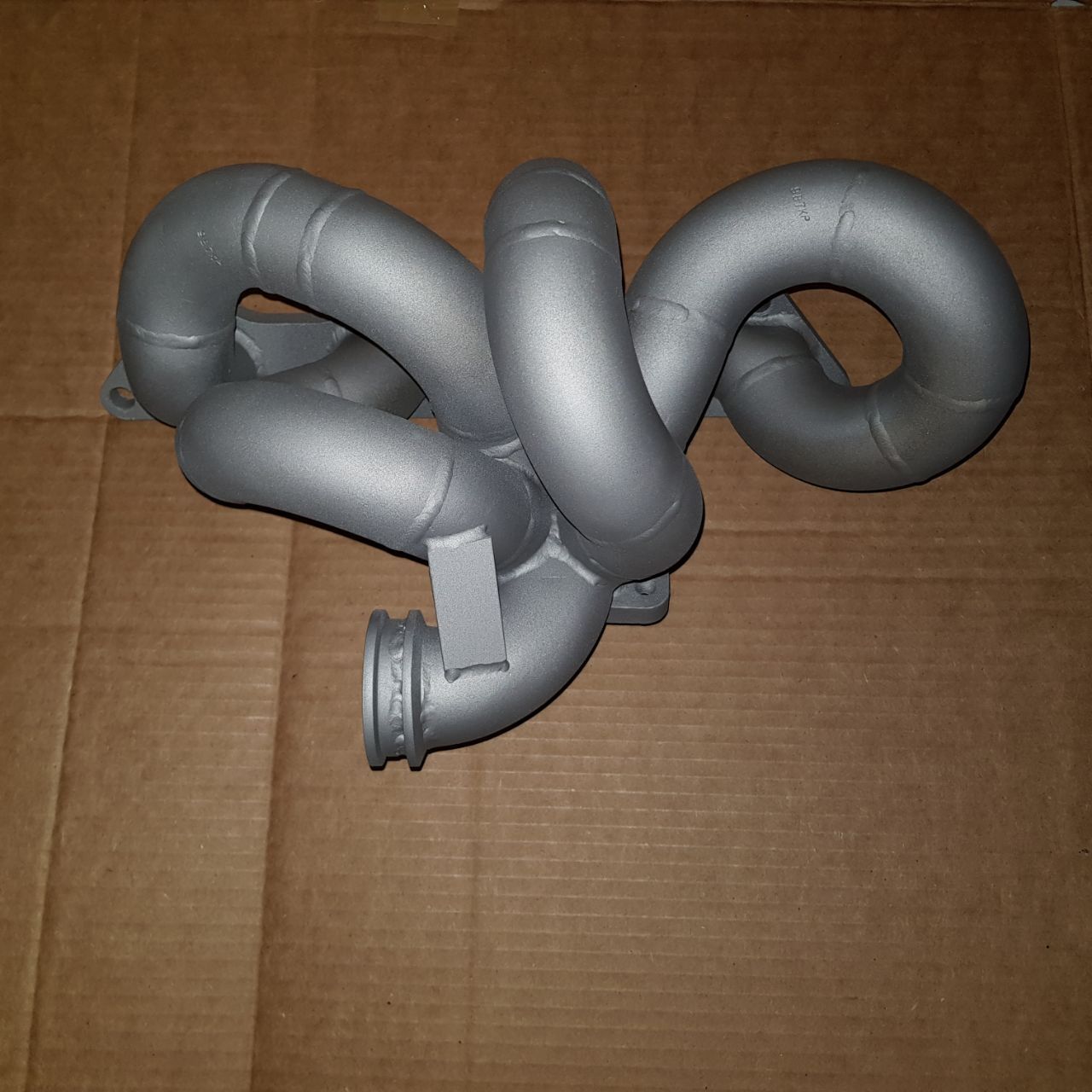

Last but not least, I also made the push to get some parts that I'm reusing Powder Coated and Ceramic Coated. Wish I could do the entire car lol.
The Before...
The After...
It's all slowly coming together. I'm just hoping and praying to have the car back on the road by mid 2021.
There's a few more things in the pipeline on the way, but we'll have to wait until they reach

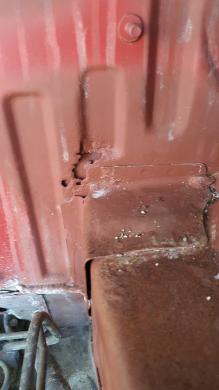

Well... Fingers crossed, a friend of mine is going to stop by this weekend to take care of the rust spots in the bay.

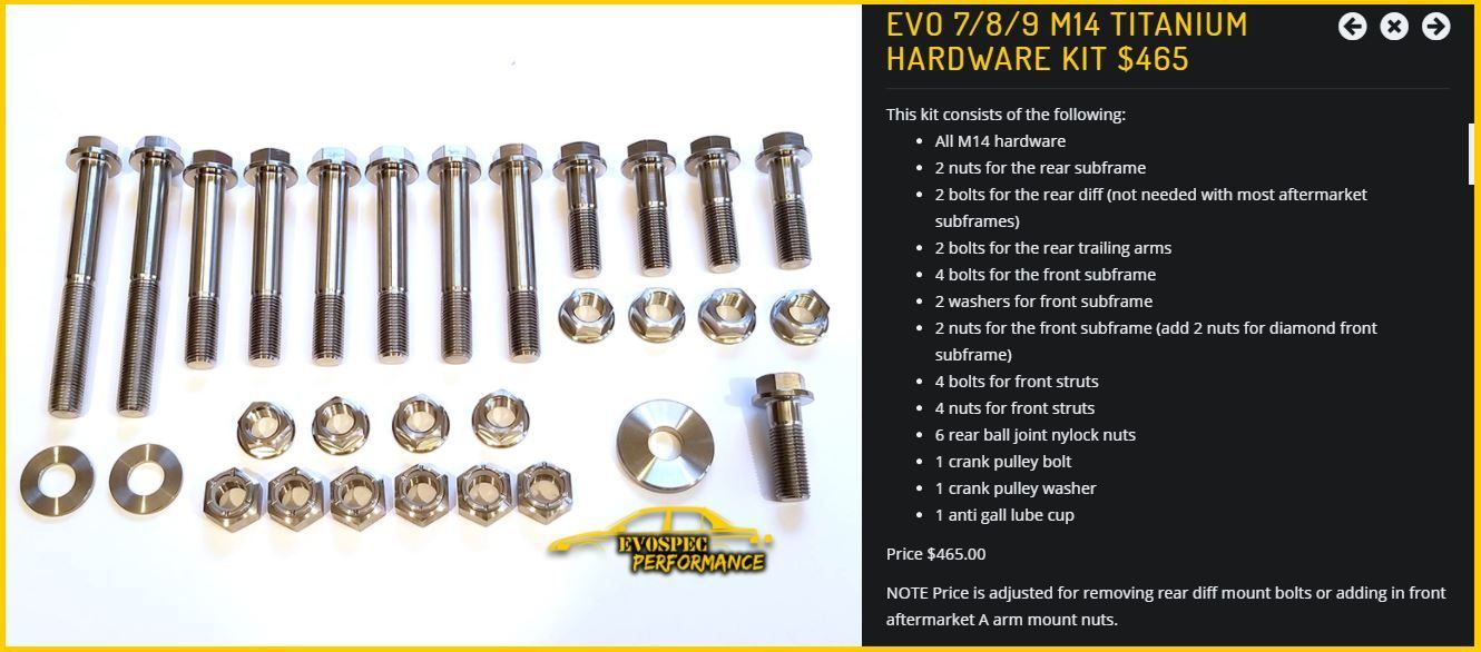

Soooo. I've been doing some research on strength. Ti vs OEM bolts.
Our cars come with different grade bolts for majority of the stuff that doesn't have a lot of stress. So Ti bolts for dress up parts are not an issue.
Anthing that's load bearing or under tension, it's usually recommended to use OEM bolts or equivalent.
I don't want to be the guy that knocks on all the Ti suppliers out there, so in a nutshell, I'll just say I'll be replacing my rusty stuff with OEM bolts.

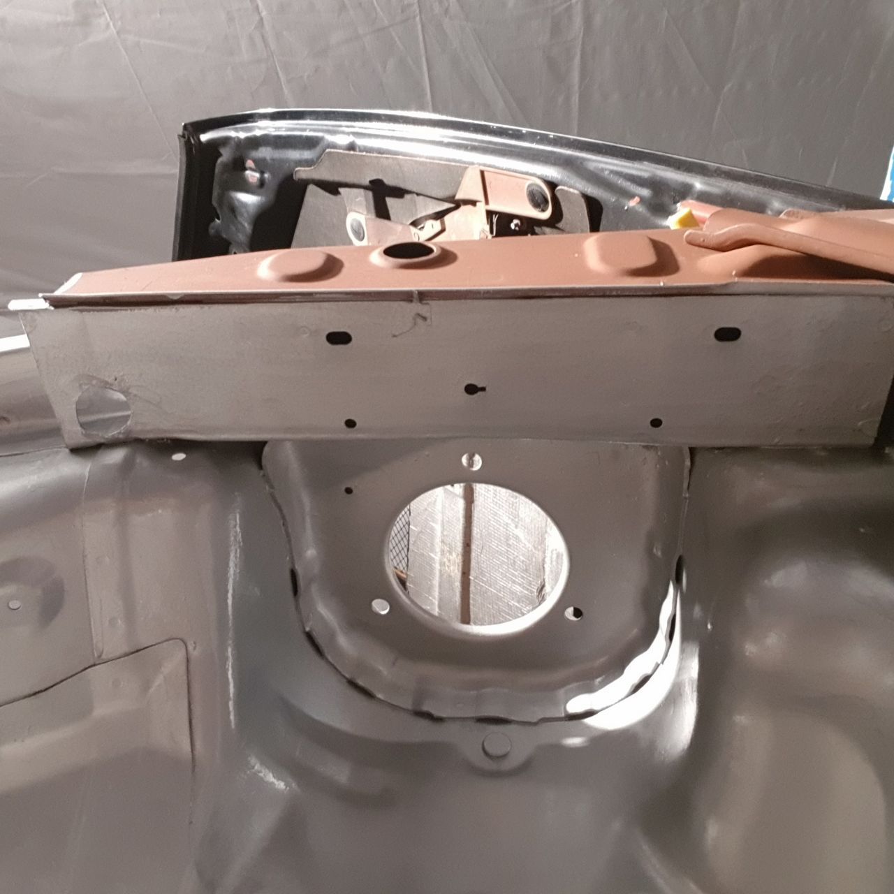

As promised .2 weekends ago, my buddy showed up to take care of the welding that needed tending to.
Now for the pictures: Please note that the following pics are the before and after of each area that got repaired.
This weekend. Another friend of mine hooked me up with his Body & Paint guy. So he stopped by over the weekend to take a look at the car.
It's about time, but I think I can comfortably say, we might see this thing go into the shop as early as the next two weeks I should have some samples to share in a few days as well.

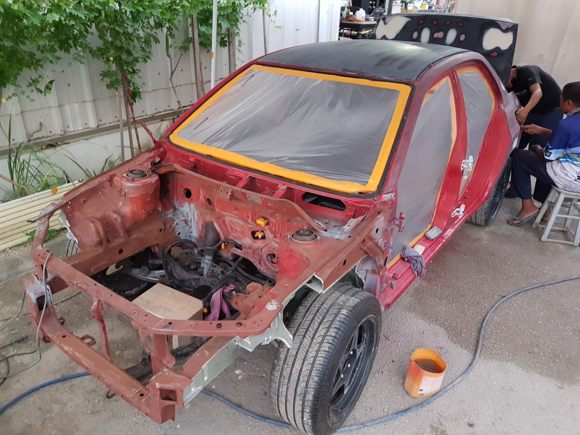

Update Time! Nov 24th, 2021
Hoping you all are in good health, it's been a while. Lets keep this one short and sweet.

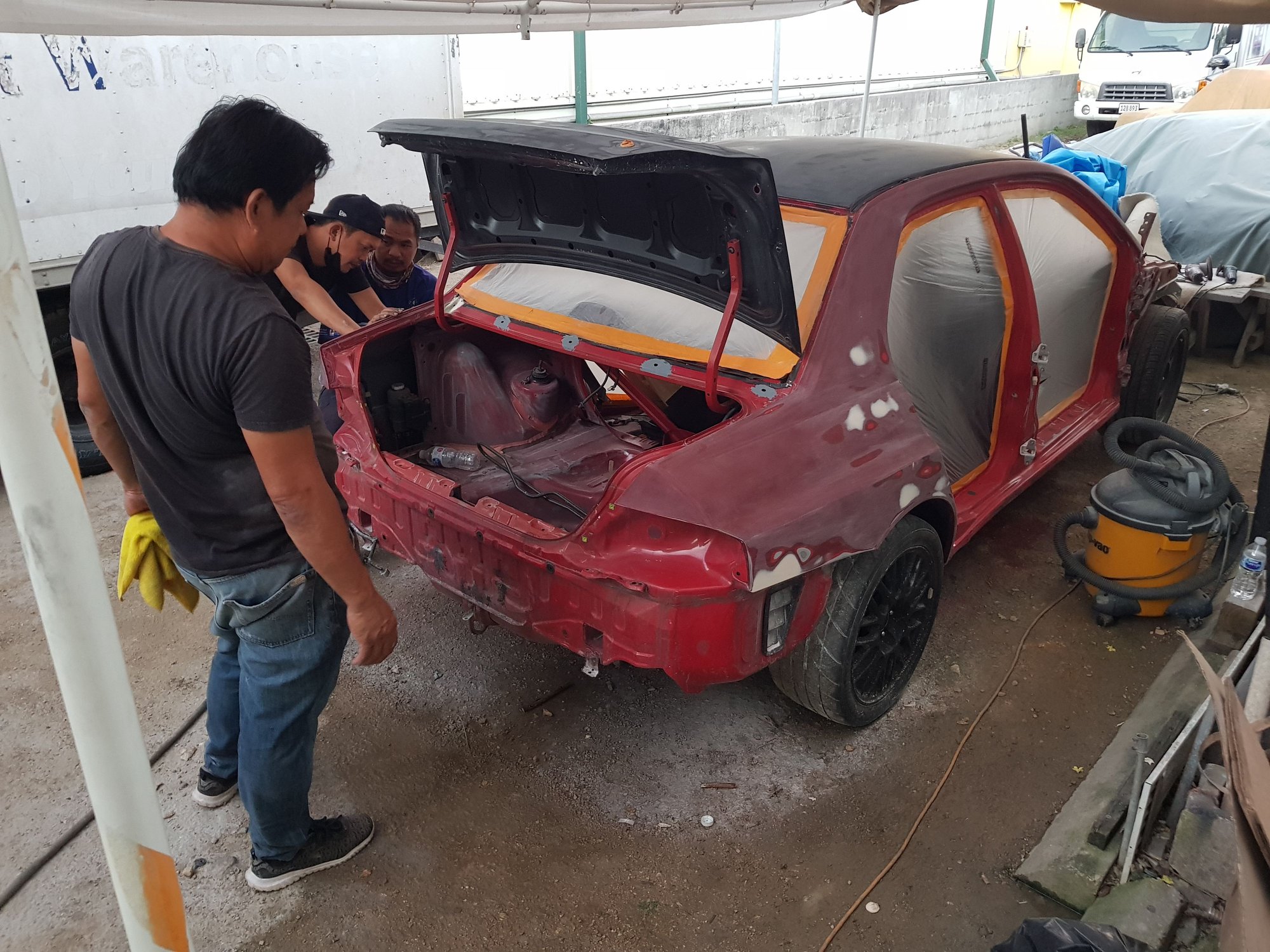

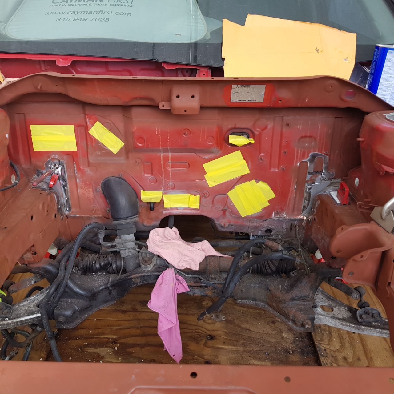

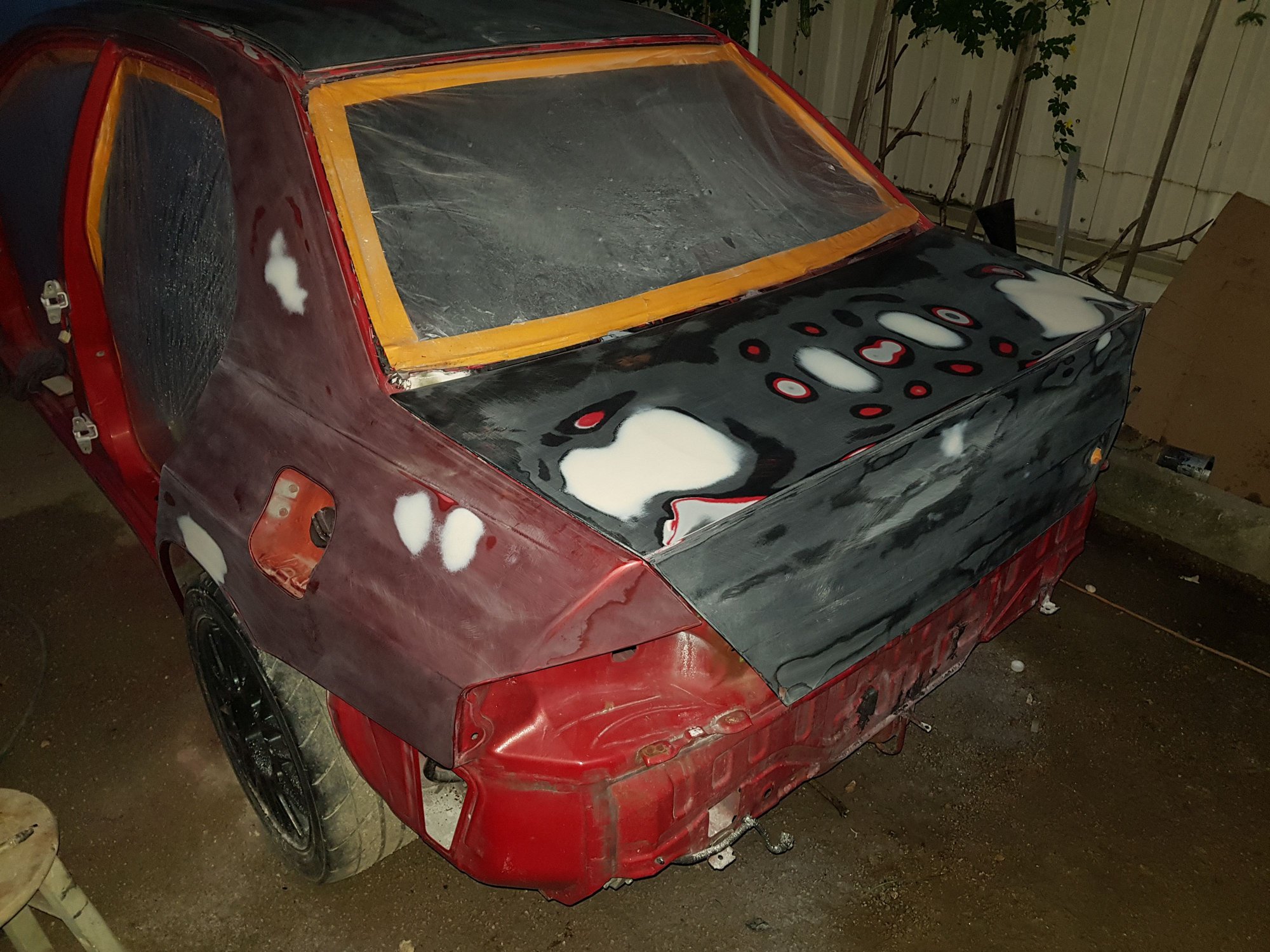

The car is officially at the Paint & Body Shop!
But, with happiness; there is also sadness. Made a slight change with the color. It's still going to be Orange, but just a more appealing shade in my honest opinion.
The car is currently prepped for base coat (sanded and taped off), but the crew ran out of the clear coat flake; and more importantly; the clear coat.
So we’re currently awaiting for that to arrive on Island to get things going.
I plan to go there this week, so hopefully we get some more progress updates.
The car needs to be repositioned so that I can drop the front subframe. Planning to have it sand blasted and coated with some POR15 for that nice gloss black finish, with the added protection.
Now that, that’s all out there; here’s some pictures from tow day to prep day.
All washed up.
Def. not impressed lol.
All loaded up.
Stripped down and neked.
Sanded and prepped for primer.

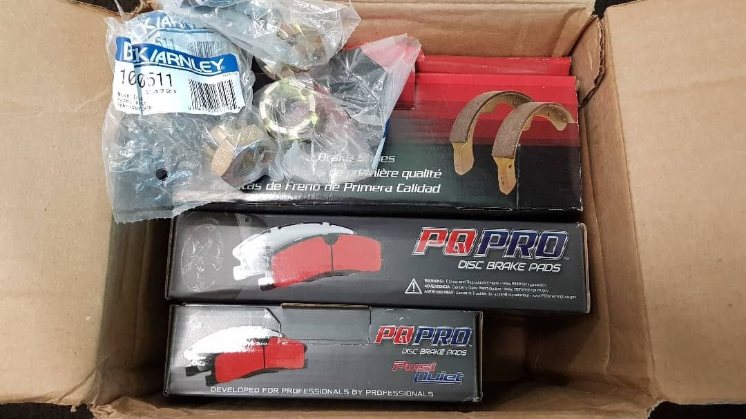

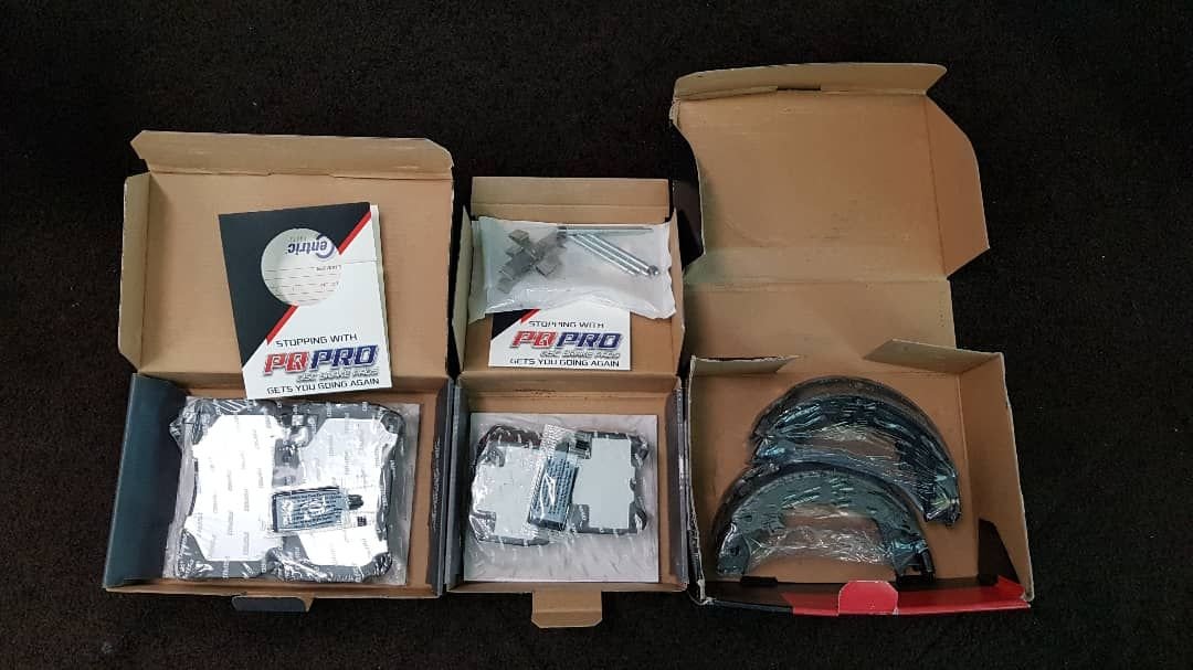

New spindles nuts, pads & shoes.
Part Numbers.
New Centric Posi Quiet Pro Brake Pads with Centric E-brake shoes and hardware kit.

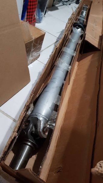

Driveshaft Shop Aluminum Driveshaft for AYC models.
