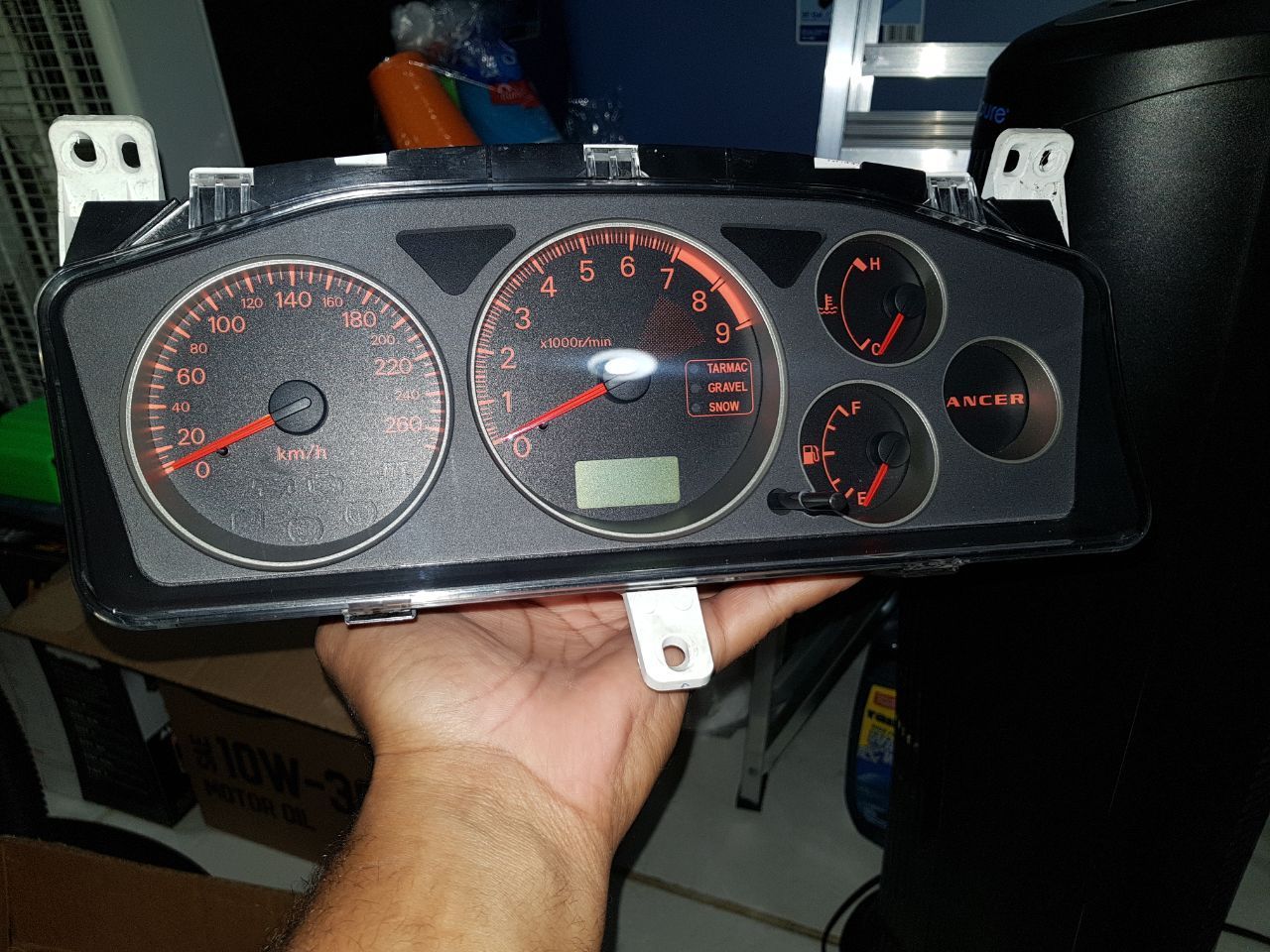

I'm leaning towards a bad cluster at this point, as all of these were working previously, and the harness was taken out and kept indoors while the car was under the knife, so it's not water damage. Also, while re-wrapping the harness, I was diligent to not cut into any wires.
If anyone has any insight on that, please share.
So with that said, I have a new to me Evo 9 GT gauge cluster on the way.

In other good news. I got my new Gauge Cluster.
Out of the box.
After some sanding and polishing.
Installed.
