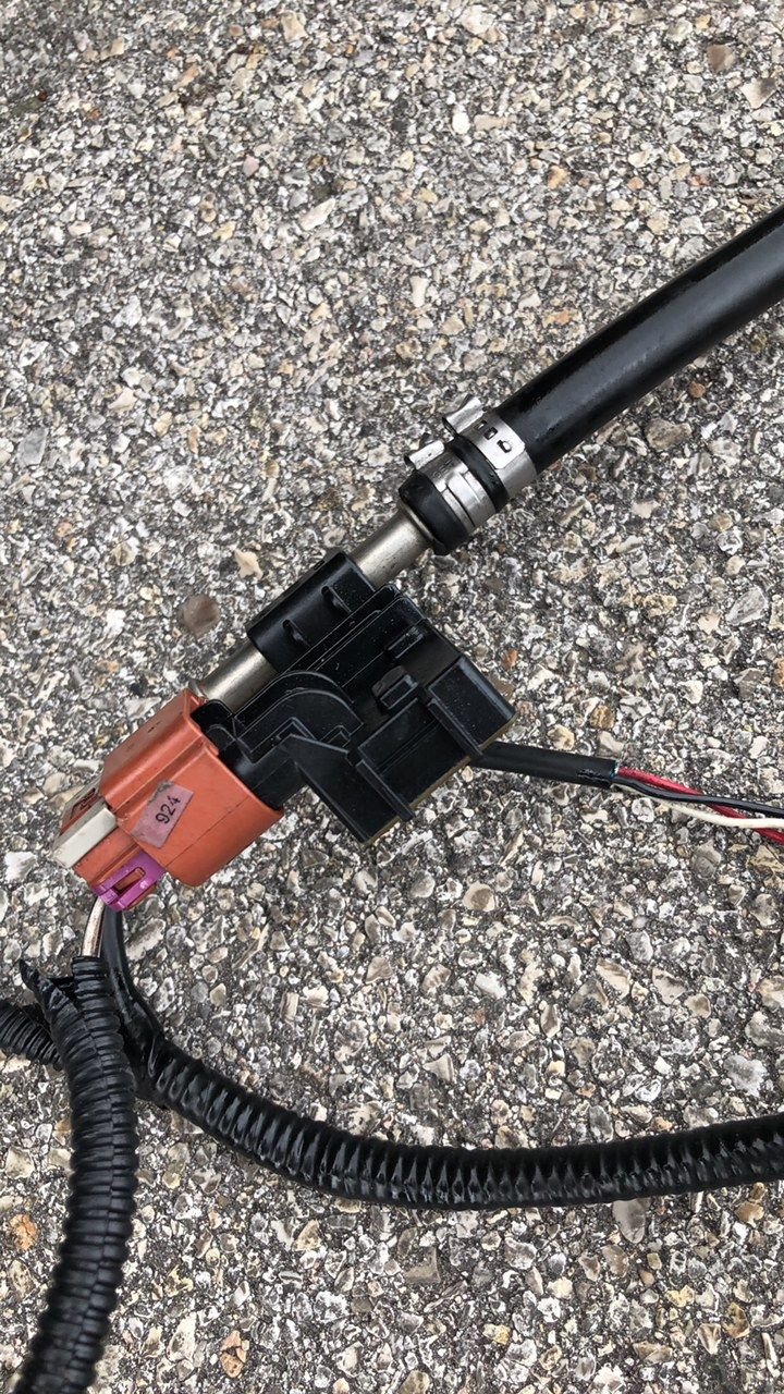

subscribed. I got a flex fuel sensor and harness etc if interested

cant sent pics in messages, came of an evo also

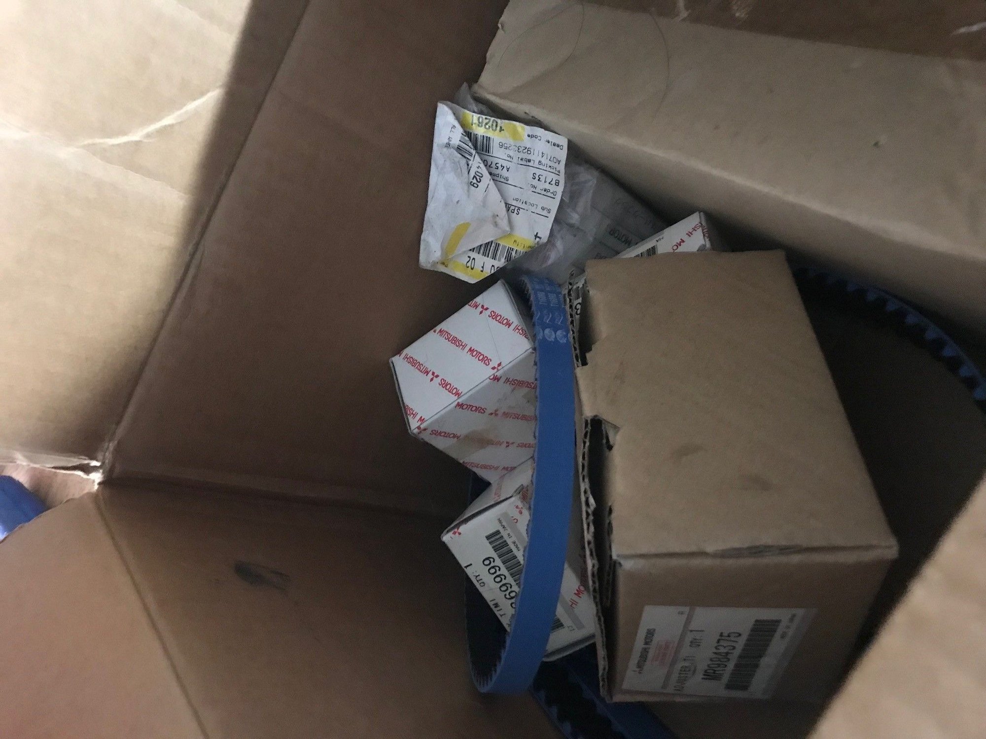

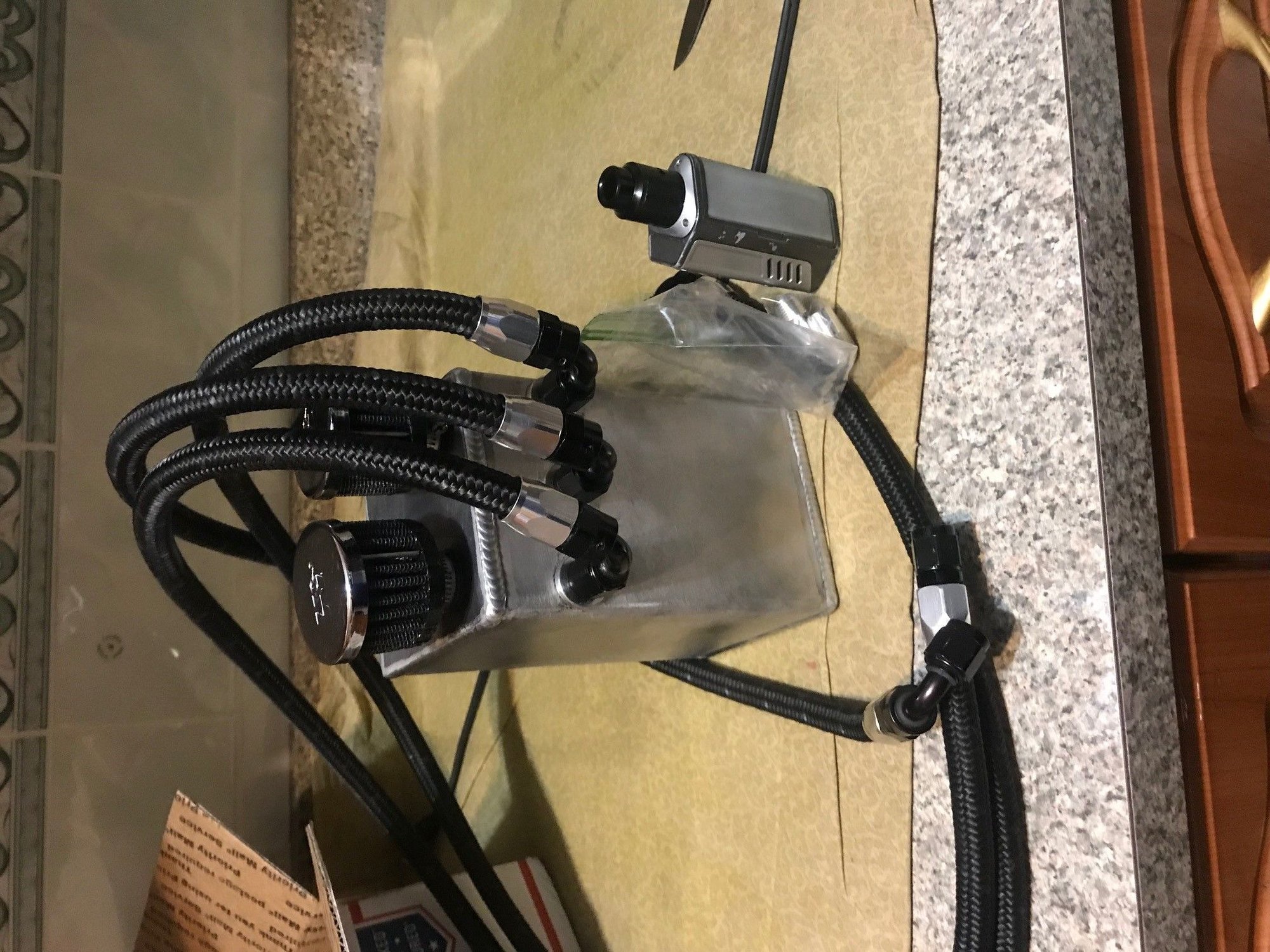

Updated, STM Catch can and timing goodies came in.
I miss driving her

very nice ill look at that catch can I need one too
