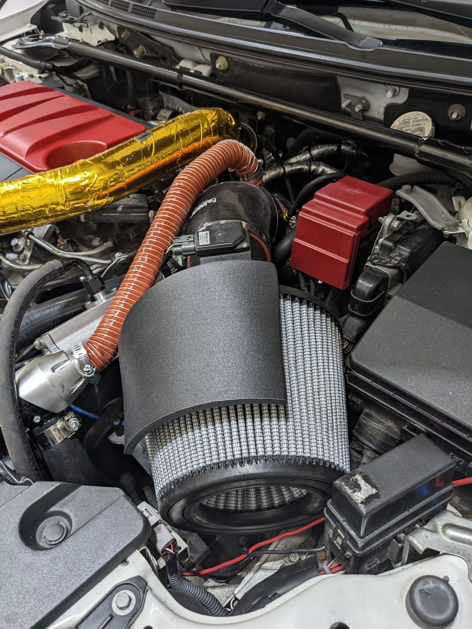

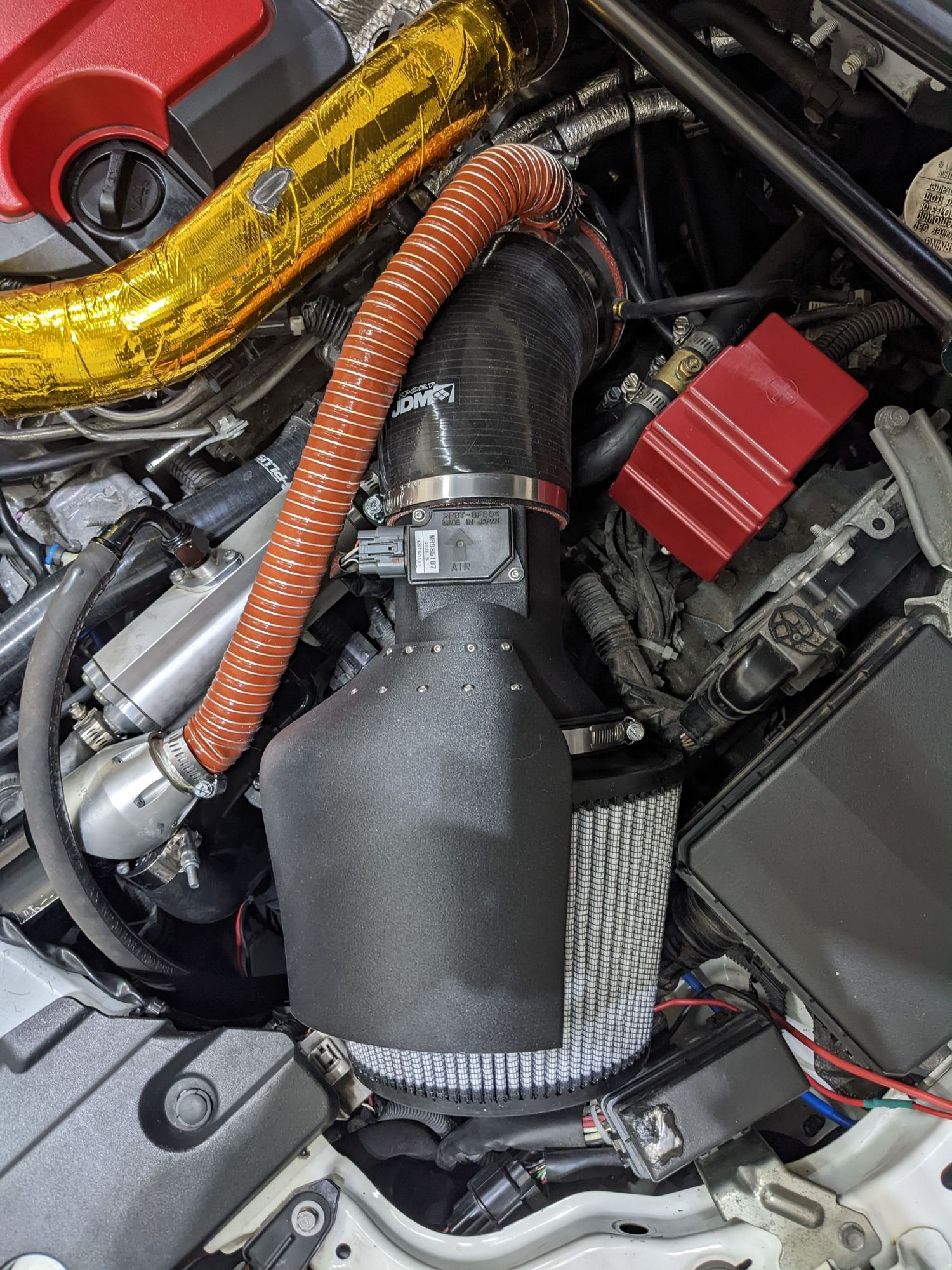

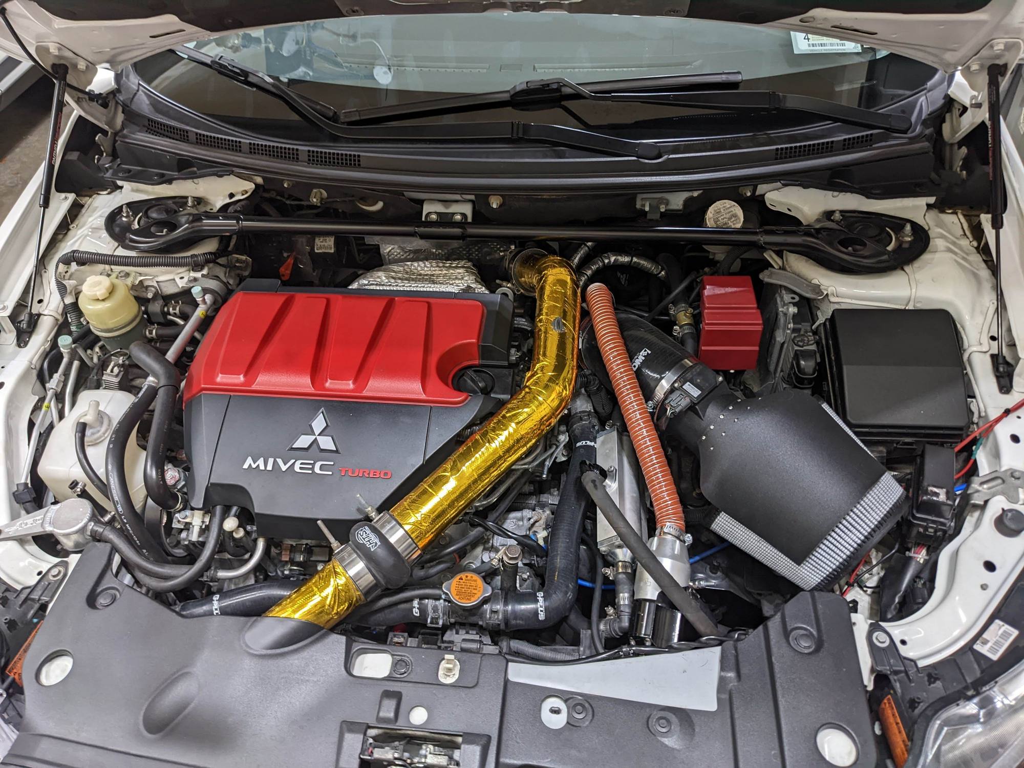

Couldn't take the print brim, so removed it.... Based on the photos I think I am ok for rain intrusion. I think it came out pretty sweet. Certainly sounds amazing...

Love the custom bits for sure. Any specific reason for PP-CF over PA(6 or 12)-CF or PC-CF?
I need to print a custom intake and thinking of going with nylon-cf over my normal ASA Ive been using.

So got some great questions from you guys, and I want to answer each.
1.) Why PP-CF over PA(6 or 12)-CF or PC-CF?
It is the CHEAPEST at about $80/750g (which by actual printable material is about 1kg of ABS) that also meets the strength and temperature requirements. I could have used ASA, or PC-ASA which I have in stock but not in black. The plus side is that it DOES NOT absorb water from the air, at all. So, there is wrestling with moisture creep and drying the filament. Lastly the 2nd pipe piece connects to the BOV, and EBC, but most critically it connects to the VALVE COVER where motor oil will be coming in contact. The material is FANTASTIC with an A-1 Excellent rating in contact with motor oil.
The compatibility chart is HERE
2.) Video link provided and mentions of Victrex AM 200 material as suitable for the automotive environment.
PEEK is a serious material for sure, but overkill for an intake. The price for 1kg roll is $595 !!! located HERE
The more serious the material, the higher the cost!
3.) What 3D printer are you using to do this?
The printer I am using to make this is not available off the shelf. It was born a QIDI I-Mates and has been reflashed with custom code and the entire extruder has been changed out with a high temp hot end (Phaetus Dragon) with different extruder motor (lighter - ldo orbiter 1.5) and rides on aluminum rods (lighter). With all this lightness comes speed, as I print at 100mm/s with PETG and ABS. I have two other printers, and the fourth being constructed now CAN be bought and is a rat-rig vcore3 available HERE And that unit is also enclosed and is sized at 400mm ^3 which is quite big. The KIT cost me over $2.1k and I have hardly had time to get it built as of yet. The entire dining room table has been taken over with a parts spread.

sized at 400mm ^3
Ahh, cool. Thats answers what I was curious about. The nylon or PC would both definitely need drying before use and the material fed within the heated enclosure (this is what I do). PP sounds interesting from that standpoint. Ease of use is always a huge perk.
And 400mm^3 is tiny, Like 7.5mm on each edge... lol. Im guessing units not right?
My Lulzbot Taz5 (circa 2017) is 10" (x) x 12" (y) x 12" (z) that I put in a basic ender based enclosure and use an extra light plus the heated bed and main element to create the heated enclosure. It gets to around 50-60c, not crazy hot but certainly better than no enclosure.

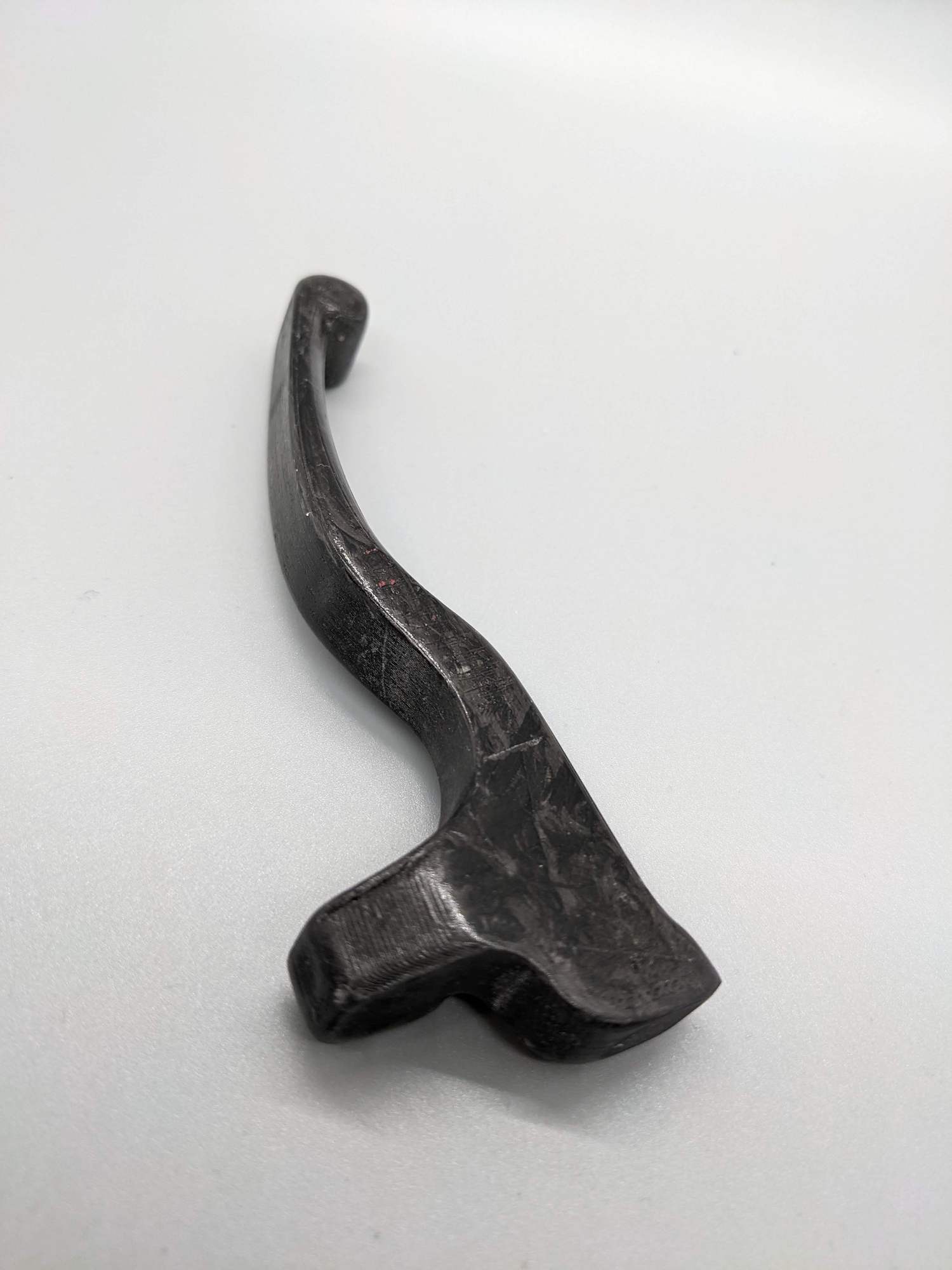

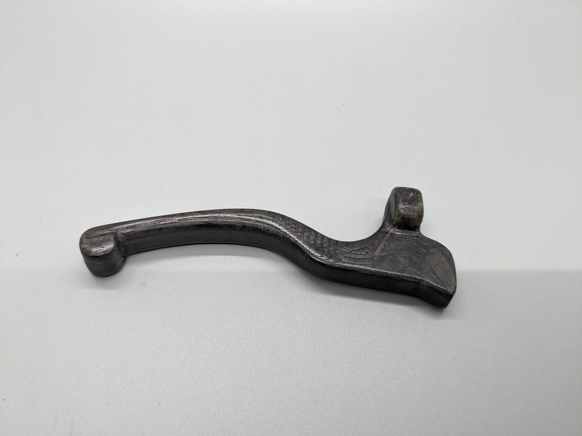

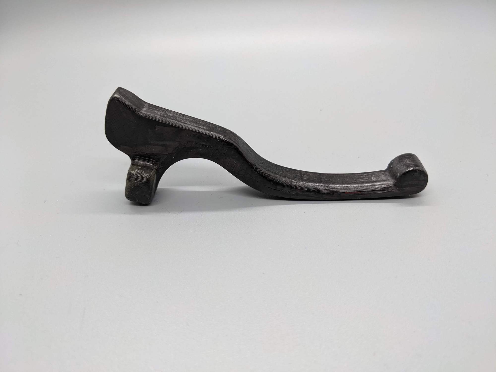

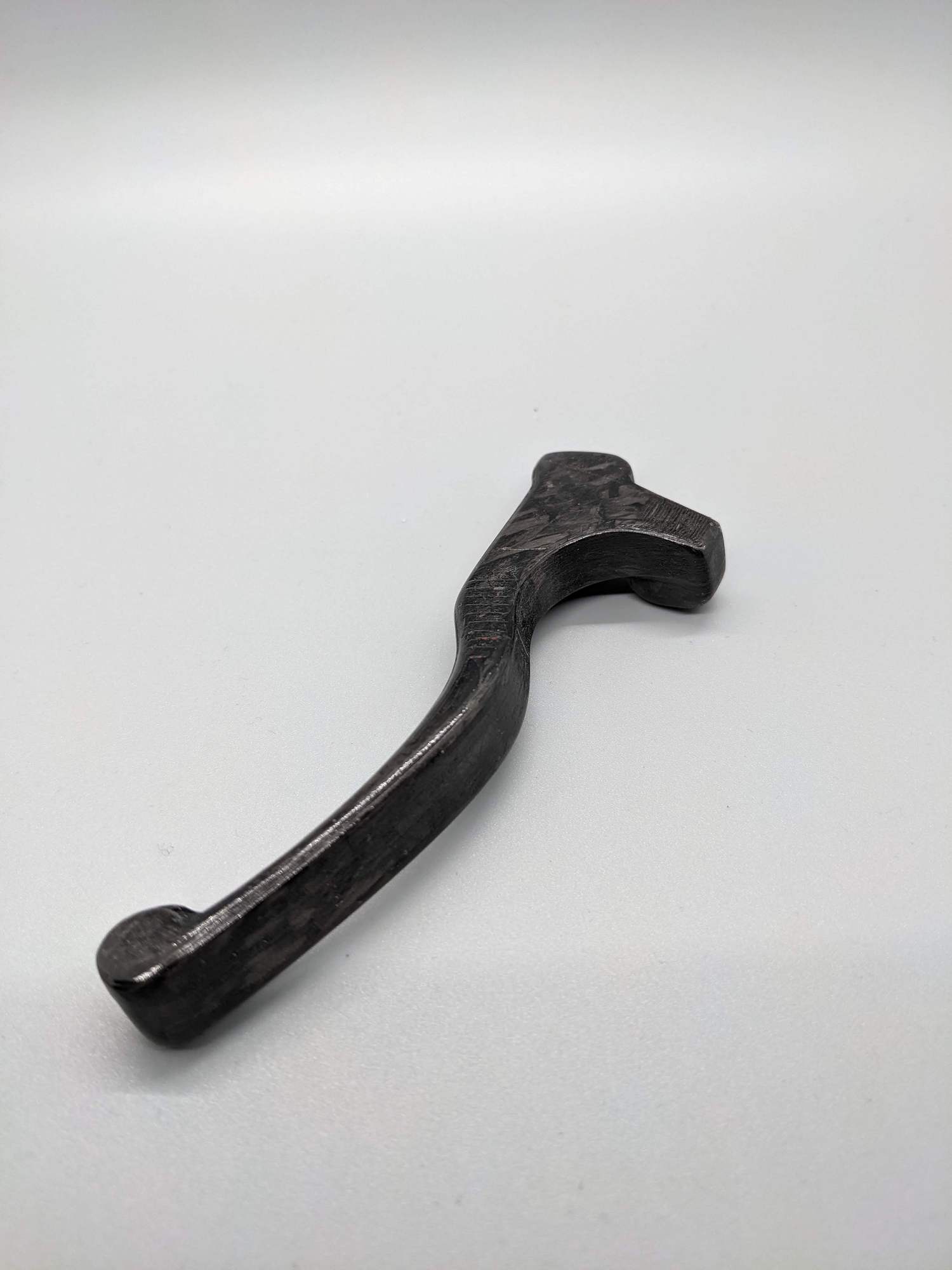

So I've started to dabble in FORGED CARBON FIBER, which I think is just simply amazing.
Half the weight of aluminum and as strong or stronger than titanium! Lamborghini trademarked the name of it in 2013 or so, and it allows much easier construction of carbon based parts, and also with more complex three dimensional shapes. I'm thinking of replacing my strut bar with a custom one made from this! I just received my two 6061 12"x12"x0.25" plates for compression of a mould that size.
Started by making an EXAMPLE brake lever. With a detailed inspection I see I didn't get carbon into a deeper part of the mold, but overall it went well. The printer that makes the moulds was also not set to optimum layer height (or even a nozzle switch out to 0.2mm). So you do see layer lines in the final part from the 3d printed PETG mould (three piece design).
Old Oct 21, 2022 | 06:34 AM
  #253
RobbieOh's Avatar
5 Year Member
Joined: Feb 2021
Posts: 704
Likes: 205
From: NSB, FL
Now that is really somethin!
Edit: I would love some hood vents in that forged carbon for the X
