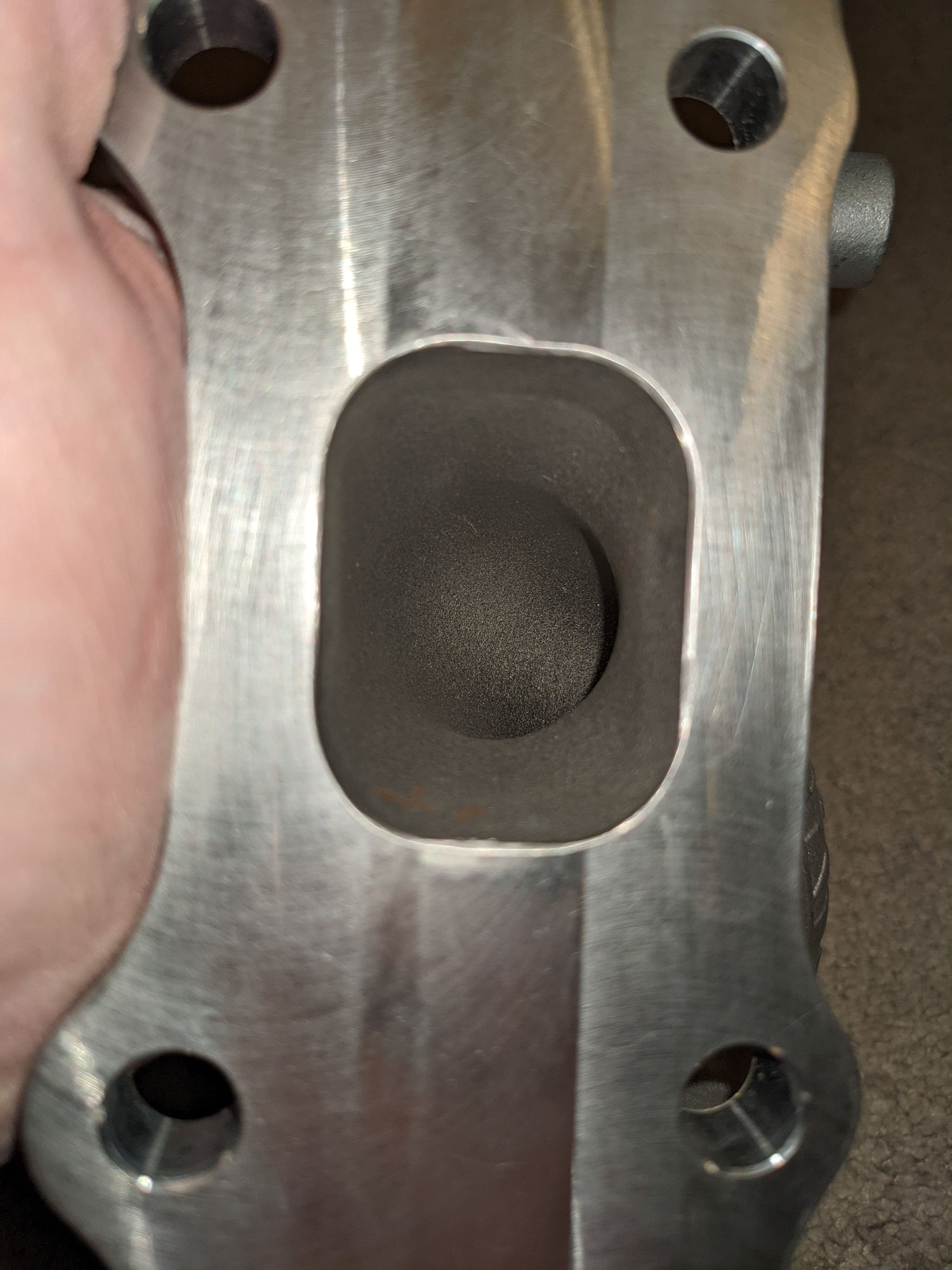

The ARTEC manifold is in (well the closet that is), and it is something else. I will upload some close up pics, because the casting is pure art (compared to the MAP which was internally quite rough).

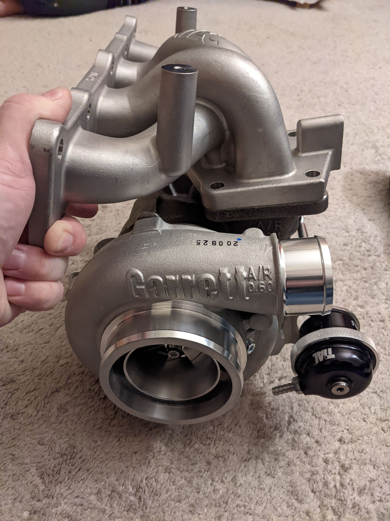

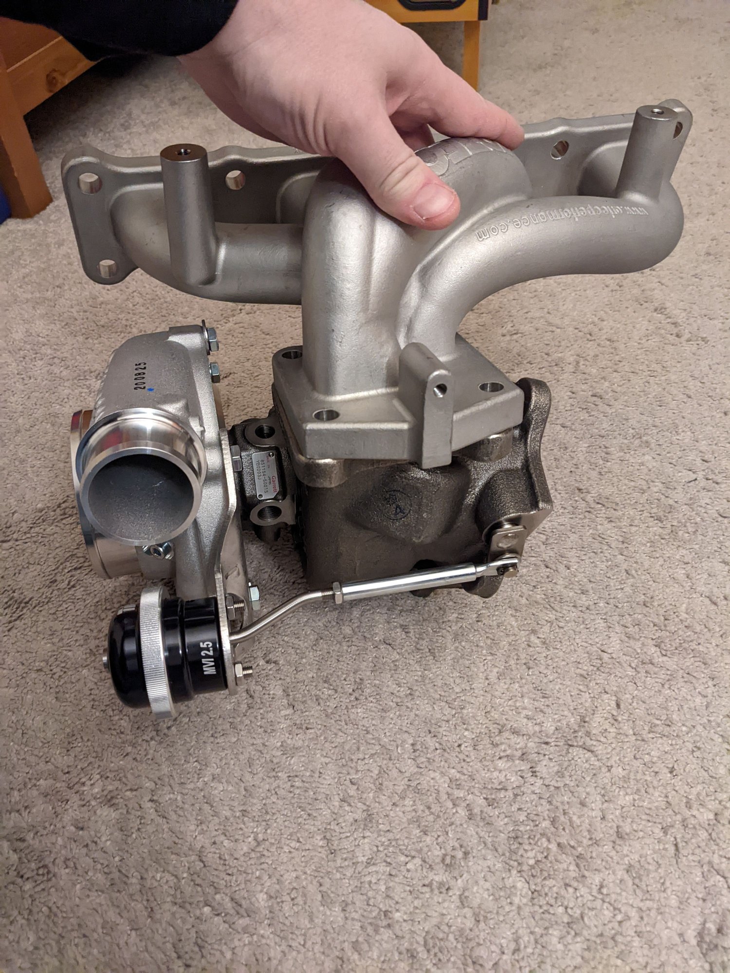

Here is the ARTEC manifold. I requested a quote from a business for Inconel shielding and they came back with $640 for the turbine housing and $799 for the turbo manifold.
That seems high to me, but I have never paid for that type of service.

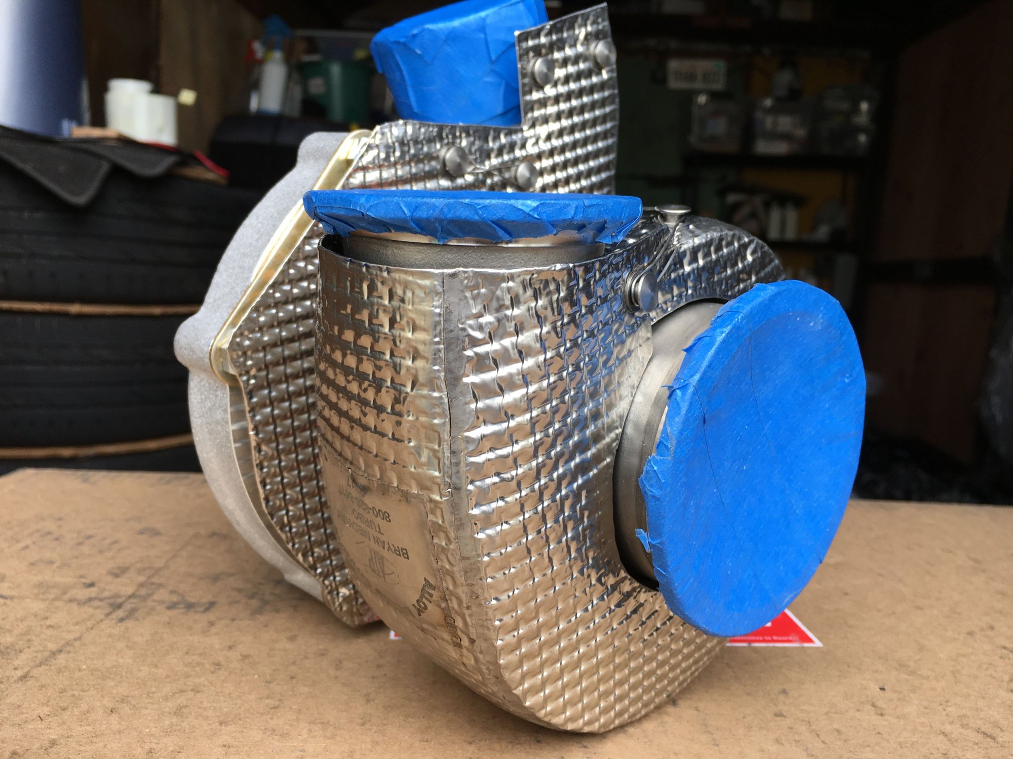

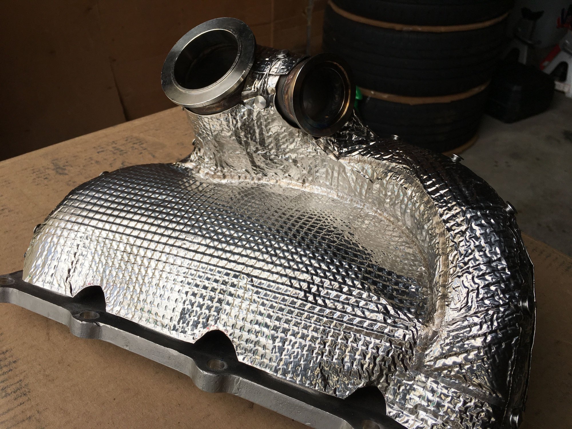

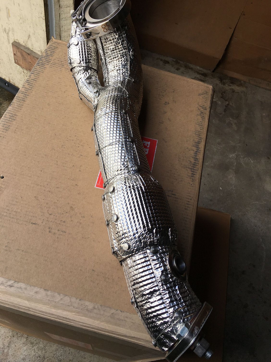

For reference, here is what I paid for my Inconel shielding back in 2017, but everything is more expensive now...
Since it looks like that manifold has mounts for the OEM heat shield, why not just use that for the manifold?

The stock shield doesn't stop the heat from hitting the compressor housing at all. It only protects the engine bay. A lot of heat (and thus power) is lost through compressor housing heat absorption.
The same shop you used just quoted me:TURBO SHIELD = $ 375.00
MANIFOLD SHIELD = $ 388.00

So I bought some of the Inconel material that they use (and it comes with Inconel wire). I will just protect the runner closest to the compressor housing, and then use the OEM shield on top of that. I really just want to cut down on what gets absorbed by the compressor side.
They do look like they perform great work though!
