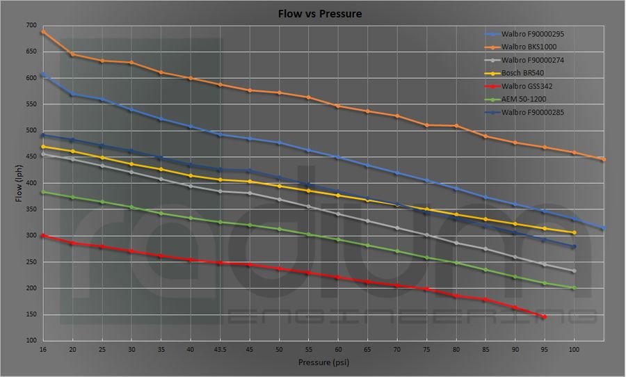

Flow rate information is IN from Deatschwerks! Honestly they have been beyond awesome. My calcs were not far off, but this is actual flow data that I can trust.
At 27 psi of boost this puppy can flow 448 LPH @ 20 volts ! Not bad. Not bad at all. This puts it above the F90000295 (albeit not at 13.5v).
DW350IL flow
