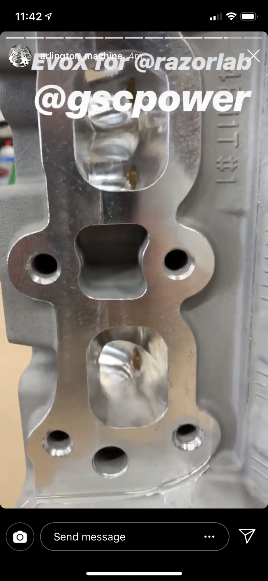

WHO should I be using to build up the head, and how far do I need to go with headwork to reach my goal of 600 to 650hp to the wheels ?
Does anyone have feedback on the work that BOOSTIN is planned to do (building a shortblock, balance / blueprint) ?
Other than cams/springs/retainers, you really don't need to do anything. I was on a 100% stock port head with Kelford B cams with upgraded springs/retainers and the car easily made over 600 and pulled to 9k.
If you do really want to port the head, oversized valves and all that (which I have now), I can't recommend Arlington Machine in Riverside, California more. They did an amazing job on my head and reasonable prices. https://www.instagram.com/arlington_machine/
