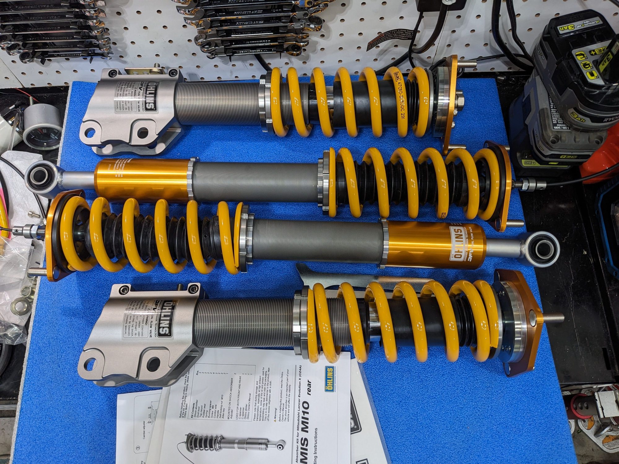

Assembly completed!

Beautiful! What rates did you choose? Also, I see that it looks like the top bolt hole is not oval'd like the oem strut or is that just the pic angle?

MIS Mi10S1 includes spherical upper mounts.
MIS Mi10S1 has a target ride height reduction of 25mm front and rear.
MIS Mi10S1 front spring rate: 100 N/mm.
MIS Mi10S1 rear spring rate: 80 N/mm.
I set them to 27mm front and rear drop to start.

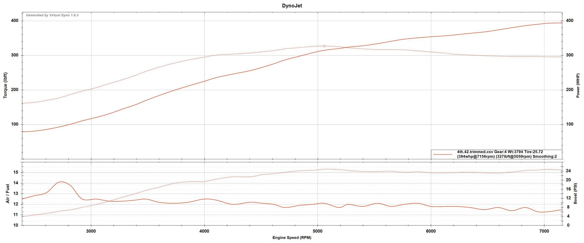

Low boost, low timing initial results....

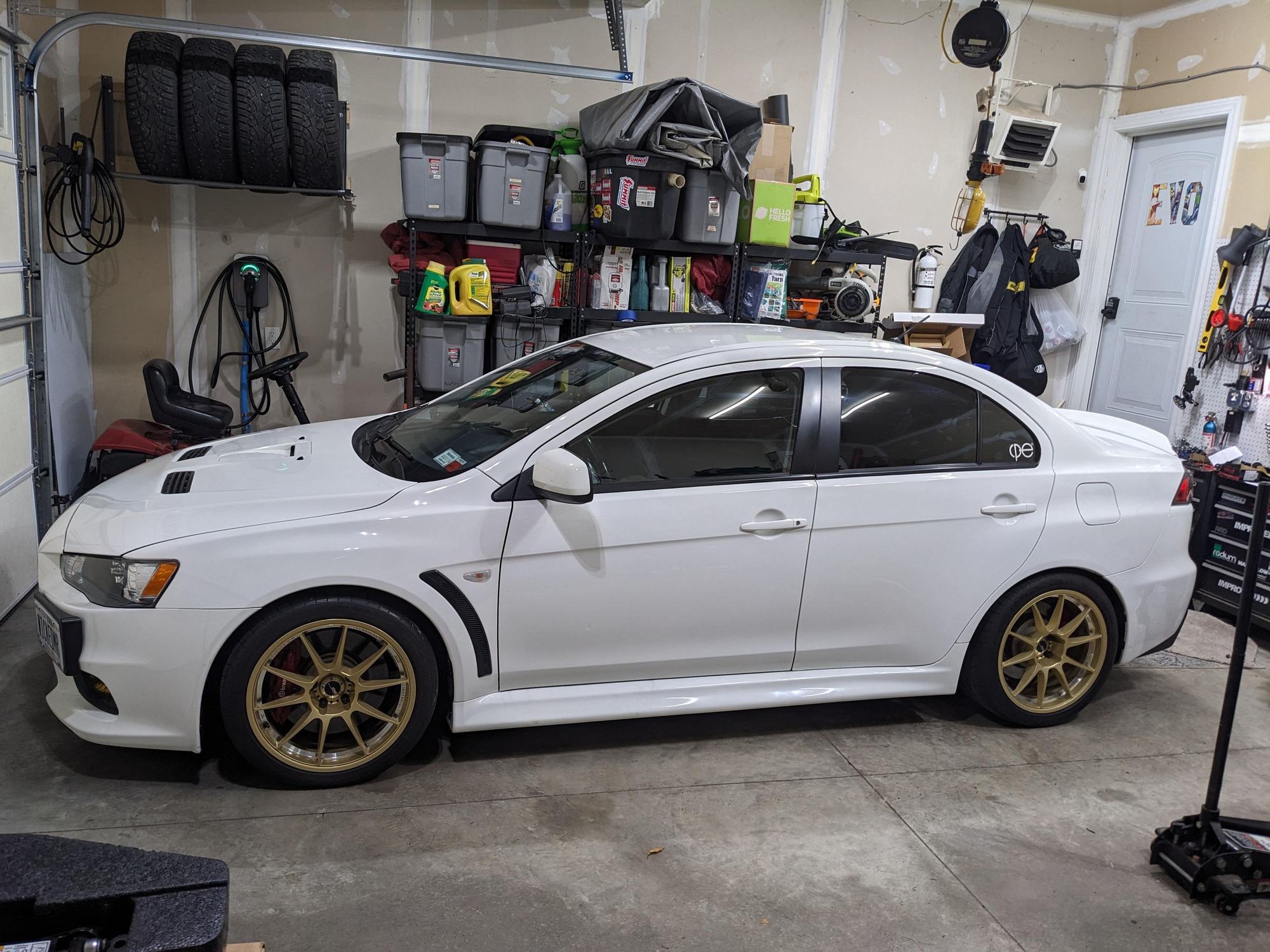

So got around to installing the Ohlins and Oh-MY, I should have bought these SOOO much sooner.
She sits nice (not like a pickup truck), and since I'm not running it in SNOW anymore, I can be this low and leave it that way.
I need to look up what a good middle ground (between street and track) setup would be for camber and toe since I now need a new laser alignment.

Multiple track days or even a lot of autocross events will eat the tires quickly. When I was doing some partial-DD with a few track days per year I found it best to go all in on the track alignment. The wear from street use was minimal relative to the 160 minutes of track driving I could get on a single weekend. I was also going through 1-2 sets of tires per year, so YMMV.

I only do a handful of events a year. Five max I would say, but I am curious what your alignment setup numbers were. I am looking to burn these tires up, and get the Re-71rs back on there. I just cannot believe the level of fender roll that appears to be needed for these RPF1 +15s.

Five weekends at the track could be enough to consume a set of 200TW tires depending on how many sessions you run.
I think I ran -3.2 camber up front when I was doing some double duty.
As for the fenders: Get camber set first. Each degree of camber is going to move the top of the tire inward about 0.22". Two additional degrees of camber will pull it in almost a half inch.
