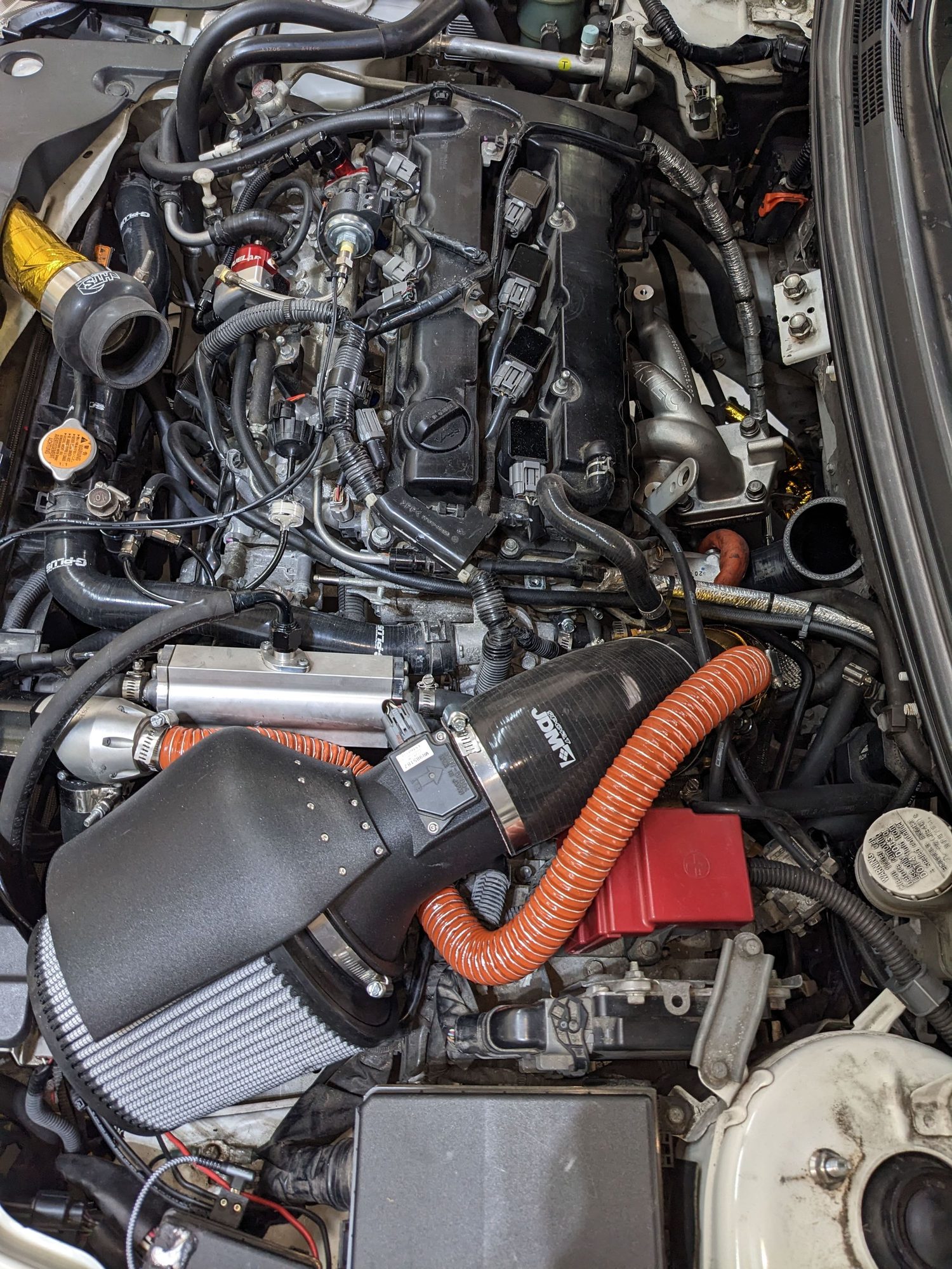

Tomorrow she is going to be fired up. Wedler friend is finishing the custom charge pipe that goes over the engine.

So I kept boosting too high, and my boost gauge would alarm and I would let off. Today I hooked up the air compressor to the wastegate actuator and you know when the rod finally started to move? 35 PSI !!!! So needless to say, it is a good thing I didn't plant my foot and hope for the best! Based on the springs in the Tial MVI 2.5 it should have been 22 psi, but the preload on the flapper was STUPID. I pulled a spring (GREEN) bringing the base to 16 psi and set the pre-load correctly. I can now control between 16 psi and up (I'm sure to my limit).
Posting this view because I like how it shows the smooth in/out of the hot side with ARTEC in and AMS out; all cast stainless steel goodness.

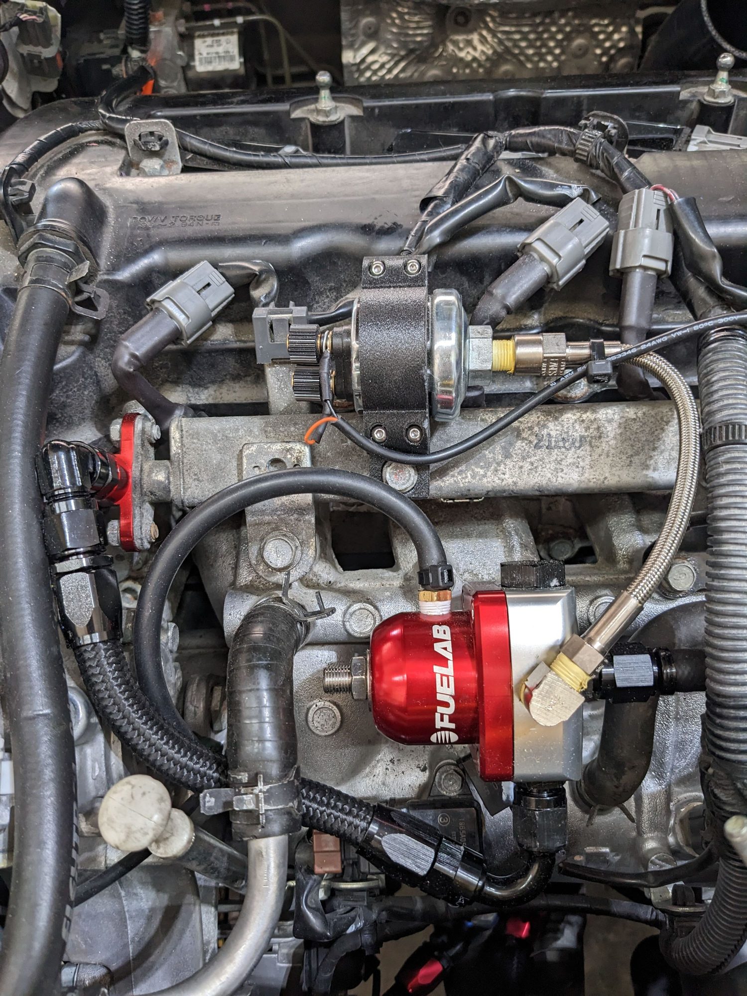

Ignoring the dirt.... This is the 3d printed bracket I made in CAD to hold the fuel pressure sender unit.
