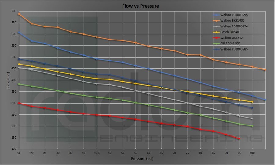

I recently made the choice in turbos, I was always a fan of garret stuff. I'm a Platinum certified garret installer through work, what ever than means. Haha. I went with the Borg. 7163. It has a stronger bearing cartridge. The intergraded Recirculation valve and Wastegate are really nice. makes for an OEM look. Not sure how the police are in you area but in mine they cant tell what's OEM or not. They just say its all illegal and send you away with a vehicle inspect and a handful full of illegitimate tickets.. The Garretts G series are rated at the Crank for max HP. while Borg ratings seem to match Wheel HP, A G25-660 or G30-660 might make 600 whp while a 7670 will make 650.
Another thing different was the compressor maps. Borg is more efficient per rotation than the G-series. While the Garrett advertises a higher overall efficiency, the island is usually very short and narrow, and at a much higher compressor speed.
As for manifold, I have one car on a Cast manifold, The wife's Daily Evo MR, and mine is on a tubular. I have had Zero issues with either in nearly 3 years, Vancouver BC weather, The wife's will crack one day as its stock, and at that time it will get a MAP manifold.
I don't know how I feel about boosting the pump. Wont the extra voltage lower the life cycle of the pump? Would it not be easier less complex, and lighter to go to a larger pump? Walbro "Hellcat: 285 or 295? They move a tone more fuel with not pull that much more electrical draw. See attachments.

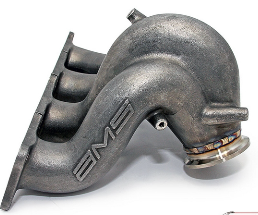

So here are the CAST STAINLESS manifolds for the Evo X that cannot be acquired any more:
AMS cast manifold for Evo X
MAP cast manifold for Evo X
AGP cast manifold for Evo X
