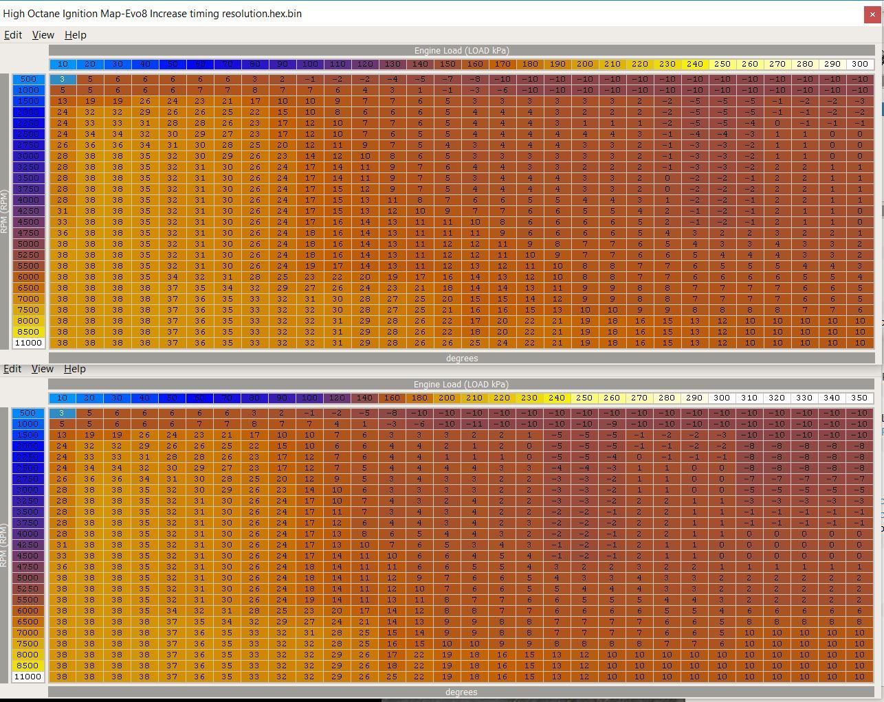

My in progress effort is learning about tuning EVO's and updating the Tephra Tune. I get bad knock (read 36 counts repeating), on spool, in and around the 100-120 load range. I've scaled the map's load axis from 350 to 300 then added the extra resolution to low-mid loads; but have not burned to new maps yet. I'll post maps at some point.

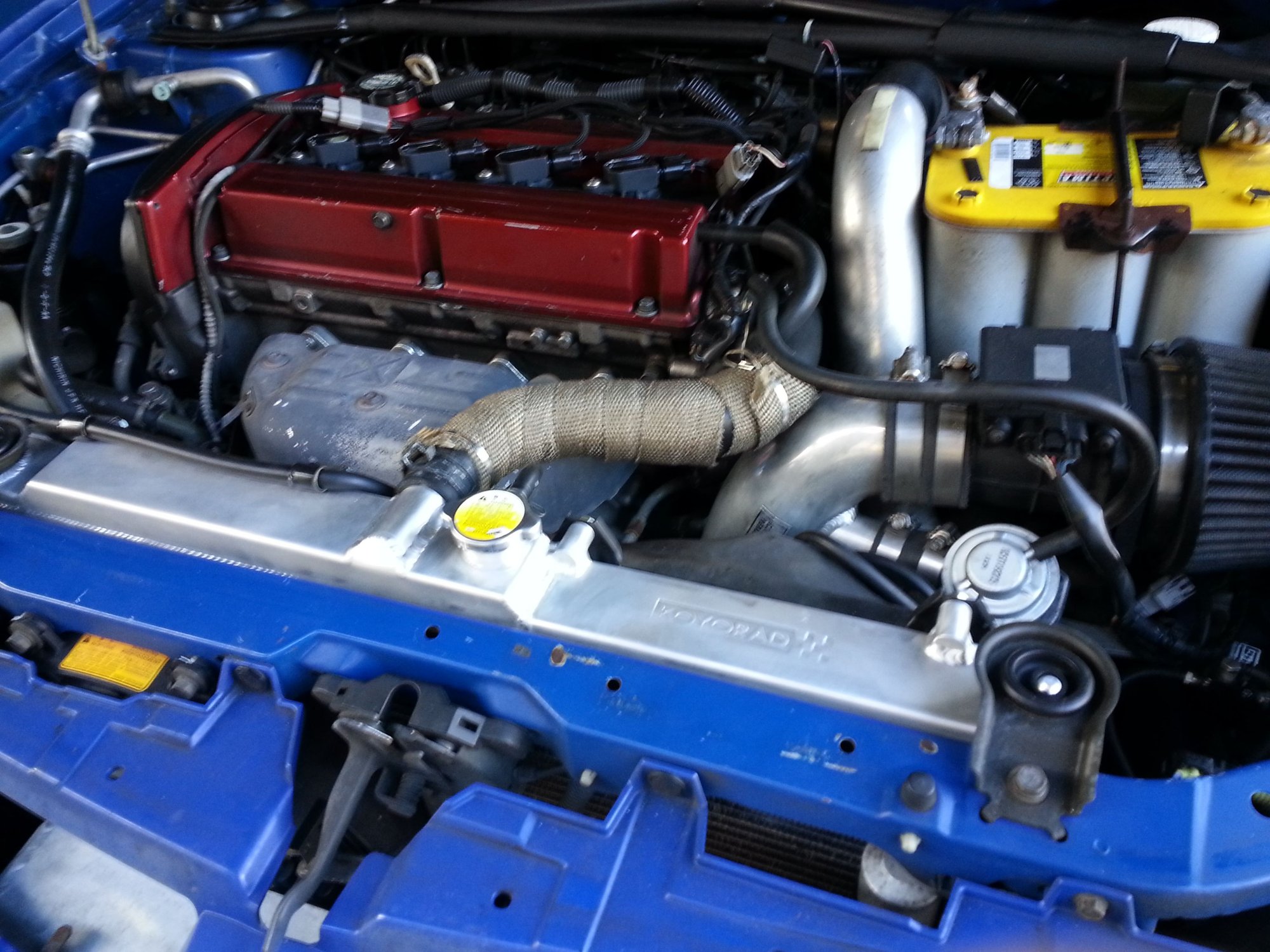

This is the first time seeing exhaust wrap on upper radiator hose. I take it you have oem downpipe?

Cat is out test pipe in its place. The wrap is something the PO did....He was probably trying to keep the heat from the manifold away after taking the heat shield off. Might add some real insulation at some point, I don't like how that hose is positioned. Part of it is above a hot manifold and further towards the block it rests up against the turbo inlet.

Went out logging today flashed the new maps in. Having issue logging with the laptop. It connects and give lots of data but the laptop will not pick up my WBO2. I have to log with the Openport 2.0 SD card to get WBO2 data. Noticed something really weird with the EVO. My boost gauge hit 28 PSI?!? vs. 23 PSI on my current tune. Ok, traced some vac lines and found my EBC to WG line came off. Got it back on and zip tied it. Going to say this might have been my fault while installing the radiator? Although, I could have sworn I checked that line while I was down there.
New on top. Basically the same tune except max load is now 300.

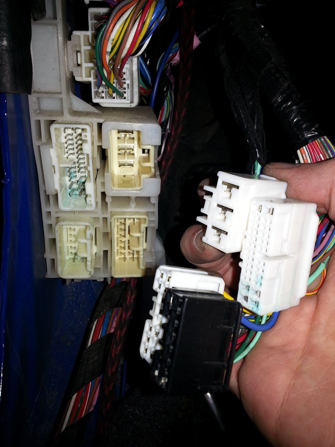

Started to diagnose the IC spray system. Currently the switch does nothing. First I took the switch out tested it per OEM manual...nothing, open in all positions.
Took the switch apart had light corrosion on the contacts, scuffed the copper with some 400 grit, wiped with alcohol, lithium greased, and reassembled. Everything checked out, continuity where needed. Reinstalled the switch and still no pump noise but the light in the dash is on? Good sign I guess.
Moved on to the pump, hooked a 9v to the pump, it runs but nothing comes out. More than the switch in the car is doing. Started reading about wiring harness corrosion on the EVOs. I checked the driver side connector and I have a corroded harness. After finding that I knocked off what I could and put it back together. Smeared some silicon on the grommet (I'd like to take the fender off and put silicon on the outside). Also, ordered some Dupont pins so I can re-pin the block.

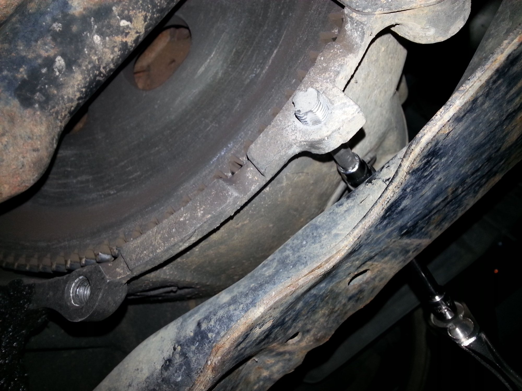

Did some work yesterday while waiting on the larger dupont pins to arrive. Noticed the flywheel cover is missing? Who TF thought that was a good idea to remove? So I bought a new one from STM. Other things I did below.

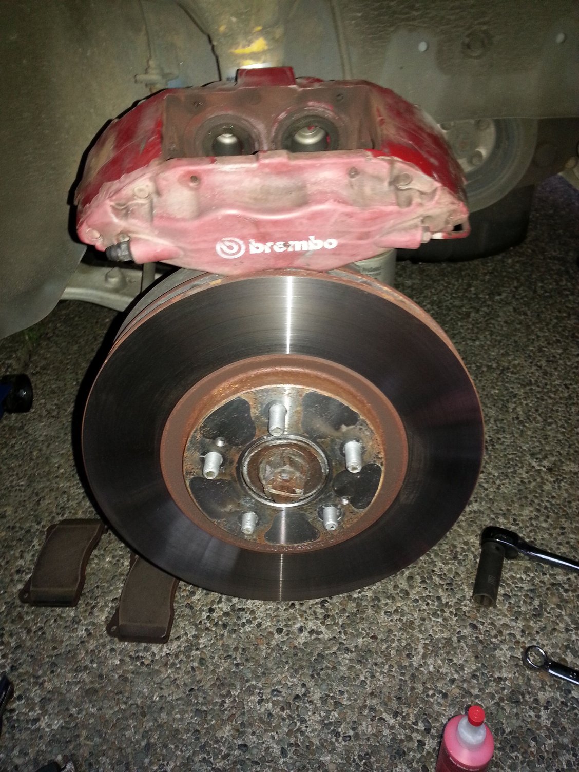

The front passenger side brake has been squealing really bad at low speeds. Took it apart to investigate. Found that no shims where installed to the back of the pads. Added grease to all of the major contact points and scoffed up the rotors and pads to re-bed them. The squeal is still present so I ordered a set of OEM shims from STM.

Flywheel cover arrived. One of the threads in the trans was messed up. Luckily I was able to start a tap on the back side. Ran it through and cleaned it up. Started to get dark so this was all I did.
I really not a big fan of this design that mitsubishi did on evo 7, 8 and 9.
Evo 6 radiator is a direct fit and has the hose neck off the side and away from the exhaust manifold
I wonder if the 8 has an aftermarket fix?
