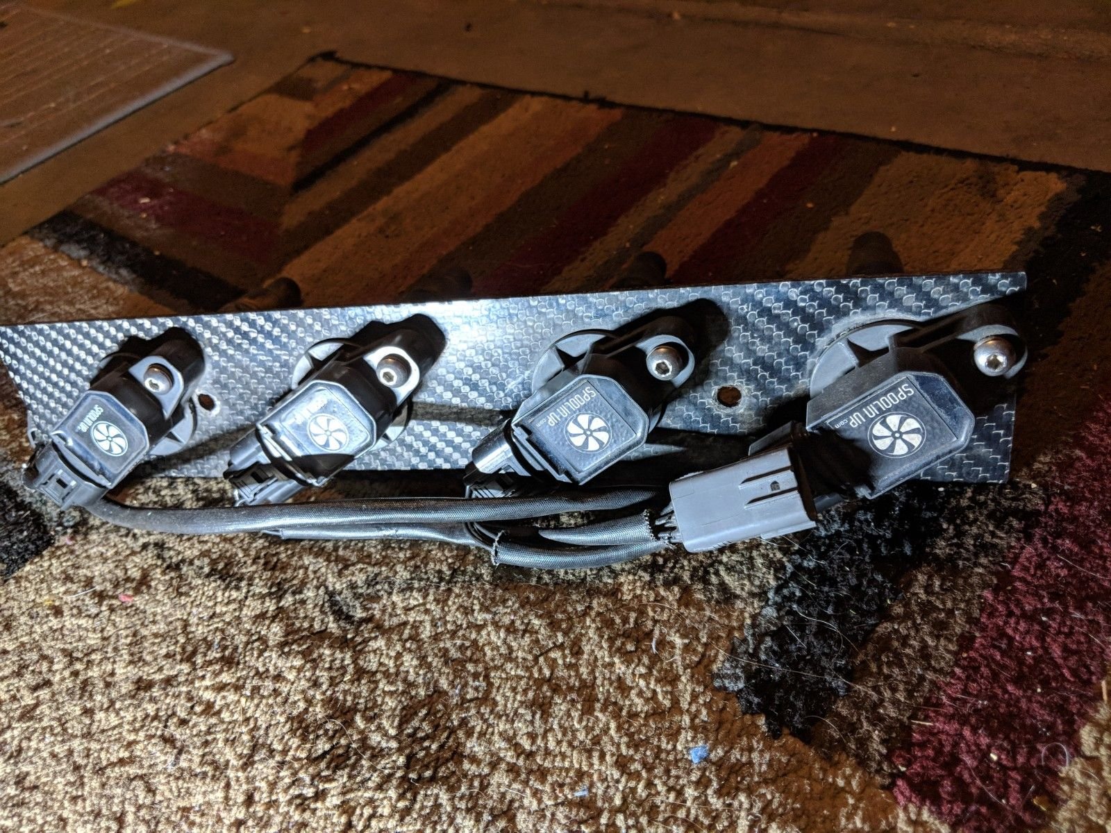

Hi everyone. I am Russ, and I am new, like most forums, I put up a build log so I have a record of things I ahve done, and for people who are bored can look through this and help me out! First off, thank you for this forum, I have fixed a handful of things on this car from here already! I took delivery of the car April 11th and actually in way better shape then I expected, but also more mods then I wanted. The more I dive into this car, the more headaches! haha. First off, the car idles really rough, and has misfires, so day one I replaced the spark plugs (NKG plugs, got the number from here), and it now runs, great above 3500 rpm, lower it still misfires. I have gone through 2 tanks of gas now, and do not think it is old gas anymore. I ordered a coil on plug conversion (spool up) in hopes that will fix it, if not I am going to guess it has to be the tune.

Vegas Jaxwax Strikes again, I did not take a before picture, because I was not expecting these results! The engine was Filty, I planned on taking a toothbrush to it and clean it up. I had a coolant leak that put coolant stains all over the engine etc.. Found the leak, and fixed the hose, and sprayed it down with a product called Super Citrus from jaxwax. I sprayed it on the cold engine, let is set for like 5 mins, and power washed it off. Jaw dropped with the results.
And now that it is cleaned up, time to install the coil on plug kit
Like mentioned above the car needs a tune, and runs like crap under 3500 RPMS but over that, it runs smooth. I can honestly say the power seems smoother, but hard to know for sure, could just be my mind playing tricks on me haha But, either way, looks better, and will help in the long run.
