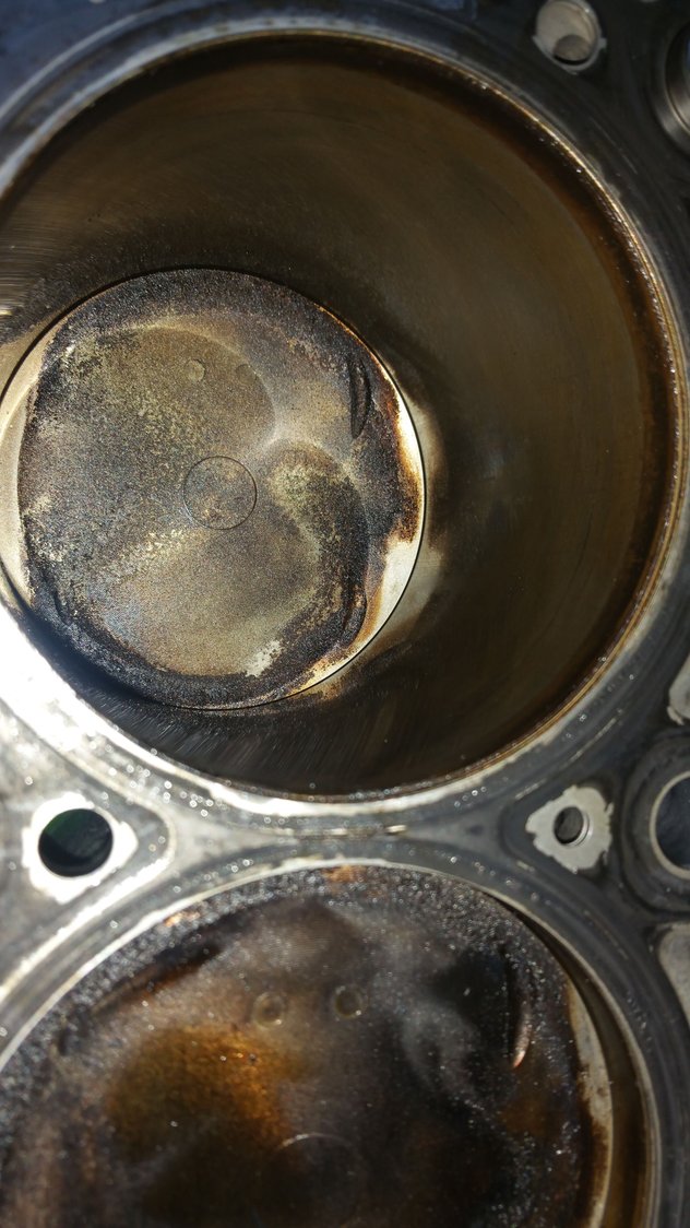

Another thing, my stock bottom end was exposed to small 71HTA turbo making 400+TQ for 5000 miles. Could this be why my lower portion of my cylinder walls are shiny and missing the cross hatch?
