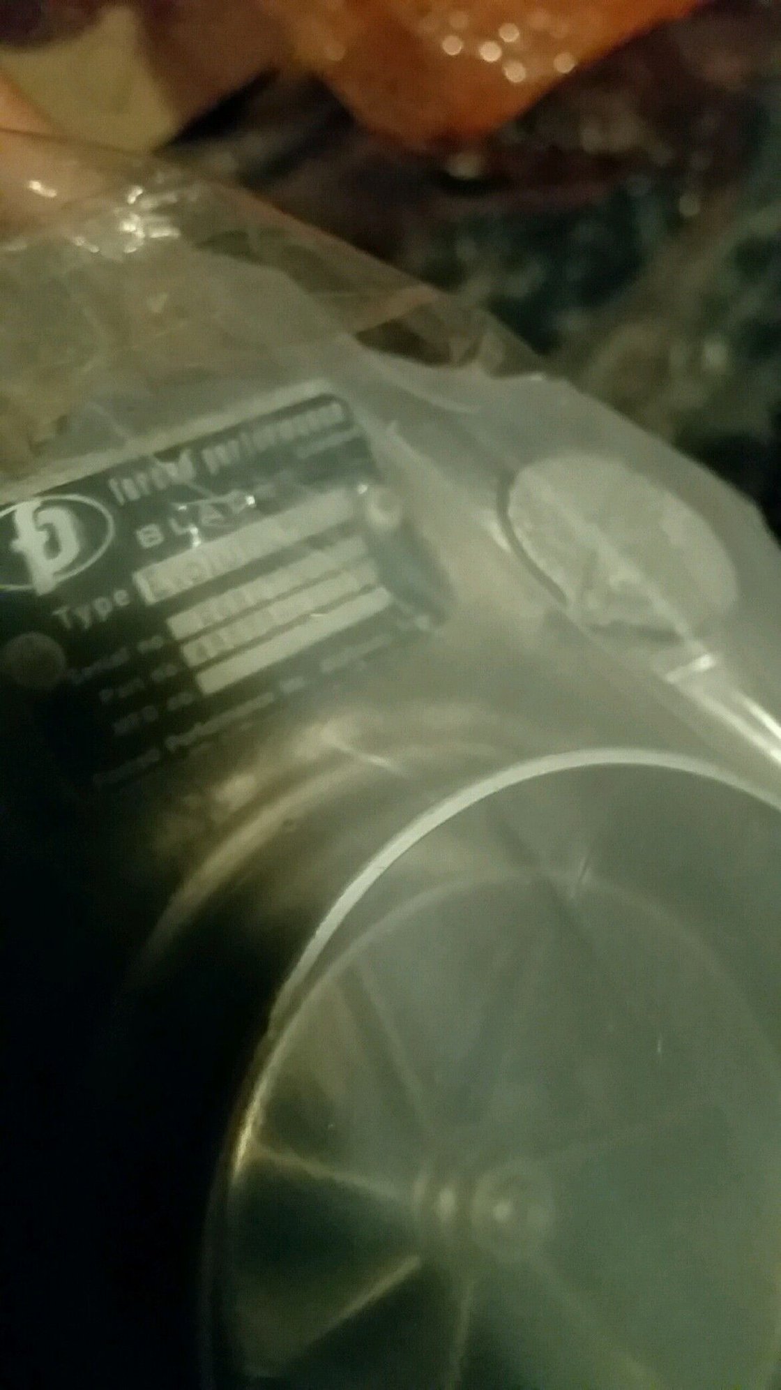

Look who's been waiting patiently in a bag...
