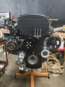

Also, got the HKS low temp oil thermostat, throttle body, and the exhaust side installed on the engine, alone with the Invidia o2 housing. What a pain in the *** that thing is. Had to cut a stud down so it would fit, and you have to start the nuts and the one bolt while you hold the housing out away from the mating surface as the indentations are too small. -_- Nothing impossible, but, I'd hate to try and do it in the car. I know...the turbo coolant line needs fixed or replaced. Haven't taken the time to see if I can straighten it yet. lol

You want the oil to be 210-220*F so the water moisture buildup in the oil can boil out and vent out the valve cover. Putting a lower oil temp thermostat may keep this from happening and getting water in your bearings is a no no. If you need more oil cooling then put a bigger oil cooler on or add a fan behind it to keep it at the temperature the thermostat opens. And yes water is an emission in internal combustion and it leaks past the rings and gets in the oil. If you run e85 it gets worse because once a little bit of ethanol gets in your oil it attracts water from the air.
