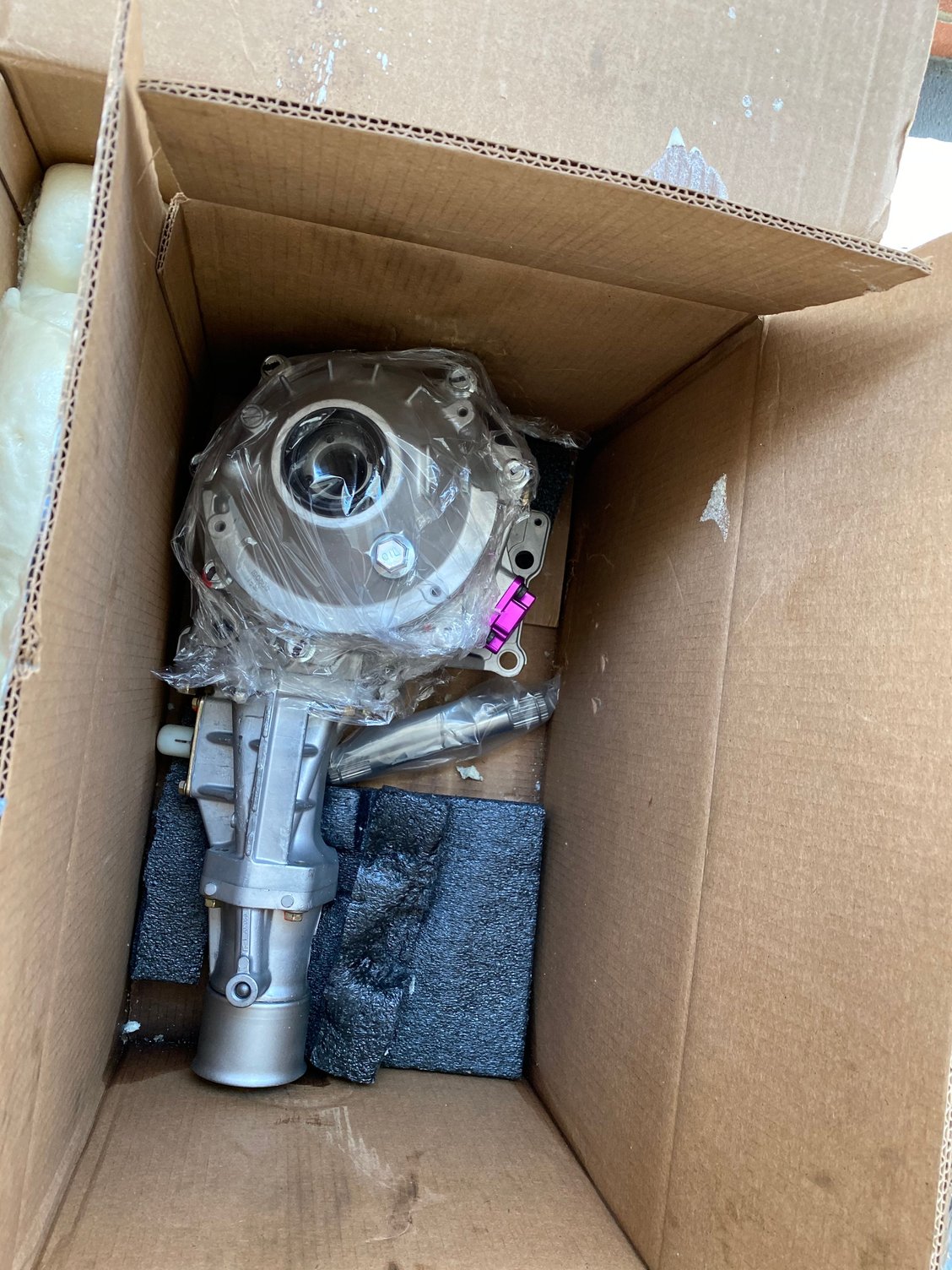

6/21/2020:
  • TRE Transfercase received!
  • Head shipped out
  • Waiting for TRE box for transmission

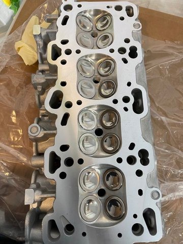

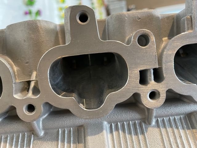

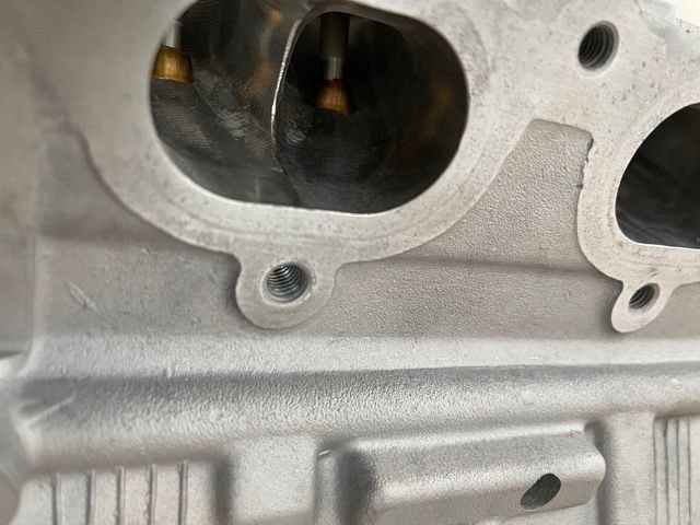

  • Bought another head, going to be sending out to head games.
Update 6/10/2021:
  • Bought good used 4g64 core. Waiting on that before I can start the build again.

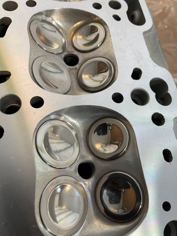

  • The head passed headgames inspection and is in queue.
    • Build is
      • CNC Street port with hand blending
      • Bronze guides
      • Ferrea 1826 Intake Valves
      • Ferrea 1825 Exhaust Valves
      • New locks
      • Kiggly Hi-Pressure valve springs
      • Kiggly HLA
      • Arlington Machining over size headstud washers
      • GSC S3
      • ARP 625 studs

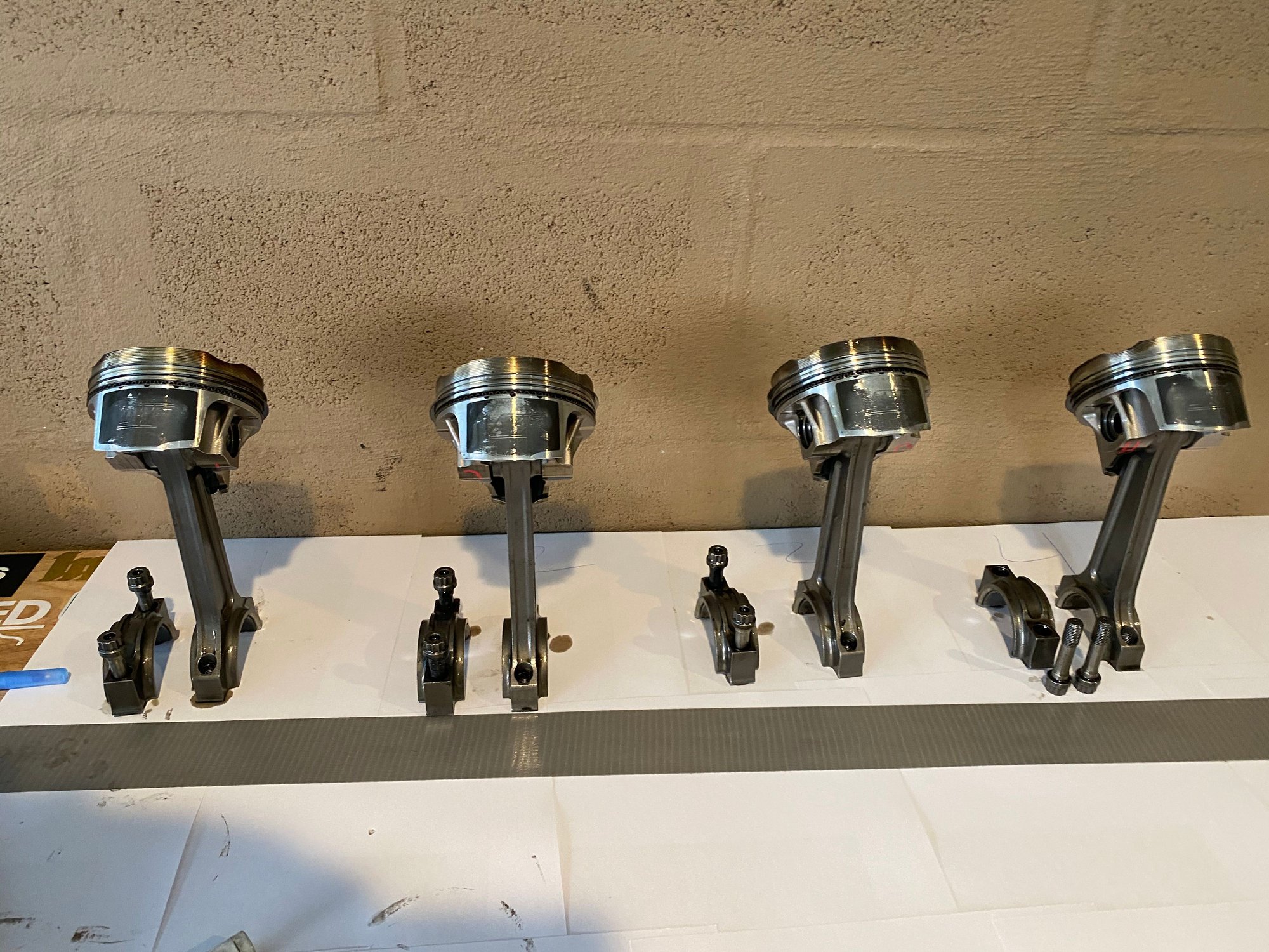

  • Ordered a 2.2l block from David Buschur. Rotating assembly(Buschur supplied) is in-house
    • Build is
      • Callies 94mm Knife Edge Billet Crank
      • Callies 156mm I-Beam Rods
      • Manley 2.2l 4g64 pistons(8.5/9:1)
      • BR suppling bearings, main rods, BS delete, ect

Update 8/2/2021
  • HeadGames Street port head arrived today!

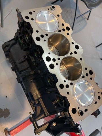

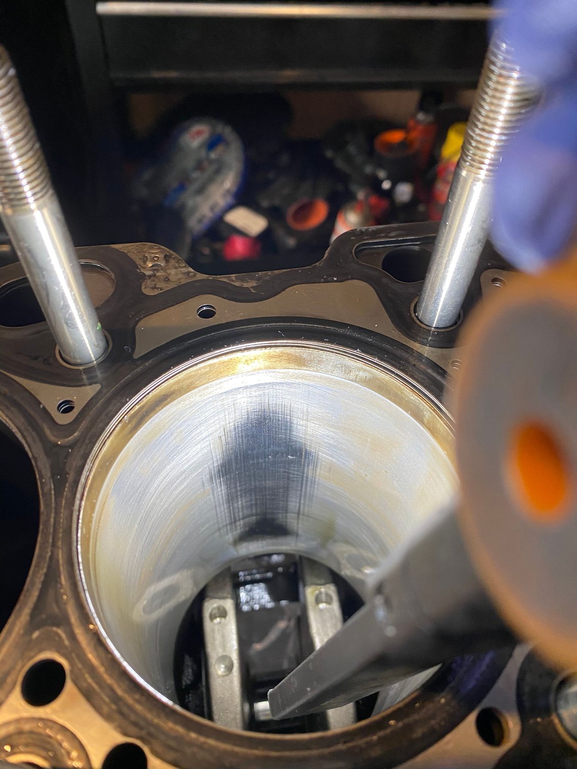

Update 9/9/2021
  • Block arrived today!
    • Buschur's LLC 2.2L 4g64
      • Callies 156mm Ultra I Beam
      • Callies 94mm Billet Knife edge crank
      • Manley Pistons
      • ARP Mains
      • ACL Race bearings
      • O-ringed

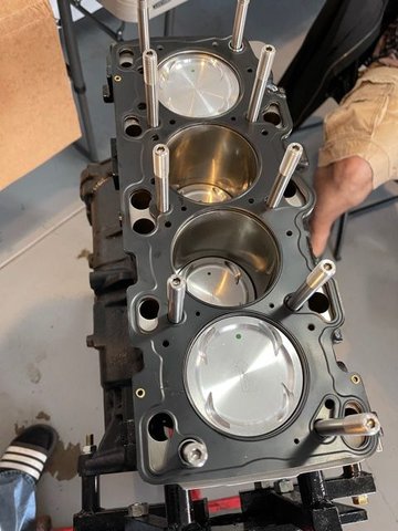

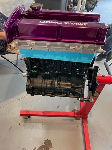

Update 9/12/2021
  • Got the block on the stand
  • head torqued down

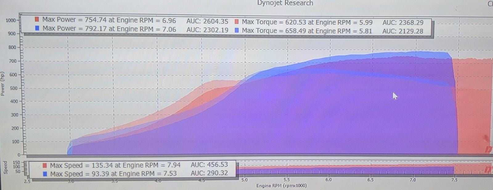

Update 8/2/2022
Tune Completed.
Well, here’s what happened.
car made 792hp/650tq @ 42psi on e75. Had to stop because it started to drop fuel pressure up top. Guessing the dual 450s and stock fuel lines held it back. Going to upgrade the lines and pumps in the winter and go back.
dialed the car back to 38psi to keep things safe. Still seems like a torquey street monster.

Old Jun 22, 2020 | 07:04 AM
blackline's Avatar
5 Year Member
Joined: Sep 2017
Posts: 767
Likes: 122
From: NYC
Updates:
6/21/2020:
  • Head shipped out
Old Jun 23, 2020 | 07:22 AM
SoSoEVO's Avatar
Joined: Oct 2018
Posts: 390
Likes: 160
From: CA
Beautiful, nothing better than a bnib trans, tcase, or rear diff ! Just curious how long TRE's lead times are right now with this Pandemic going on?
