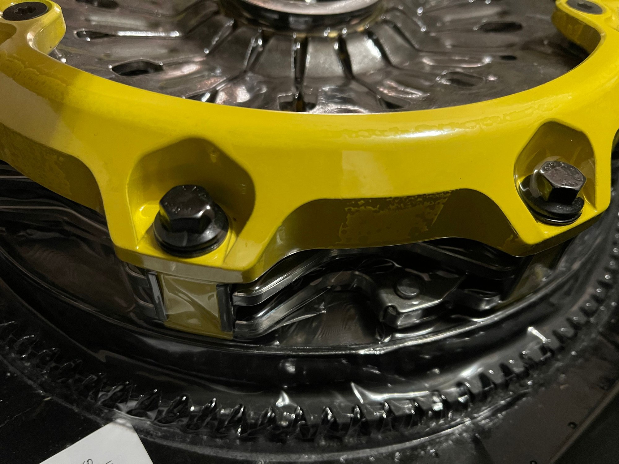

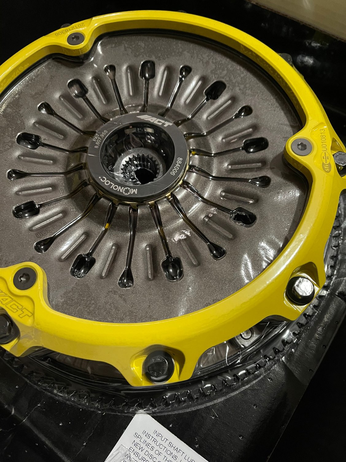

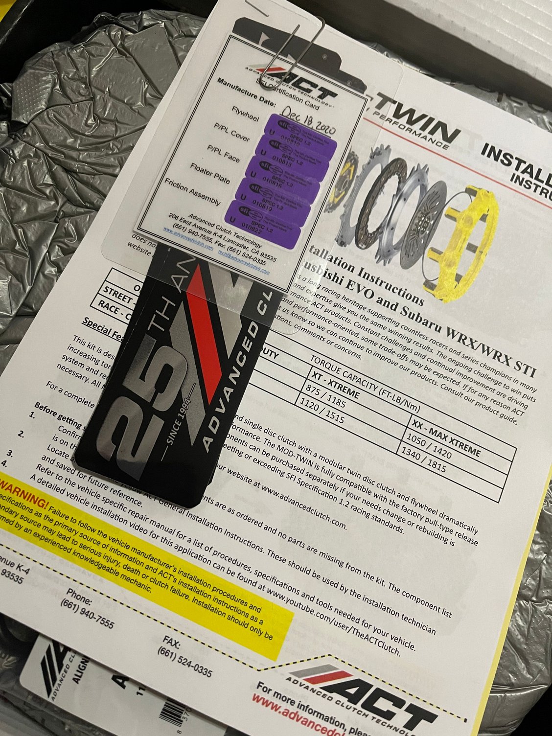

Update 1/11/2020:
  • ACT Twin Disc arrived(T2S-M01)
  • All OEM gaskets expect the Headgaskey
  • Evo 9 Oil filter housing
  • FIC 2150CC
  • Aeromotive FPR
  • KLM 4.5in Intercooler
