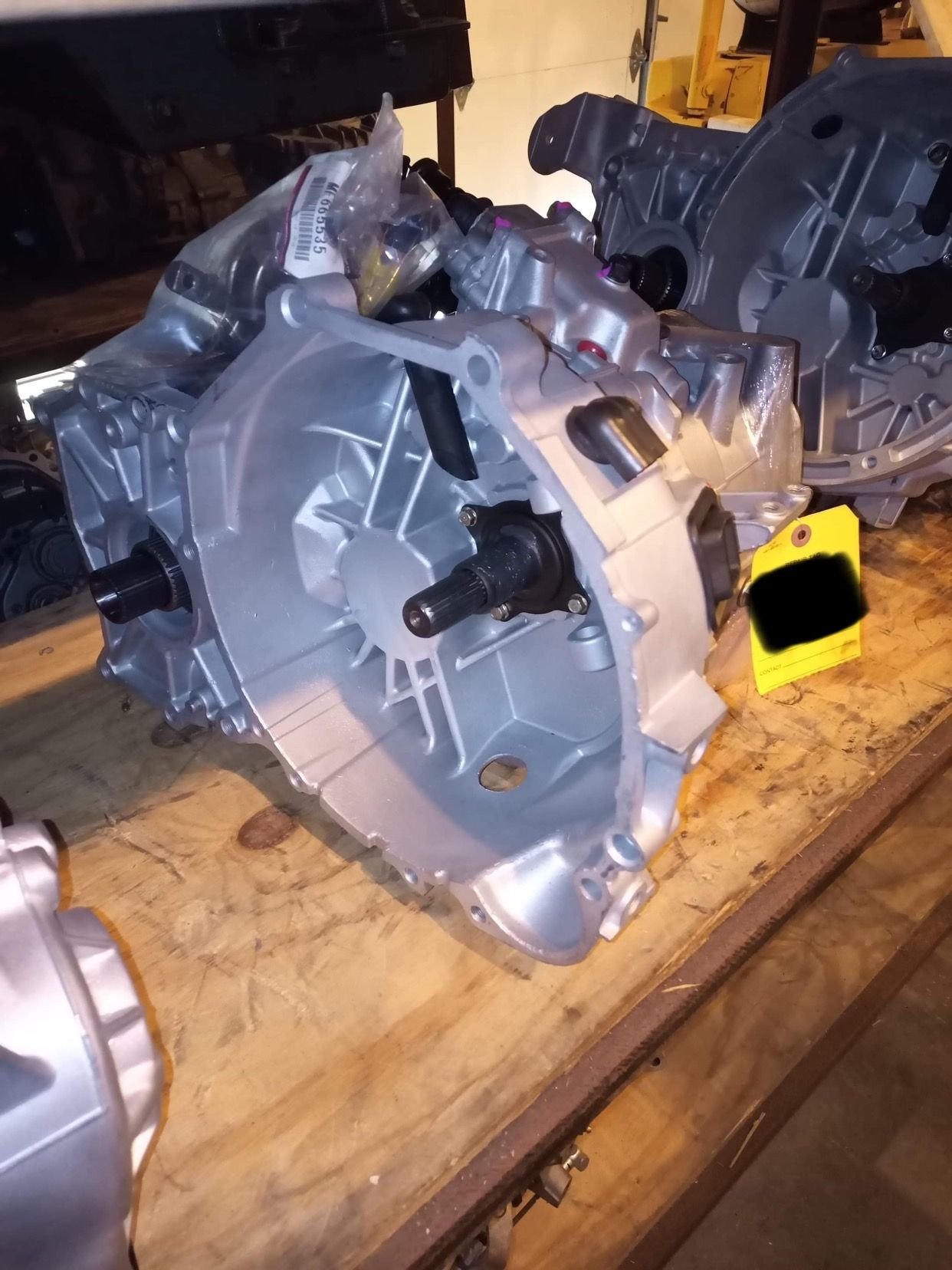

Beautiful, nothing better than a bnib trans, tcase, or rear diff ! Just curious how long TRE's lead times are right now with this Pandemic going on?
haha, pretty much. It took 4 weeks for the tcase.

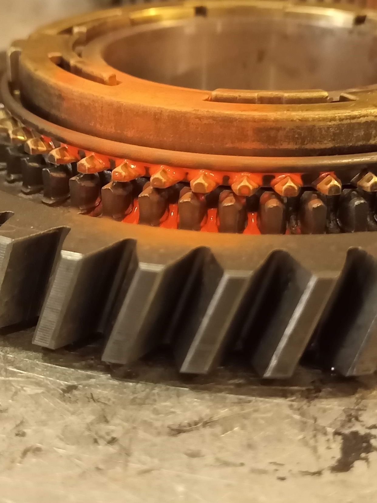

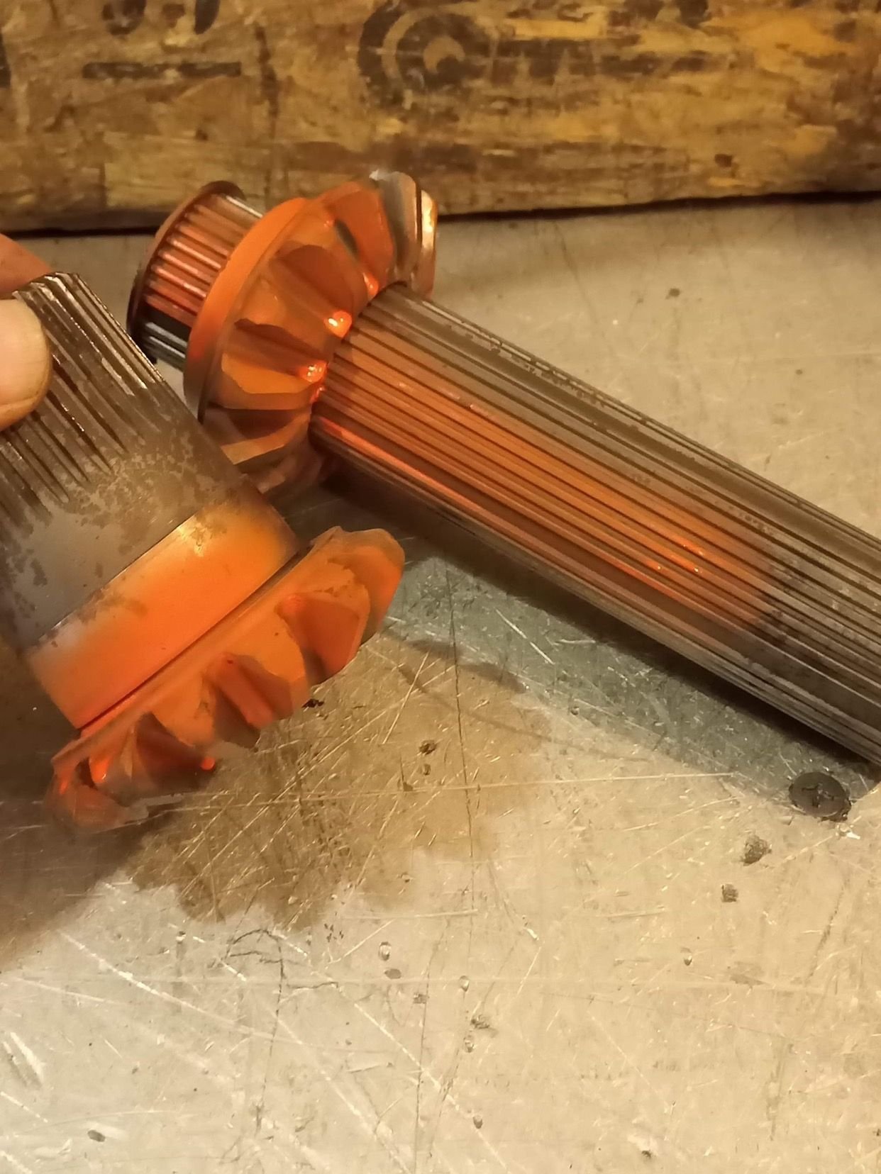

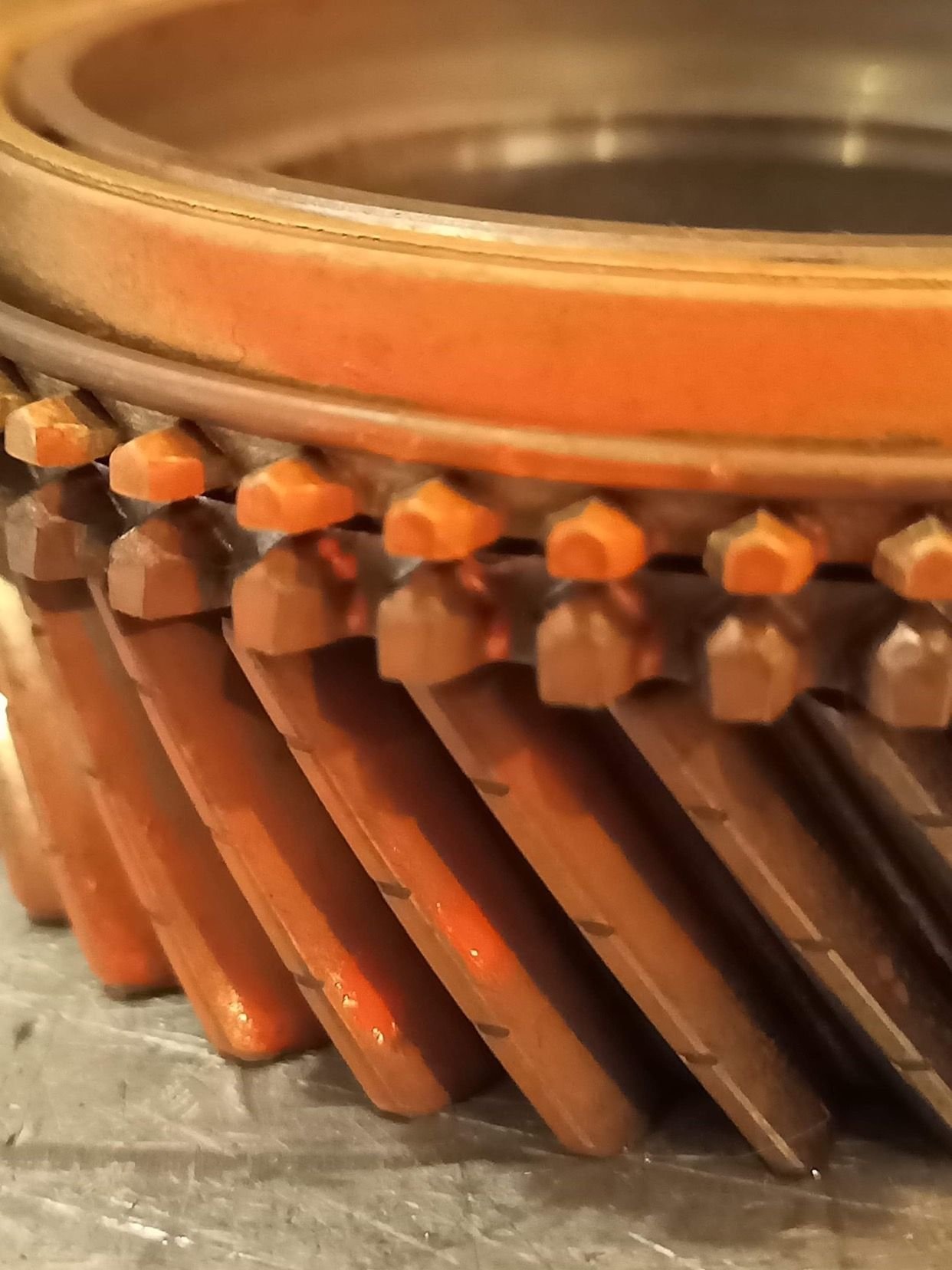

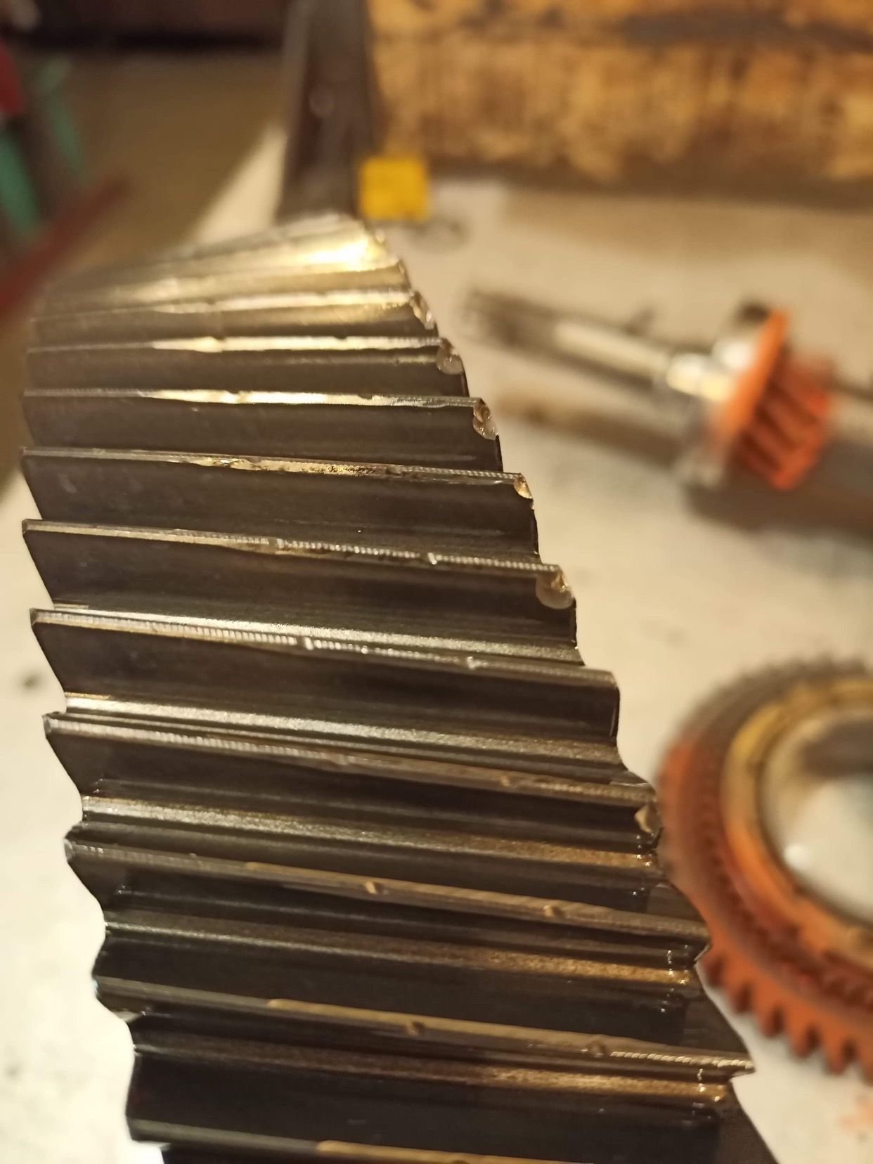

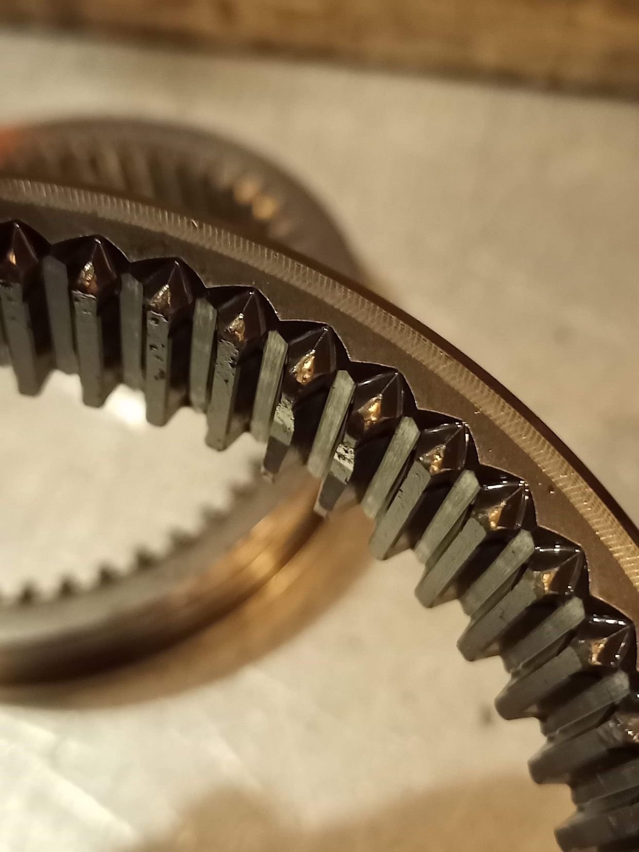

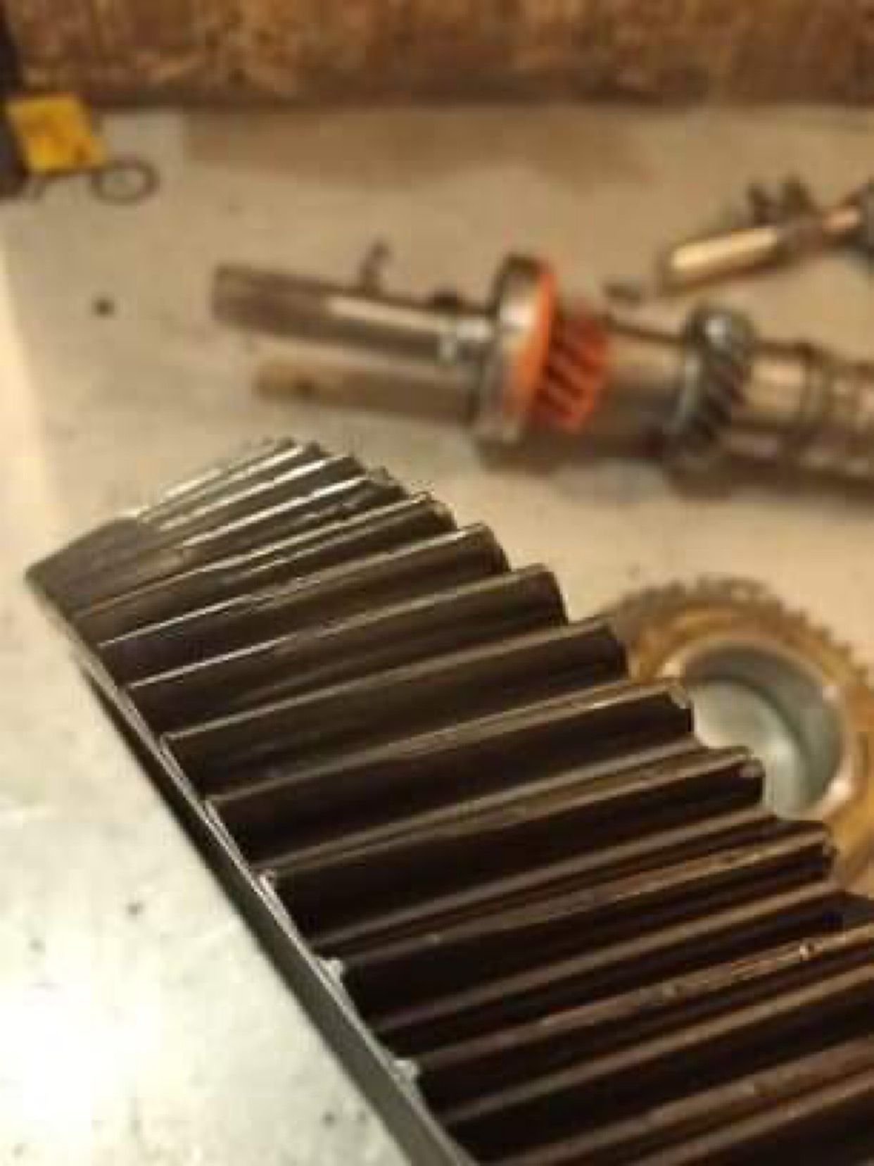

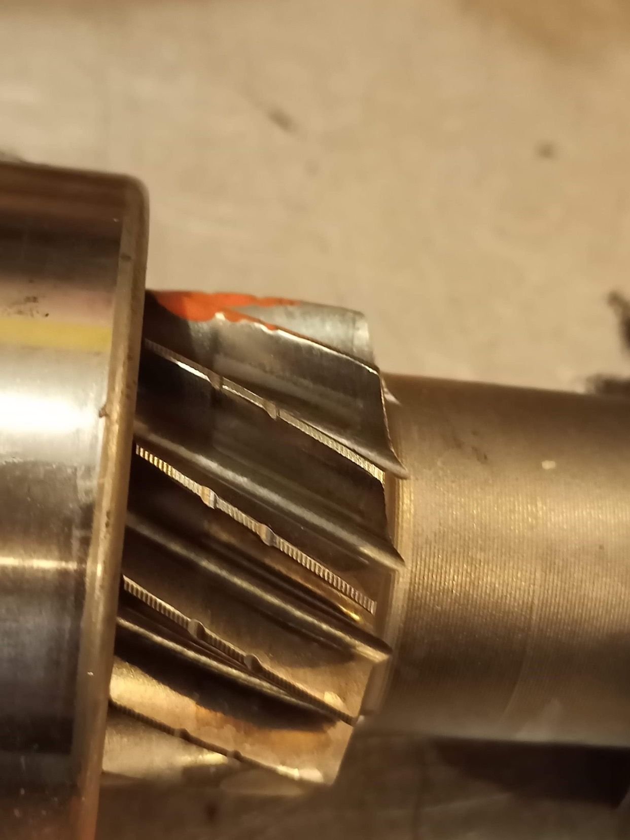

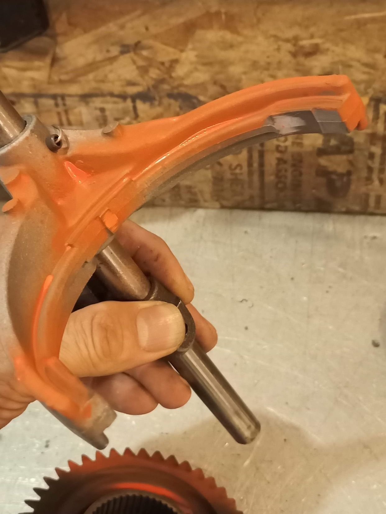

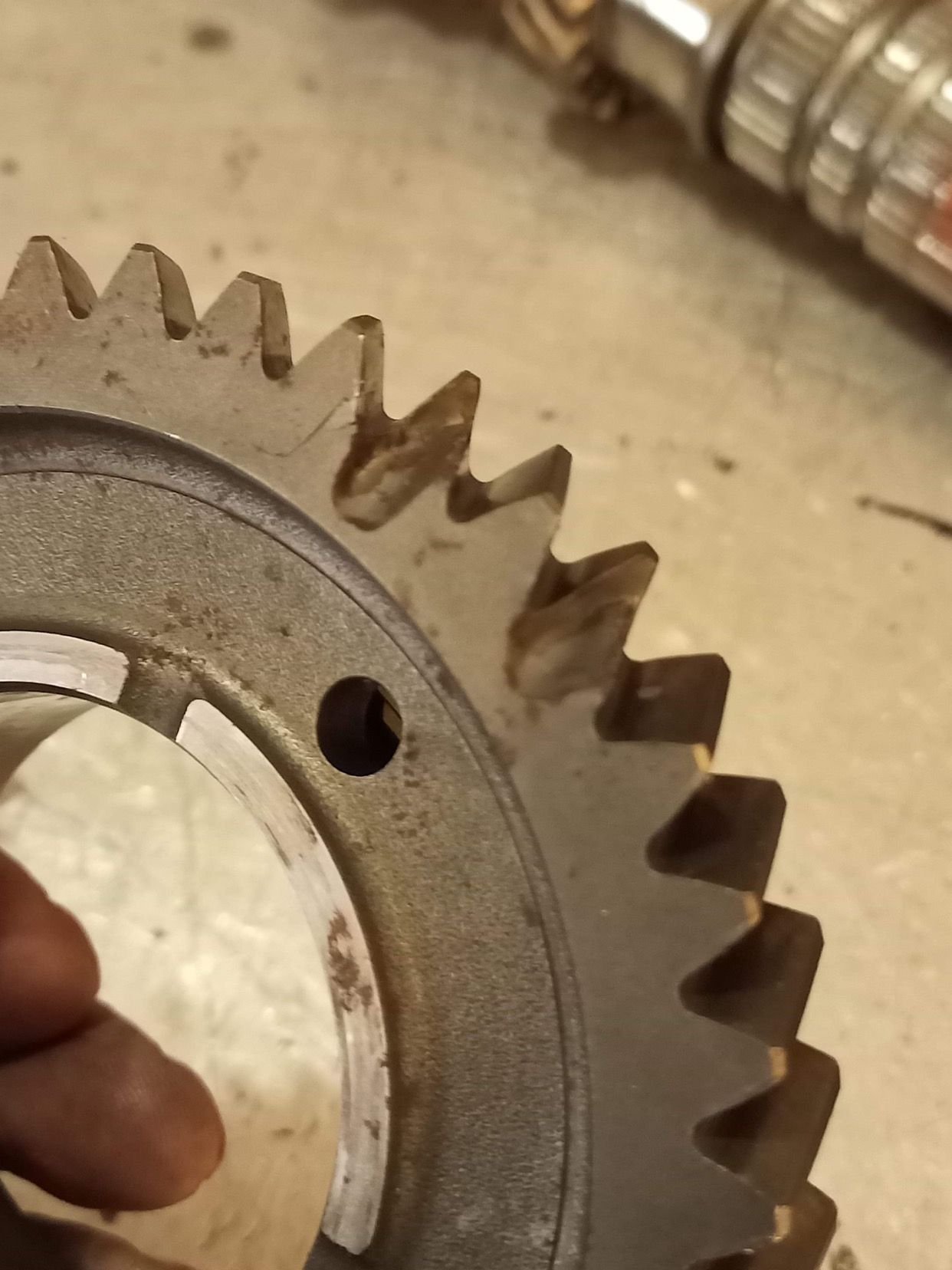

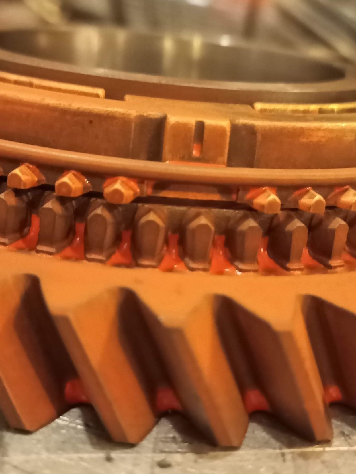

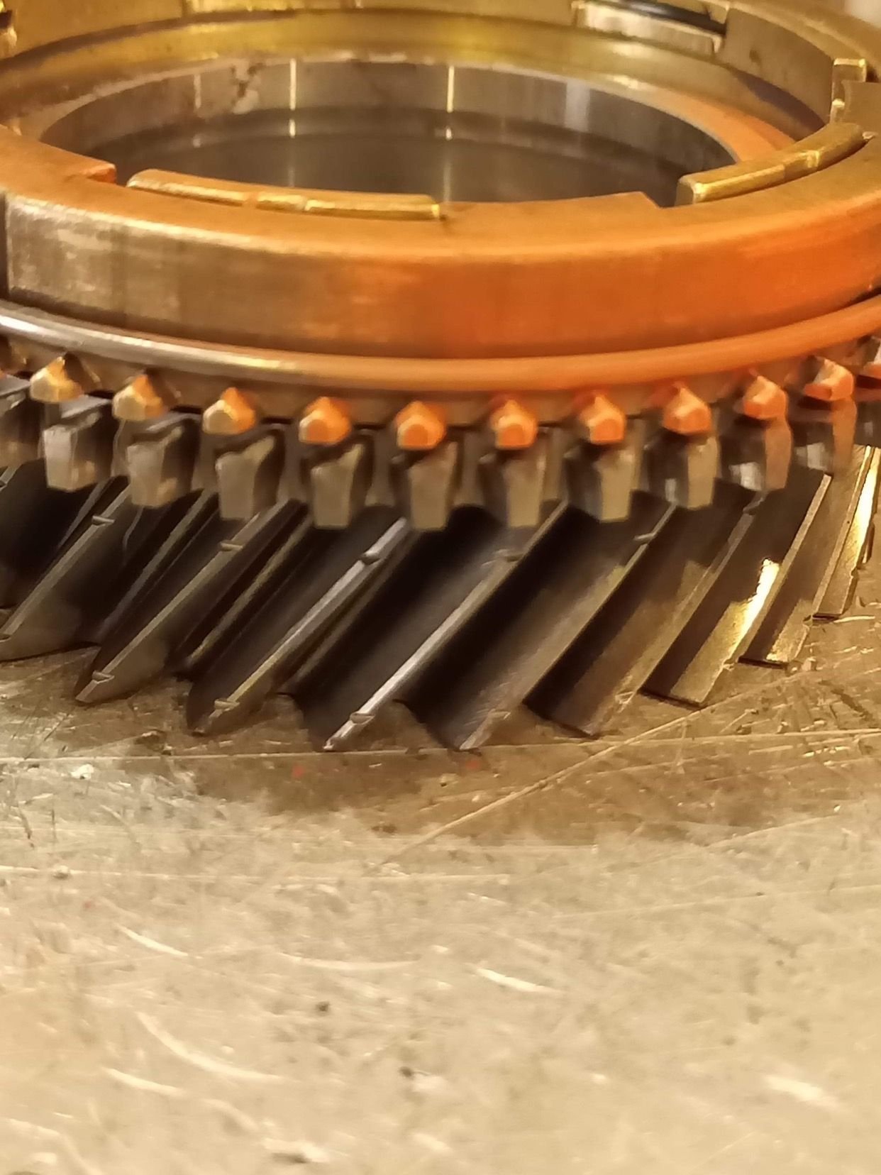

TRE Completed the transmission rebuild, Little under 5 weeks for it .
Pics of the damaged parts.
Final Drive gear all chipped up
Selector fork bent
syncros are done
Completed Trans!!!!! I can't wait to get the car running again!
Completed Trans!

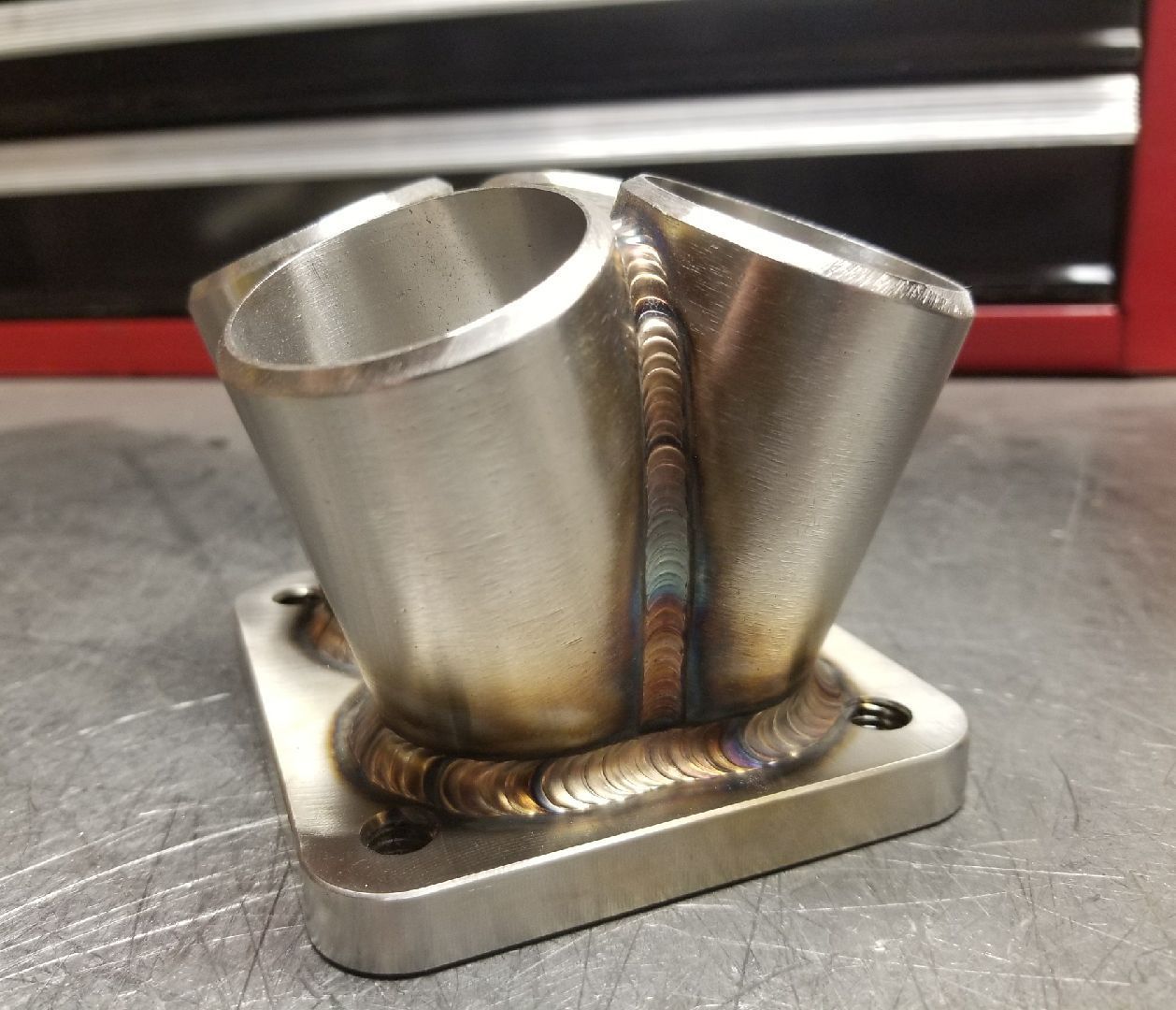

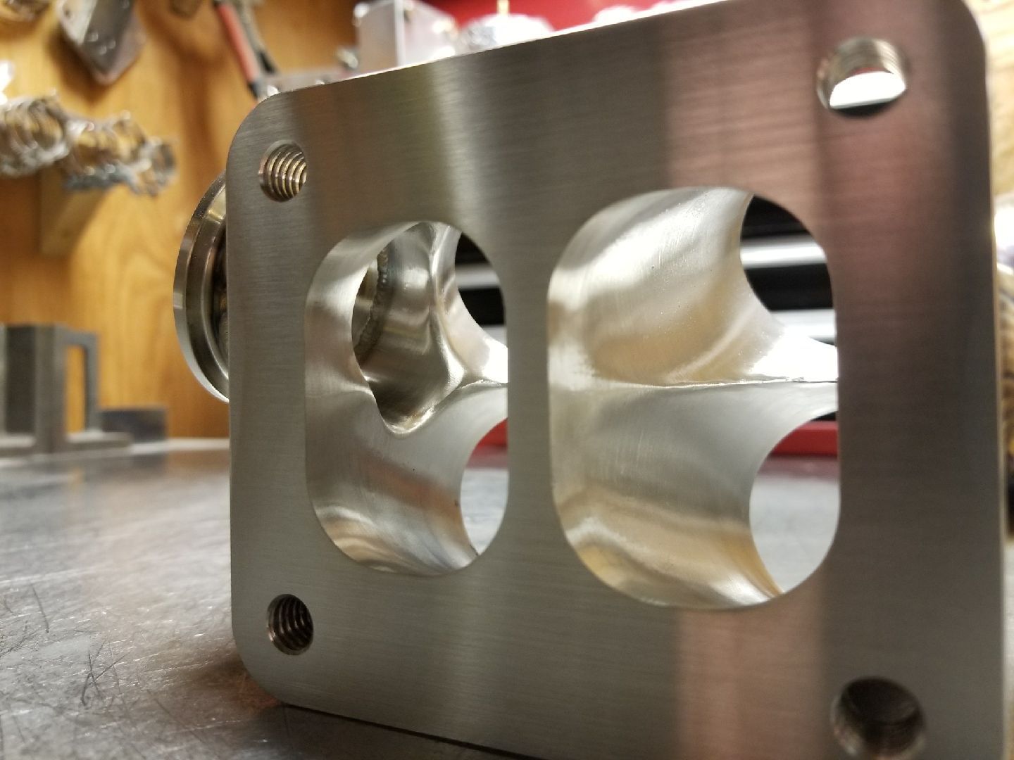

Matt sent me some pics of the collector, it looks smooth!

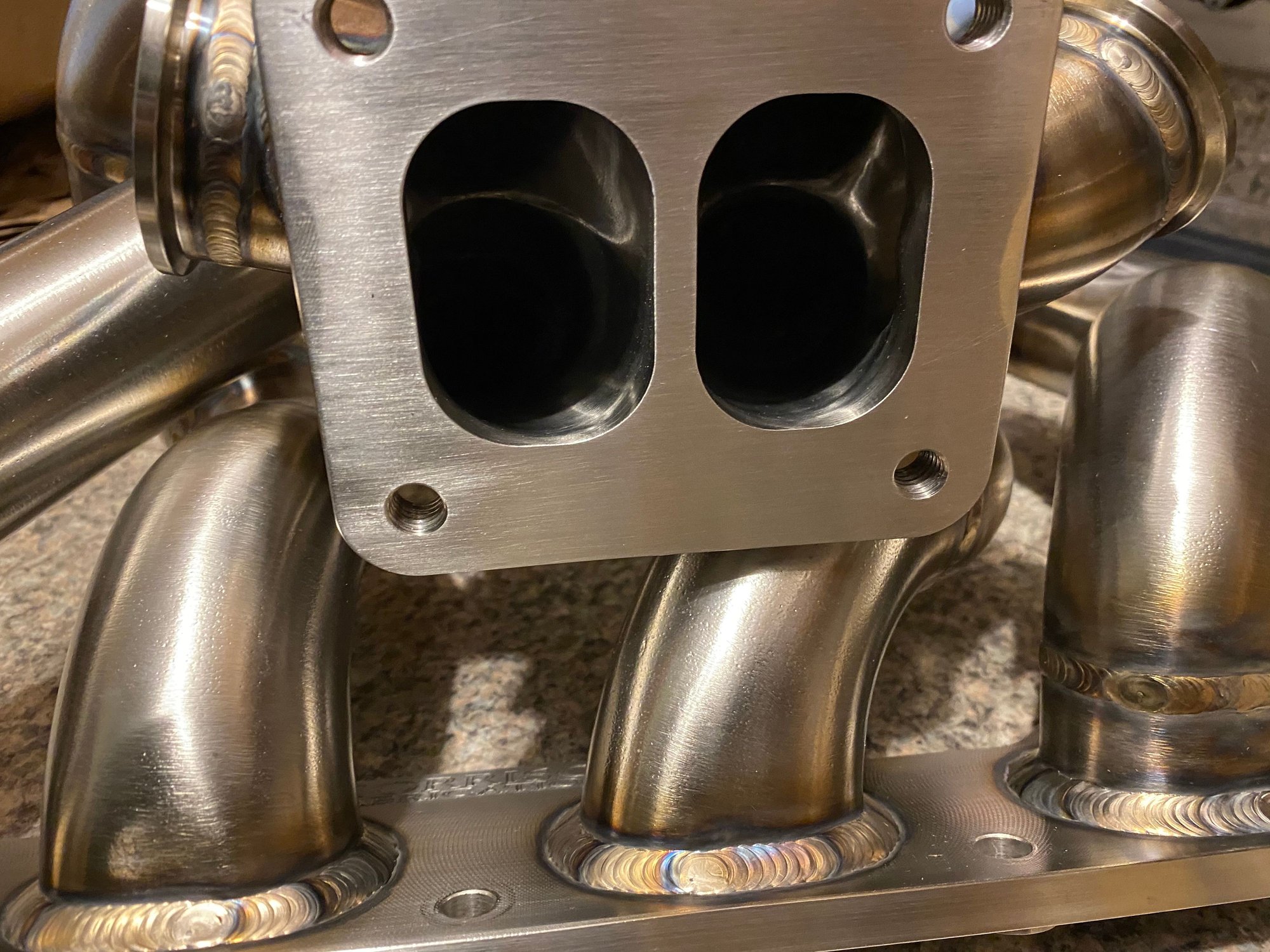

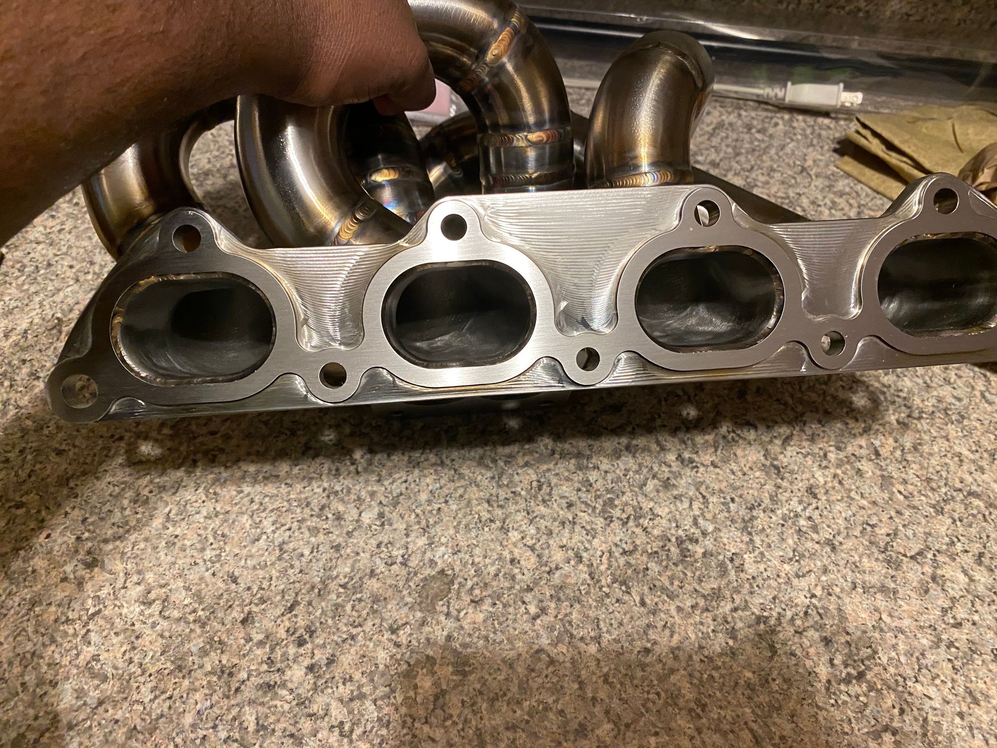

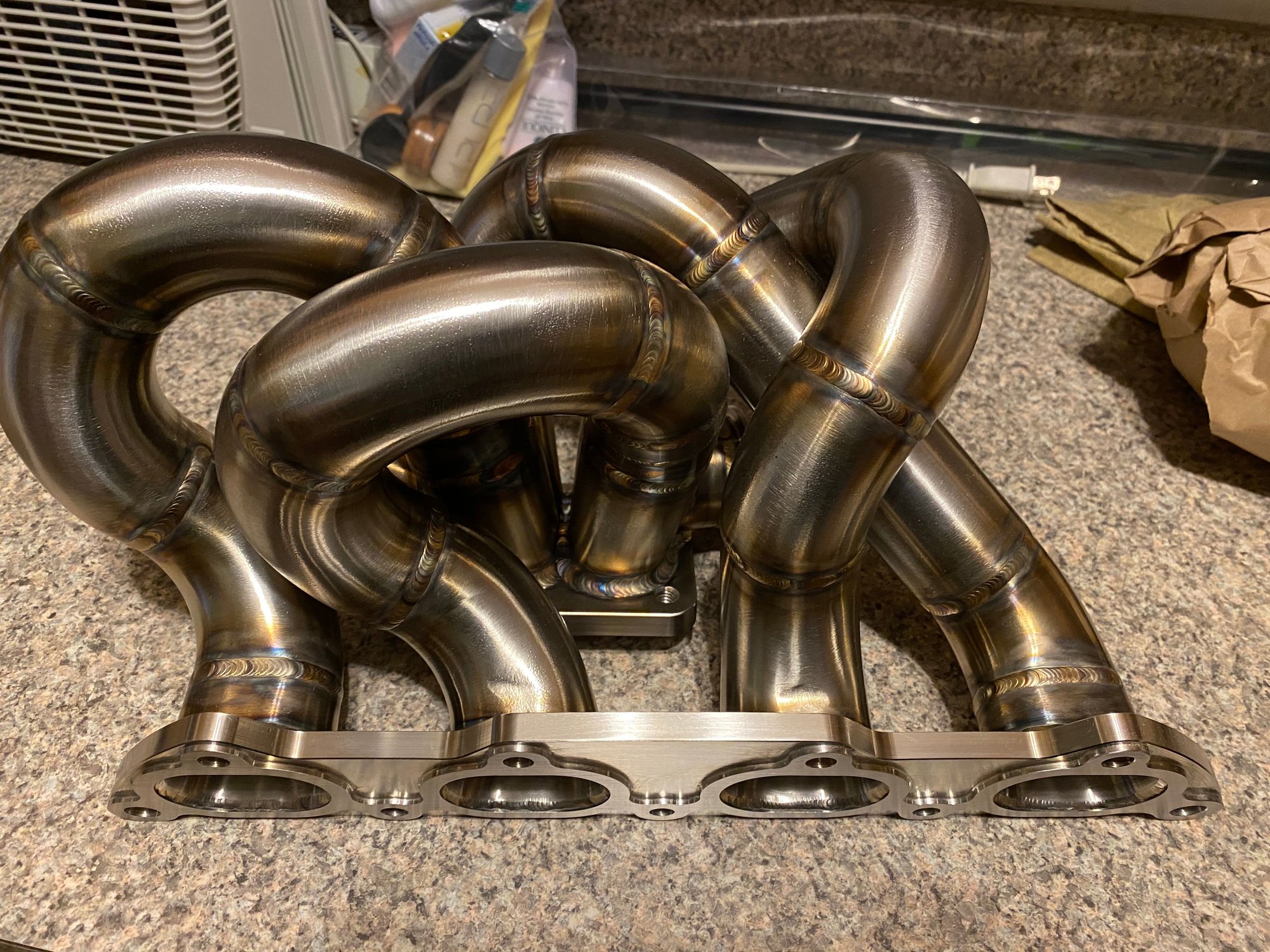

Update:

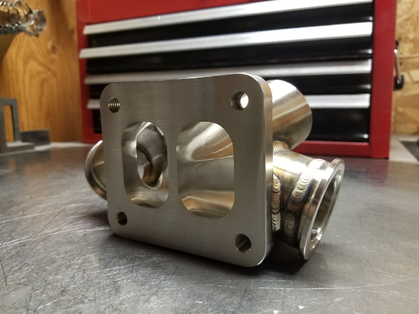

Received the @MorrisonFab T4 hot parts today....Damn this thing is nice!!!! Didn't grab a pic of the O2 Housing/ Downpipe, or Dump tubes....Slowly but surely it's coming along.
