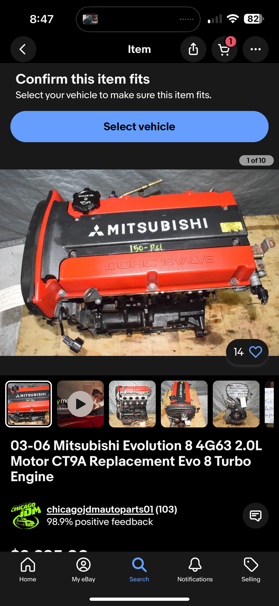

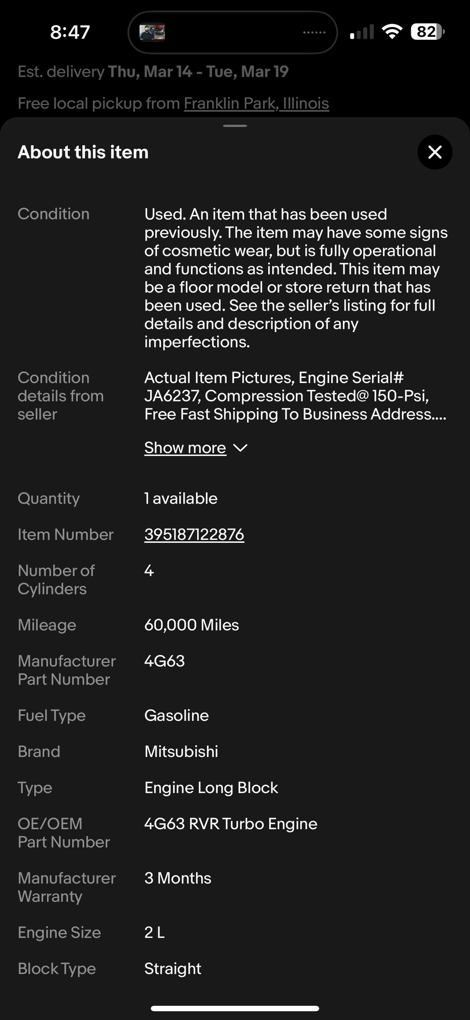

Whats up, I'm new to this 4G63 Platform & I have a few questions on buying a motor off of eBay. So I bought a 2003 evo 8 roller and slowly putting it back together and on a budget aswell. I found a 4G63 Long block on eBay for $2,800 shipped but it came out of a RVR from japan and this is one hella of a steal imo as far as putting a evo back on the road. What do i need to know buying one of these motors? will it work? Educate me! Thanks!
