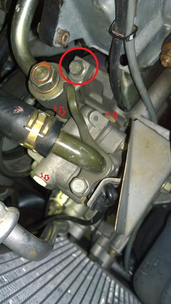

I need the bolt that holds the top of the powersteering pump assembly to the block. See orange circle in picture. I can’t find it on a parts diagram or I would just order a new one.

I cant see the picture but I guarantee I have the bolt at the garage.
anyone else have trouble seeing the jpg I attached?

I see it just fine

did that bolt randomly come off for you?
if you have some hardware laying around, i would just find a bolt that fits and put it in there.
this bolt doesnt hold any of the "Load" that the power steering pump is putting on the bracket.
its all on the 3 large bolts that bolt to the other bracket and the block.
this is a manufacturing thing.... i imagine they use this one bolt to hang the pump on while they line everything up.
thats what i use it for.
I don't know, had the car 4 years and this is the first messed with the power steering and noticed it missing. Could have been missing when I got the car.
