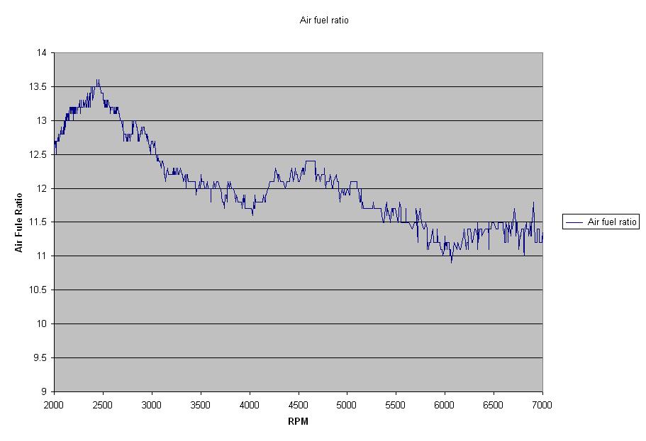

I understand where you are coming from and why you are frustrated. My only thought is in Vishnu's defense. In order to create every map they would have to have a car setup in that stage. This takes time....
I have a 03 stage 0+ and just loaded the map that was just placed on the Vishnu site.
There is also considerably more fuel pulled on this map as well. I logged the AF just out of curiosity and it was fine.
You have asked for an official map. Vishnu has provided it. If you still don't trust it I would recommend installing and logging a run or 2.

They are for V3 cars without SMART. The maps still show up but aren't used by the unit.
BTW that AFR chart looks lean as hell in the lower RPM range....you shouldn't be running 12:1 on pump gas.
SHOPPING FOR A WIDEBAND NOW.

Just a note: I just did that run this morning. It was about 35 degress outside
