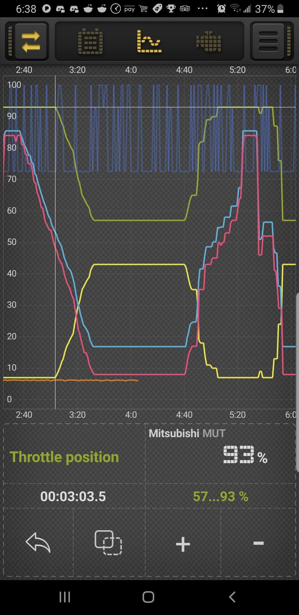

Below is a screenshot of the OBD data.
Mitsubishi MUT :
Green = Throttle Position %
Yellow = Throttle Position Method 2 %
Light Blue = TPS Main mV
Dark Blue = TPS Sub mV
OBD:
Pink = throttle position
Old Dec 29, 2019 | 07:09 PM

Messed around with the car today. Supplied 5V directly to TPS Sub and got the exact response I was looking for, 2.8V-4.6V by pushing the butterfly valve closed and then holding it all the way open, measuring with a DMM right from the sensor. I then unplugged my accelerator position sensor and reconnected the TPS connector, turned the ignition to the ON position and read the values from the OBD reader... TPS still reads noise and the throttle position methods 1&2 have what looks like half range to me...
Does this mean the ECU is to blame?
