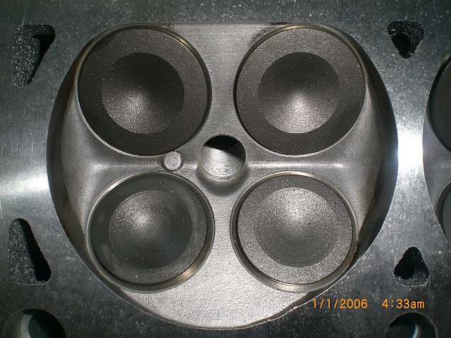

Got the head back yesterday! Like the shop said, noting too major as far as the porting goes... but with a little better flow and the Delta cam hiding inside I should feel a bit on the butt dyno.
Still got a little cleaning up to do around where the gaskets go... Then its on to assembly!
