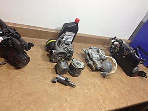

Originally Posted by 03chi-town0Z
I know they're not the same part, but I'm curious if this is actually the case because the castings look the same, but the second set of ports is just not drilled through on the RA pump. I've been wondering if you could just install some generic plugs on the unused ports and rewire the connectors...
It won't fit . You don't have clearance for IX pump and you would need heavy mods to do with no guarantee that motor will run with ecu. I tried this and can tell you from my experience it is most economical to rebuild your existing pump I did many with great results.
