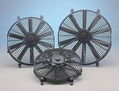

I'm looking to get the Flex-a-lite FLX-112. Will I need to get the termostat control or can I use the ems to configure the fan to come on at a certain temperature?

Yes you can control the fan with the AEM. Are you planning to just remove your factory fan for the slim line unit in the pic?

You can control the fan with a low side output and a relay. IF you removed the stock fan and still have the fan control module, then hook the (+) and (-) from the two wire plug on the module to the (+) and (-) on the slim line unit.

I would guess somewhere around the 10 - 14 inch is what they use, I'll have to measure the one I got with the AMS turbo kit. The flex-a-lite that is mentioned above by bolsen is what most use, and the mounting hardware comes with it. The hardware mounts it so it is thru the core of the radiator, they also have another mounting kit you can buy to mount another way like stock.
