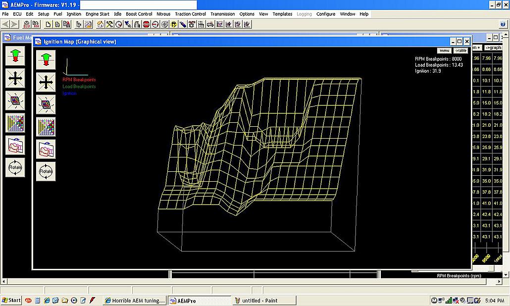

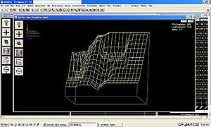

Customer's car melted pistons during dyno tuning. Rebuilt the motor. Brought it to me for tuning. This is what I found The old melt ignition map had 7* - 8* mid range / peak torque and up top had 6* - 7* more

Those look better than the rocky mountains fuel map on page 1. But obviously still way off.
Agreed. The fuel map is bad but not horrible. Cant say the same for the ignition map. Horrible

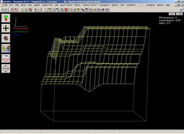

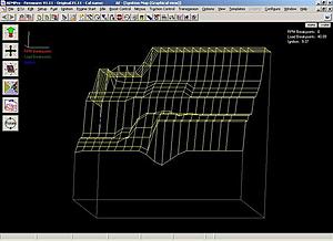

Funny...one of the "tuners" in this thread did this...
That is all

It's hard to read, but...yes, that's 32deg of timing at 14psi...
