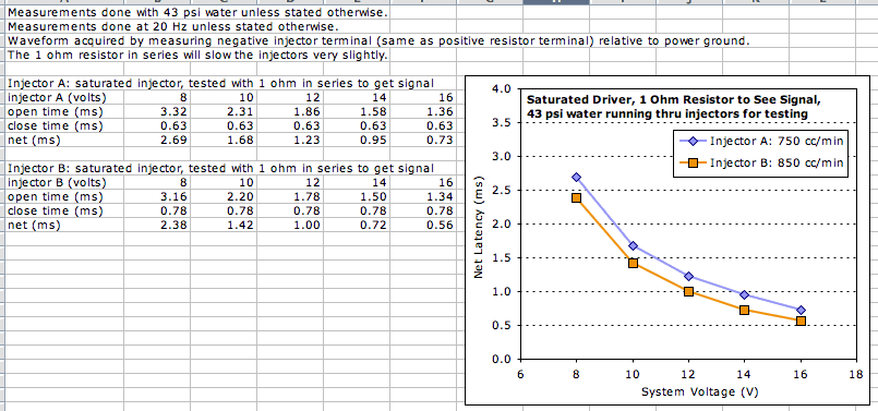

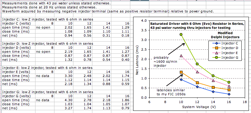

Values are in the pics below. For measurements, I setup a recirculating water loop with a gear driven pump and back pressure regulator. The injectors were powered with an adjustable power supply with ample current capacity. Measurements were done by using an o-scope to observe the waveform across a resistor in series with the injectors. When the circuit is engaged (using an SSR triggered by a waveform generator), the rising voltage across the resistor will have a little kink at the point where the injector begins to move. The story is similar when the circuit is disengaged. I had to use a 1 ohm resistor in series with the saturated injector so I could have a signal to observe, but 1 ohm is much less than than the resistance generated by the saturated injectors when they are engaged, so it has a neglible effect on available power to open the injector being tested.
Thanks for the thoughts on the spray pattern. I may be tempted to try these on my Evo.
Bosch injectors
Delphi injectors
Attached Thumbnails Peak & Hold Injector Driver recommendations....-bosch-saturated-injector-latency.gif   Peak & Hold Injector Driver recommendations....-delphi-p-h-injector-latency.gif

Good stuff, you've obviously got a pretty good understanding of things.
The main thing we've found is that testing the dead time with a scope doesn't give you actual data. It's better than nothing, but it stems on assuming full fuel flow happens as soon as the injector opens and stops as soon as the injector stops. Actual data can only be observed when measuring fuel flow from the injector. Even if you had actually done it by testing flow, the specific gravity and viscosity of water is very different from gasoline so your data would be skewed from that.
Kudos to your testing though, you've taken things MUCH further than most!

Yeah, I didn't have access to any fluids with the same density and viscosity as gasoline. You are correct about the values from the benchtop testing not matching the values needed to dial in the fuel trims, but it was pretty close, and I was able to establish a sensible latency vs voltage curve shape from the bench testing.

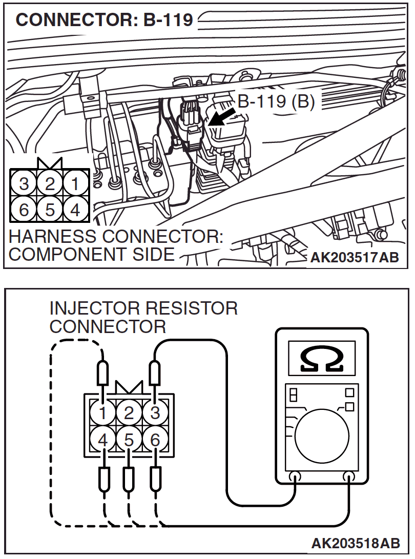

I'm definitely interested in giving these injectors a try, but it won't be for a few months. Looks like a well thought-out package with nice adapters for the length and the electrical connection. Does your package include either some adapter to shunt the resistor pack on the firewall or instructions on how to cleanly shunt it?

No, don't have a solution for the resistor pack that's plug and play. I have no idea what it looks like on the EVO. Anybody got a pic of one and the connector? If I can get a mating connector then maybe I can do something. If not, whack it off and tie all the wires together like it should be.

Here's a jiffy pic from the FSM. Now that I look at it, it should be fairly easy to set up some kind of shunt in place of the resistor pack. Maybe you or Injector Dynamics can come up with a plug'n'play solution eventually.
Attached Thumbnails Peak & Hold Injector Driver recommendations....-evo-injector-resistor-pack.gif

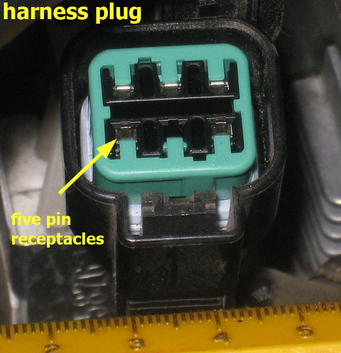

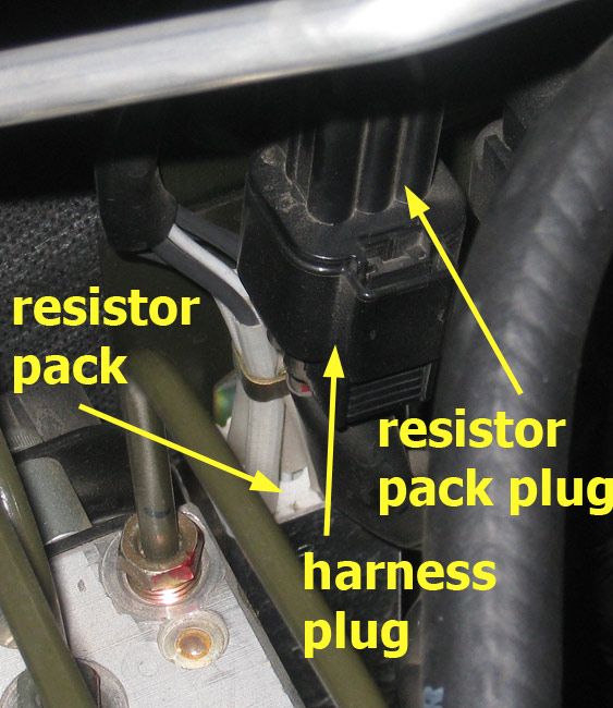

Here's a few pics. The first one shows the exterior of the plug that's needed, and the other pics shows the plug attached to the wiring harness. The scale is centimeters. It looks like it would be easy enough to cut and solder the wires going to the resistor pack, but I would rather not do it.
Attached Thumbnails Peak & Hold Injector Driver recommendations....-img_4195_m2.jpg   Peak & Hold Injector Driver recommendations....-img_4201_m2.jpg

Take a resistor pack from a turbo DSM, any generation, and cut the plug off. Solder all 5 wires together and it plugs into the evo harness. I took the resistor pack plug off a 90 AWD talon and put it on my 06 Evo. $20 at a local junkyard or local DSM owner. I have about 4 I could buy right now, most are spoken for as they are going to friends of mine.
