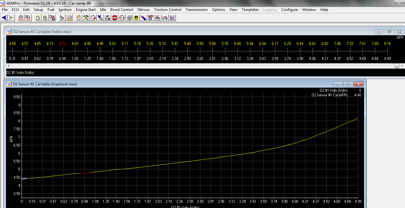

Ok so I went thru the O2 sensor wizard and I'm getting a weird calibration for the standard )2 Sensors (example I posted the AEM UEGO)
My guess is it thinks I'm using Ethanol, is there a place to change this in the EMS software?
Attached Thumbnails Fuel type Gas/ Ethanol-o2-sensor.png

I was trying to ask if there is a place you can select the fuel type your using gas. eth. meth.
I didn't see that option in the setups or anywhere.
I think my old map is set for E85 based on the cal and target AFR's

Found it it's under configure units AFR change to gas.
