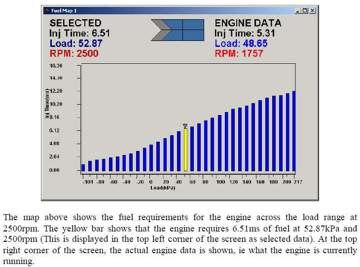

128 equals 14.7AFR on the chart. 94= 19.4 AFR and 255=7.4 AFR. Its far more accurate to have the table it decimal values from 0-255 but like MJ said, it confused the HECK out of people so they made a formula so it more closely reflects AFR values.
Basically, all the AFR value really is, is the injectors pulse width size. We are just increasing or decreasing this value.
There is actually a set of 2D maps which each map represents ONE RPM value from the fuel maps RPM axis (lets say 3000RPM) and the other axis is the Engine load. On this chart should be what the actual injector pulse width settings are for each load value on the chart. Sadly, no one has found these yet though.
Attached is an example of this kind of map.
