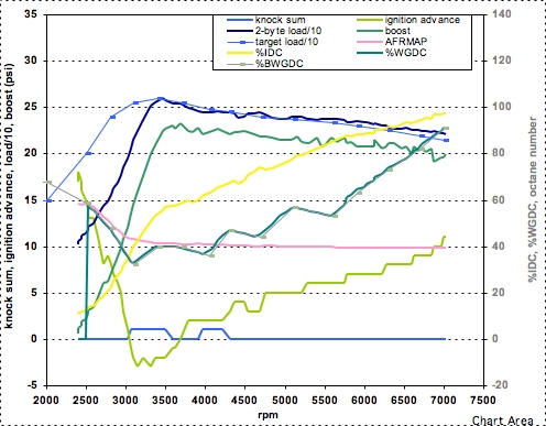

Originally Posted by mrfred
Here's an example showing where the changes are made, and towards the end of the run where no further changes are made, the WGDC curve just follows along the BWGDC curve at an offset of 10.
Do you have any idea why there seems to be an offset of 10% as shown here? After you pointed me in the right direction today, I began to tune the BWGDC values and noticed that I nearly always have a 10% offset (as shown here) and it doesn't seem to be dependent on the error correction values.
Another thing, my error correction doesn't seem to be working. I'm overshooing target load in 3rd but am logging no correction at all in the WGDC. So, basically, I'm getting a random +10% deviation and no -xx% correction when I exceed the target load value.
Any thoughts?
Any thoughts?
In that particular tune, I'm pretty sure that I had the target load set to 240 across the rpm range. At about 2600 rpm, the WGDC jumps by about 10% during spool up as the ECU tries to meet the target load of 240. For that tune, I had my maximum "step" correction set to 10%. After the boost peak, the ECU compensates downward. Then the ECU compensates up and down as the actual load bounces above and below the target load. The bouncing isn't due to the corrections that the ECU is applying but rather the way my boost control system behaves as a function of WGDC. See the plot below for yesterday's log and how I've had to set my baseline WGDC. Anyhow, the final 10% increase occurs as the actual load drops into the last trough. After that the ECU makes no further corrections because the actual load starts dropping off, but the target load is still 240.
I've found that how *readily* the ECU compensates upward or downward depends greatly on the values used in the correction table. With some of the tables I tried, the ECU would readily correct upward if the actual load was just slightly below the target load, but then if the actual load exceeded the target load by a greater amount, the ECU would do nothing. I'm still sorting out this behavior. My general approach at the moment is to create a baseline WGDC curve that puts the actual load right onto the target load in 3rd gear runs, and then I am using a very small error correction (+/- 3 maximum) to allow for different gears and different weather.

Originally Posted by razorlab
Boost is looking good now mrfred.
Yeah, looking much better than before. What a funky WGDC curve though. I'm scratching my head on that. We'll have to get back together to work on the tuning again soon. I'd like to look at what nj1266 suggested.
Mrfred, are you currently tuning boost with 0 correction and then planning to add correction after the WGDC is where you want it? I think that's the approach I'm about to take.
I'm doing 0 upward correction, but I do have downward correction enabled. Make sure to check your result in 4th or 5th gear.

Originally Posted by nj1266
I have a question: When you set your BDEL tables do you set them to the exact 2 byte load numbers that you are logging? Or do you set them slightly higher than that?
I set my target load (BDEL + offset) to what I would like to achieve, and then tweak baseline WGDC (with upward correction disabled) until I acheive my target load. If the motor starts consistently knocking before I acheive my target load, then I readjust the target load to a more realistic value and continue with baseline WGDC tweaking.

The error correction tables adjust the WGDC according to the difference of actual load from target load ...
If target load is 250, actual load is 260, error correction would adjust the WGDC the variable % amount (right column) according to the 10% load difference (left column).
I hope that makes sense.

The "Max WGDC" table is poorly named. It should be called "Baseline WGDC" table. When you are cruising, the car is at 0% WGDC (at least that's what EvoScan says), and when you stomp on the gas, the ECU looks at the engine RPM, then goes to the Baseline WGDC table, reads the WGDC number, and applies that value to the BCS. At that point, the ECU then starts comparing the actual load to the target load (BDEL + boost offset) about once every 0.4 seconds. If the actual load matches the target load, then the ECU continues to follow the WGDC value (vs RPM) in the baseline WGDC table. However, if the ECU sees a discrepancy between actual and target load, then it can/will apply a correction to the WGDC. The amount of correction depends on the values in the boost error correction table. The correction is simply to raise or lower the entire Baseline WGDC curve. So after the correction is applied, the ECU follows the raised/lowered curve. It checks again 0.4 seconds later, and if necessary, raises or lowers the curve again. This is why the correction table isn't a function of RPM. The graph shows the behavior well. The blue arrows show when corrections are made, and its apparent that the ECU is simply raising/lowering the baseline WGDC curve.
