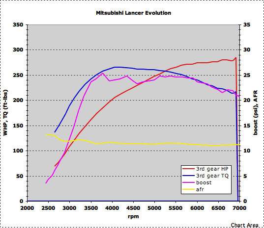

PD: If my calculations are correct, 5 speed users should change their 3rd gear rpm/mph to 87.27 and 4th gear to 66.26; asuming MrFred used his 6-speed to enter the data in the charts. The difference is not that big anyways.
Attached Thumbnails calc HP/TQ from EvoScan using Excel-dyno.gif   calc HP/TQ from EvoScan using Excel-data.gif

Yeah, the HP/TQ calculator is pretty handy for tuning E85 where there isn't much knock. I always use the exact same piece of road for my runs. Yes, the gear ratios very close for 3rd and 4th gear for 2006 5 speed and 6 speed trannys. I think a bit of adjustment may be needed for MY03-05 5 speeds. I'll edit the first post to add an Excel file that includes the gear ratios for most Evos.

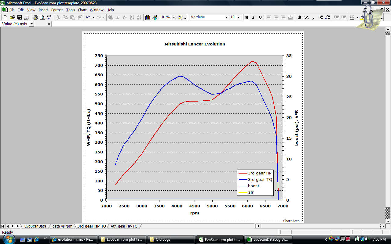

[QUOTE=mrfred;6986036]You were on flat ground with no wind (or minimal wind), correct? Post one of the logs.
heres an old pull. (3rd gear) All my pulls are done in the same place, nice flat surface, w/ minimal wind. I just had a 30* weather change, so my pull from today, was less than desireable.
and heres how it looks for me.
Attached Thumbnails calc HP/TQ from EvoScan using Excel-power-graph1.png

[QUOTE=nonschlont;6986354]
I got reasonable numbers from your log. See pic below. I posted the Excel file too. You'll get a better result too if you log fewer items. I always am for at least 70 lines of data at 100% TPS for a run from 2200 rpm to 7200 rpm. There's no need to calc IPW, but I guess that's being used for the EvoScan HP/TQ calc?

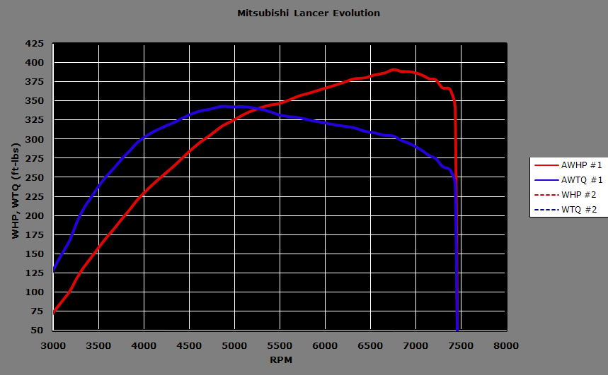

Question, I'm trying to get your graph to resemble the DLL chart cuz I like the layout but I can't seem to get the vertical grid lines to show up on the x-axis for RPM no matter what I do! Anyone know how I can adjust it and make it ACTUALLY have the grid appear??
Attached Thumbnails calc HP/TQ from EvoScan using Excel-bill_vs_jamie.jpg

Go to the "Chart" pulldown menu, select "Chart Options...", then select "x-axis Major Gridlines".

I forgot to mention that I use OpenOffice not Microsoft. I selected the Major grid lines for the x-axis but they only appear on the edge of the graph, not through it. If I highlight the graph, then select "format" on the dropdown list at the top I can select "GRID" but it only has the Y-axis MAJOR GRID highlighted, all other minor and major grids are greyed out so i cant choose them. Its not necessary, I just hate not being able to modify somethng the way I want it to work lol.
NVM: I had to select the "INSERT" dropdown and select "GRIDS" to shoose which axis' i wanted to intersect. Thanks anyways.

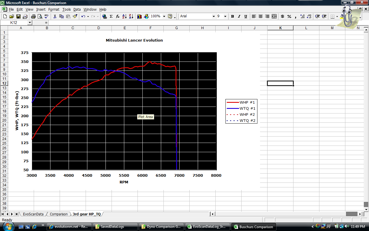

If anyone is interested, I modified this excel file so you can load 2 logs and do A/B comparisons. I also added SAE corrections and a dyno correction factor. A dyno correction factor of 1.02=Buschurs Mustang Dyno, 1.200= Turbotrix Dynojet Dyno.
Its set only for 3rd gear pulls with 5 speeds but I can get the rpm/mph value for any other gear and for the 6 speeds too if you guys need it. I also have the graphing resemble DLL's graph since i like the layout.

Jamie: very cool excell file! Thank You for sharing!
I just tested this one out... Seems to be quite accurate compared to my data logs from evoscan power wise, w/ corrections factor @ 1.200 Also is very close to the dynojet I was on out here. I also checked the output @ 1.02 correction factor, and that seems to be right around where it should be. (I havent been on a mustang dyno) I did notice that the graph is showing peak TQ @ 4000, rather than 3500 in my log though.
Attached Thumbnails calc HP/TQ from EvoScan using Excel-power-graph.png
