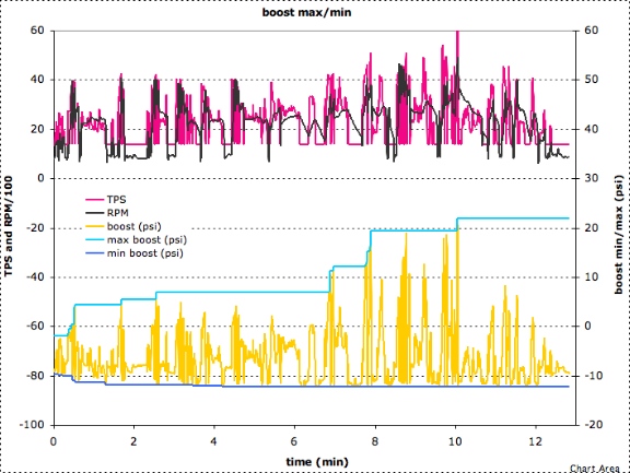

I've been disassembling all the routines in the ROM that read the MAP sensor. Turns out that the routine I most recently disassembled keeps track of the min/max boost levels. With a few simple ROM and EvoScan Data.xml mods, these min/max boost levels can be logged. Not sure its really that useful, but just thought I'd mention it.

I already tried it. It works. I'll see about posting the required mods later tonight.

Nah, it gets erased everytime the car is turned off, and the RAM variable is not one that's tracked in the MUT list. I had to add it to the MUT list.

Yeah, the JDM MAP sensor is needed to track the max value. The USDM MAP sensor can track the min boost though. :-))
