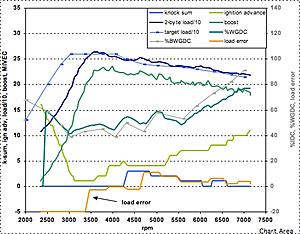

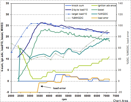

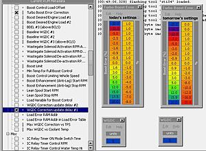

I was able to try out some new settings today:
load variable used: 6B42
update interval: 5 units (about 0.4-0.5 sec)
TBEC: "today's setting" in picture below
Results:
- Note that the maximum load error possible is +/- 20. At the start of the run, the load error sat at -20 for a while, and because of my TBEC settings and update interval, the WGDC got ramped up by about 4%. This worked ok with my BWGDC settings until about 4500 rpm, and then it caused the load to shoot up about 10 past the target load and cause a bit of knock.
- After that, the WGDCC algorithm caught up with the overshoot and lowered the load back down to the target load.
- In the last part of the run, the WGDCC algorithm had to pull the WGDC down to keep the load in-check with the target load.
This is the first time I've seen the boost/load control system provide positive and negative feedback control as expected, so its a step in the right direction. The main problem I see right now is that under low rpm WOT spool up conditions or during part throttle acceleration, the WGDCC can get cranked up quite a bit and can potentially cause significan boost overshoot when going WOT. My near term attempt at preventing this from happening will be to zero-out the top right side of the TBEC table so that when the load error is more negative than -10, the WGDCC will be zero. See the "tomorrow's settings" table.

I found a couple of things today ...
First off, the issue with my loads not matching ... I had no negative correction set for +5 and below, so the TBEC table was allowing my boost to be off by +7.5 before correcting for it. I've added a -.5 correction to the +5 error and it seems to be working correctly. It was just a slight overlook on my part.
Secondly, I've found that the logged WGDCC% value seems to be at a base 64 scale. I simply changed the EvoScan data.xml file to subtract that 64 and the WGDCC% follows the correction to the BWGDC% curve. This was only after one short test. I used the formula "x/2-64."
Old Aug 17, 2007 | 11:10 AM
