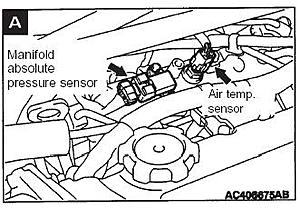

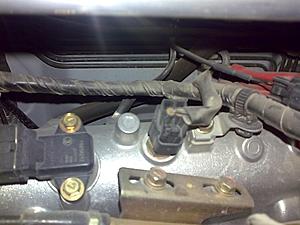

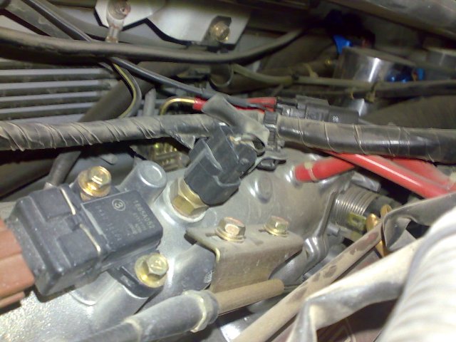

The stock ecu has it but I think it must be changed to be scaled against MAP rather than Baro and then you have air temp compensation also. I don’t know if you guys have any evos with 3bar map sensors and IAT stock .. mine is .. It came with an IAT sensor in the intake manifold and a 3bar map sensor.
If this is true, what is/are the part numbers for the sensors?
Maybe we can see if they can bolt right up/or make a spot for them so that we can have the ability to use the sensors if needed for this speed density conversion.
EDIT: I know the JDM MAP sensor is available to use, I am primarily talking about the AIT sensor.

I will take pictures of it on my way out of work and post it.
Old Oct 9, 2007 | 07:06 AM
  #118
aalzuhair's Avatar
Joined: Oct 2005
Posts: 79
From: Riyadh, SA
here you go guys .. i will try to get you the part number
Attached Thumbnails No MAF? No problem!-09102007027.jpg   No MAF? No problem!-09102007026.jpg
