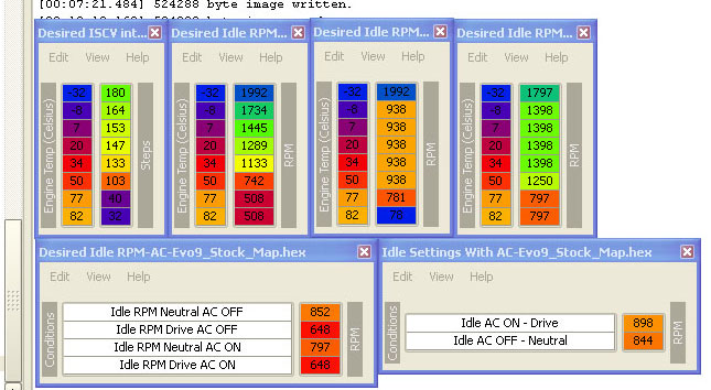

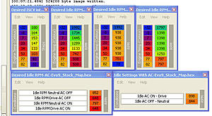

Ok I changed the ISCV with AC on 10 steps across the entire temp range and turned the AC on drive rpm to 953. I posted two jpgs of the stock settings and modified settings so you can see if I did it right. The tables in the pictures reading from left to right, top to bottom. TOP ROW: Desired ISCV intial step position with AC on-Neutral, Desired Idle RPM-Neutral, Desired Idle RPM-Drive, Desired Idle RPM; BOTTOM ROW: Desired Idle RPM-AC, Idle Settings With AC. I am going for a test drive now to see if it is fixed.
Attached Thumbnails Stalling with AC on issue-iscv-ac-stock.jpg   Stalling with AC on issue-iscv-ac-modified.jpg

That 82C/78rpm in 3rd chart in the first pic may of caused a problem

The settings that were changed seemed to help the issue but did not get rid of it. I have changed the rpm settings before to about 1200 rpm and the problem was still there. The 938 rpm ac off and 953 rpm ac on seems to be good settings for the idle, but the problem was still there. I think the (ISCV ac-on) settings that I bump up 10 steps accross the entire temp range seem to be the helping factor. I am going to play around with those now and see where it goes. I am going to bump it up another 10. Does anyone know what exactly those settings do and effect? Thanks.
