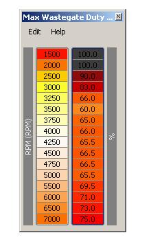

Originally Posted by MR Turco
Can people who are running a GM 3-port BCS post up their BEC and BWGDC tables. I am looking to see how people with the 3-port are setting them up.
I use a GM 3-port. Don't know if I should add what I have because i'm not using direct boost control, I'm on load-based. But here is my current WGDC table and the boost curve it produces (this error correction off).
Attached Thumbnails how-to: ECU-based direct boost control-currentmwgdc.jpg   how-to: ECU-based direct boost control-boostprofile.jpg
