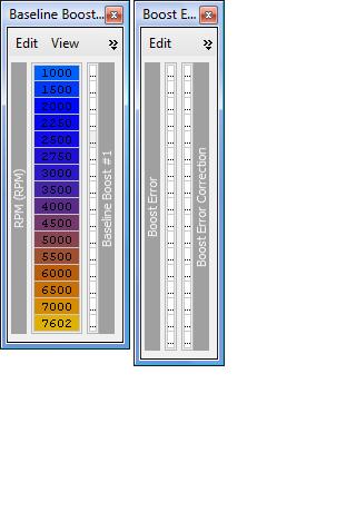

I need some help,
I recently got tuned with the this boost control, but when I pull my rom I see the tables like this. I'm using ecuflash 1.35. Can anyone help me out? Thanks
Attached Thumbnails how-to: ECU-based direct boost control-ecuflash1.jpg

Jamie - is this 94170015, apparently that might have a bug in regards to boost.. I need to check it out... :|
