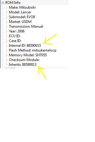

Well I checked it and I don't think that's it. I checked the scalings in ecuflash and I don't see one for "offsetwgdc" or "boosterrorpsi" like it states in the .xml file. Does this work for the 88590013 rom? When I load the rom in ecuflash it says it inherits from 88590013?
Attached Thumbnails how-to: ECU-based direct boost control-romid.jpg
Old Sep 29, 2008 | 09:36 PM
What ROM are you running?
You have a 88590015 rom
Old Sep 29, 2008 | 10:00 PM
  #429
Kings Fan's Avatar
Joined: Jan 2006
Posts: 530
From: Sacramento
When I first bought my car it was 13. But I think Bryan flashed it to 15??
